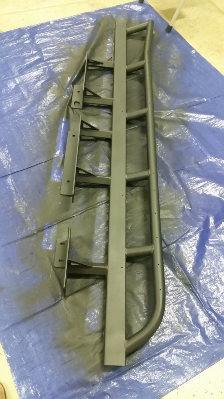

    On to the fun stuff. I did not spend the excessive money on getting my rails powder coated. I personally believe that is a waste of money for something you are going to hammer on. Neh! SHOULD hammer on. If you bought a set of rock rails to be a pavement princess, please leave this post. Kidding! a little bit... So first, we are going to teach you a new skill! Because learning is fun! Instead of spending your money on powder coating, keep it in your wallet. You are going to have to make a few stops around town, but heck, come on, it's always fun to take your rig out and drive around. First stop is at Harbor Freight. Get your self one of their mid grade gravity feed paint guns! They cost something like $30 bucks. Then you are off to Home Depot or some other place you can but a compressor. But you certainly don't need to do that, because you already have one. You can pick one up large enough to do the job for something like $150 with a hose and nail guns. You also need a respirator and a full body paint condom. Then you are going to go home and get on Amazon and buy some Rustoleum Marine Grade Paint and Metal Primer. Wait two days and it will arrive. Now set up a paint tent in your garage and teach your self how to paint. There are countless youtube videos and things you can read, so I will not waste my time explaining it. Obviously you are not going to get AMAZING results, but they will turn out just great for rock rails and you will have gained a new skill and some useful tools. You are now more american than you were last week. I also went and bought some herculiner and did my steps in it. Turned out great! 3 coats and let that stuff dry for 3 days, you are golden. I also put a garbage ton of flex seal on the inside of the mounting plates. I saw a couple people complain about rust so to create a buffer of metal to metal I put that on.

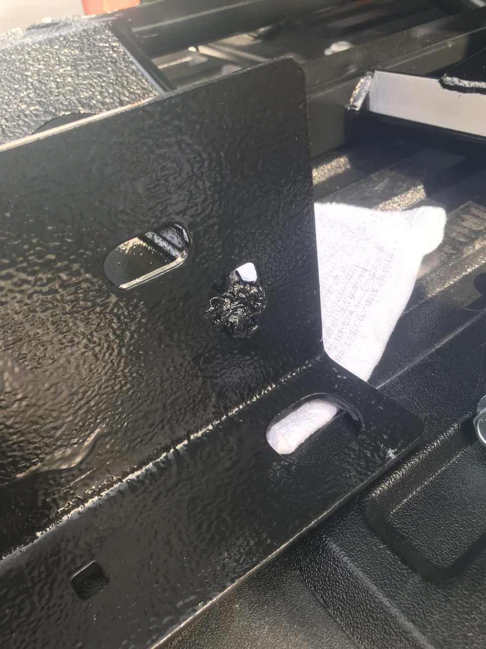

    First you are going to take the bear shit and cover the hole on the back side of the mounting plate that has the horizontal square tube welded to it. Fill the hell out of it so you don't get water in there and rust. (See pictures)

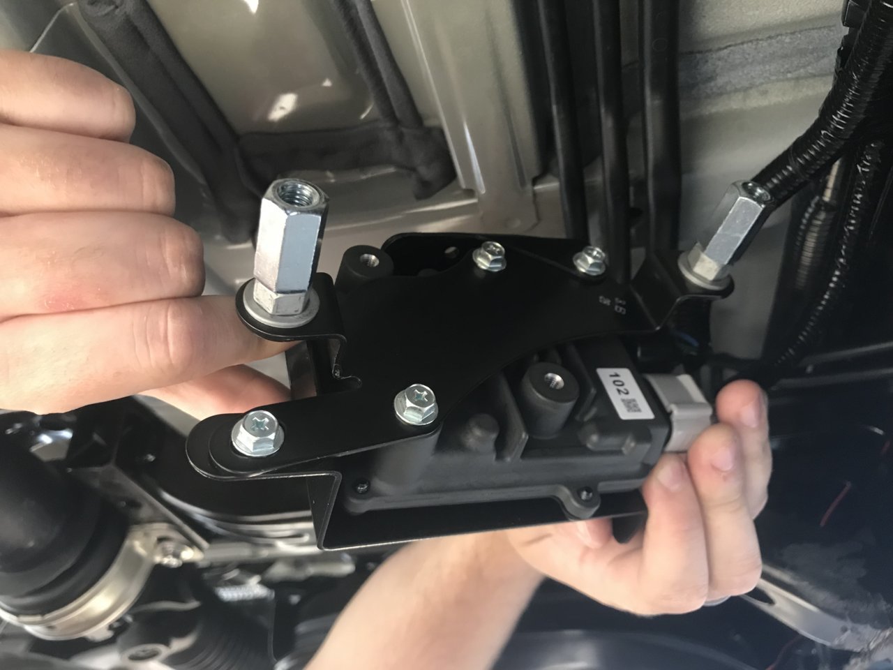

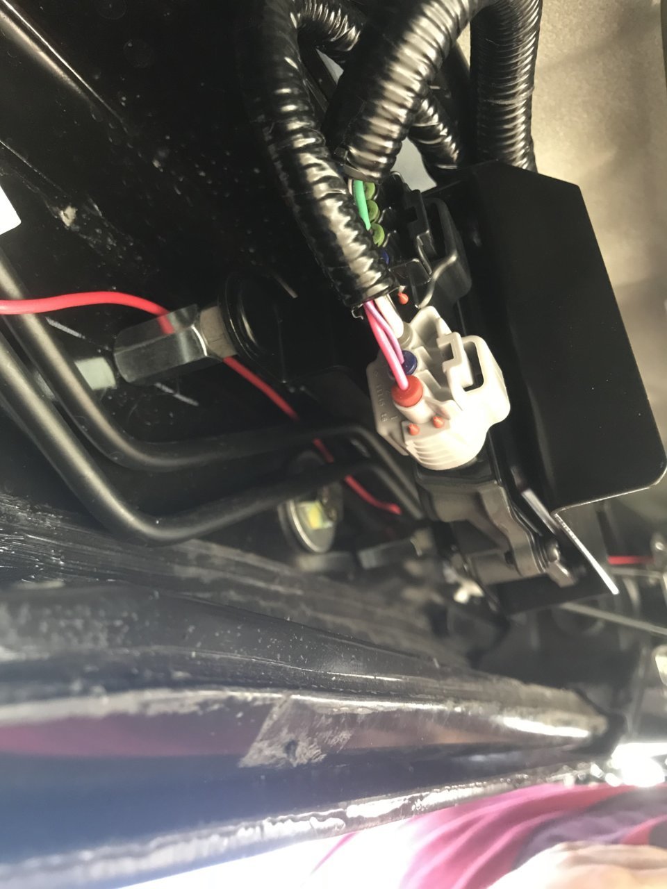

    Next item is the electrical box on the inside of the frame rail. The hole that used to be the to left of it is now right behind it. You are going to want to drill from the frame rail side through the mounting bracket. Use your new 1.5" bolt through there. Use your stock nuts and sleeve nuts on the studs of the box. Bolt it back on with the new bolts you bought from the out side. This sets the box of far enough to clear the bolt and nut. (See pictures)

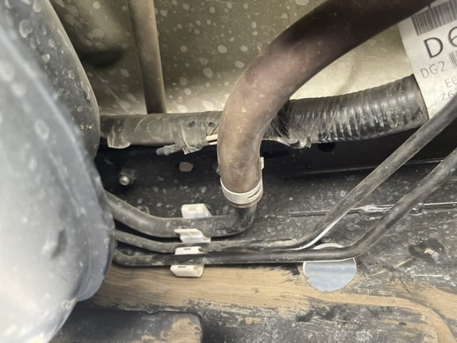

    You are going to want to cover your break lines that are touching the nuts/bolts on the driver side with the 1/4" Fuel line and tape. Since you are an offroader and things get bumpy, you don't want to rub a nice hole in your lines. (See Pictures)

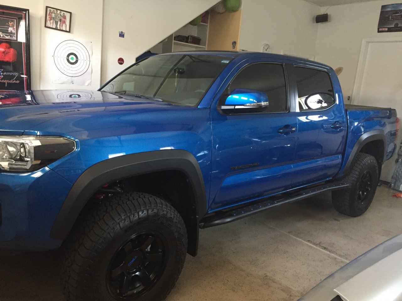

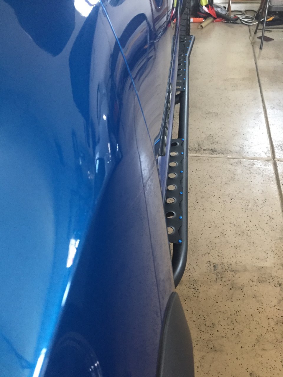

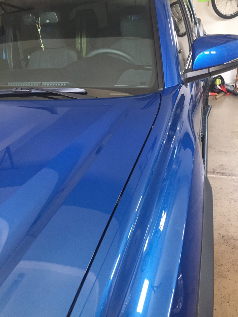

    Finally got mine installed.
    22410E55-0306-424C-B373-E0CA96BBB459.jpg 57FCC137-0636-4D9F-8938-3F14BBB45BBE.jpg 7641F71E-0F01-4ECF-A8C4-0CB3C5DE5A3D.jpg

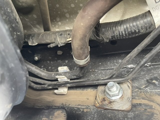

    Mocking up for an install and having trouble feeling like my brake line will be clear of the bolt. If I wrap it and have it contacting the bolt will it be sufficient or am i looking for trouble? thx 20198B1B60EE-CE6B-47A4-8ED8-E47F55F6369D.jpg
