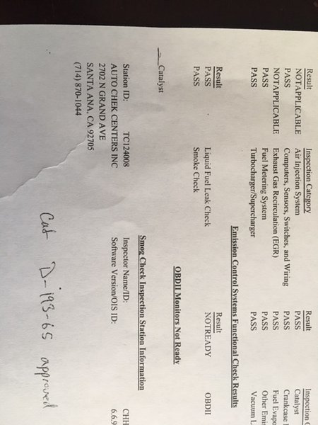

    I believe I am having the exact same problems. Had the truck checked out and everything looks fine. Was told to make a run to San Diego to try to clear it up. I just went down there a couple months ago so I assume it should have cleared up. I have noticed that my gas mileage sucks right now and averages 12 MPG. I would like to find a local mechanic that can help me out. Let me know what route you go because I'm sure we have the same issues. Feel free to contact me.
  17. Aug 4, 2016 at 12:15 PM
    #17
    Pauhana
    Pauhana Well-Known Member
    May 2, 2012
    #78087
    158
    Mark
    Irvine, CA
    04 SC PreRunner
    RECARO Trend Seats TRD SC URD Fuel Upgrades
    Here's a copy of my smog check. It says the catalyst for my OBDII monitor is not ready.
    It also says it's due to the fact that the vehicle's on board computer system has not completed the emission system's self-checks.
