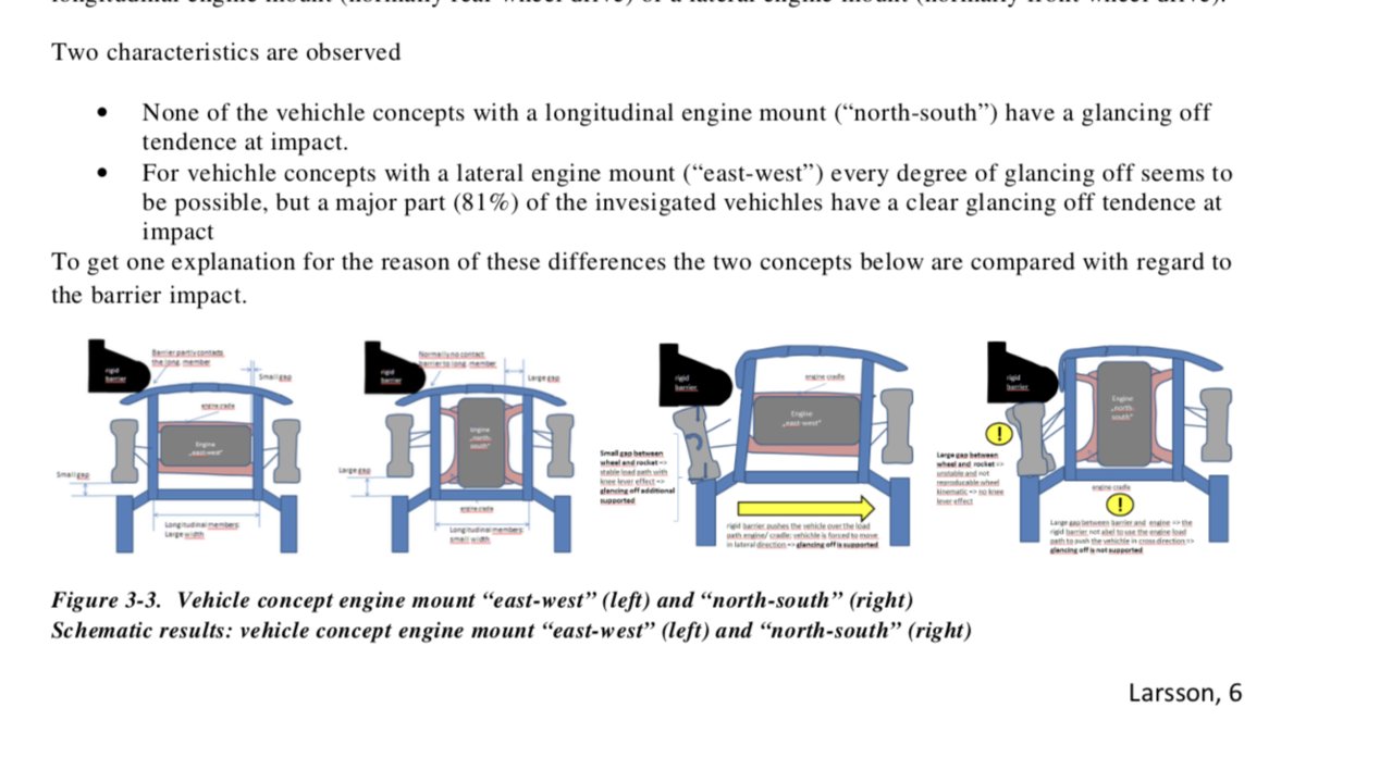

    The article below is full of mis-translated words (rocket instead of rocker etc) but maybe explains why Toyota puts the cab mount as close to the wheel as it does (screwing all the guys wanting 33”s). The smaller the gap between the cab mount and the wheel, the more likely the vehicle will be deflected away from the impact “glancing off”, which decreases the chance of serious injury. A large gap behind the wheel is not desirable. Not that a 1/2” taken off to CMC is likely a huge factor, but at least there is rationale to the Toyota design (if I am understanding what is written correctly).
    https://www-esv.nhtsa.dot.gov/proceedings/24/files/24ESV-000244.PDF

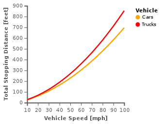

    If you want to drive safe anyways, slow the fuck down. Check out the curve for braking distance vs speed. It's not linear, the faster you go, the more space you need for braking by a substantial factor. This can be misleading, and easily result in accidents. https://en.wikipedia.org/wiki/Braking_distance#Total_stopping_distance
    If you want to experiment with this, go on an empty highway and stand on the brakes at 65. Now do the same at 85. It takes almost twice the distance and time to stop.
