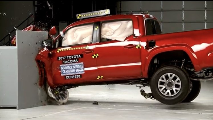

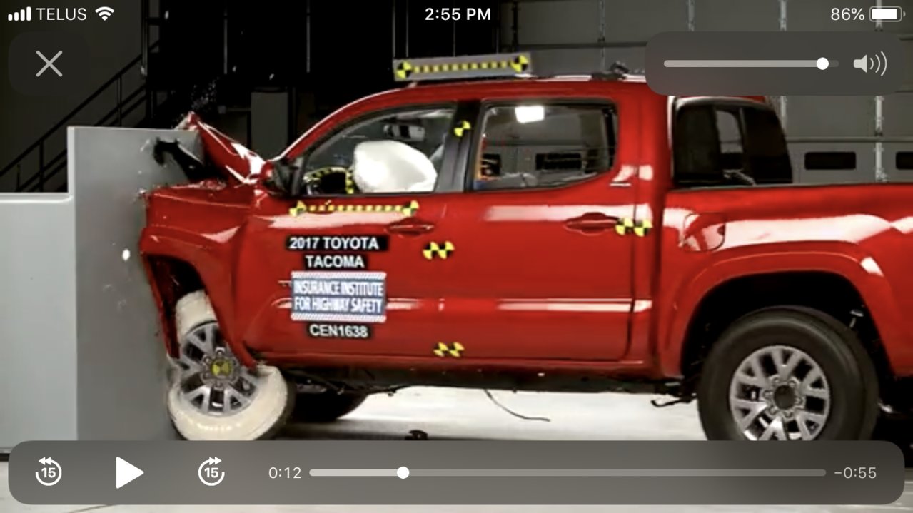

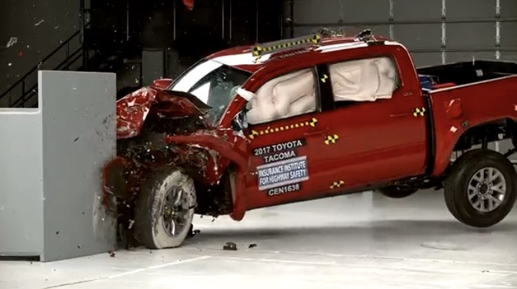

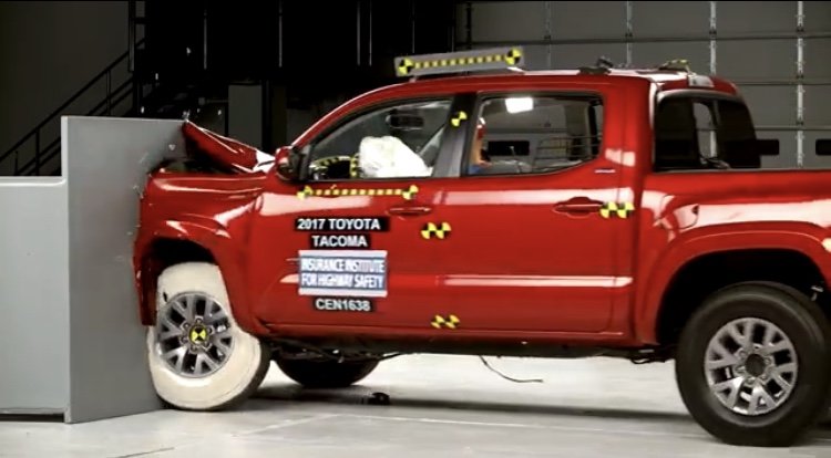

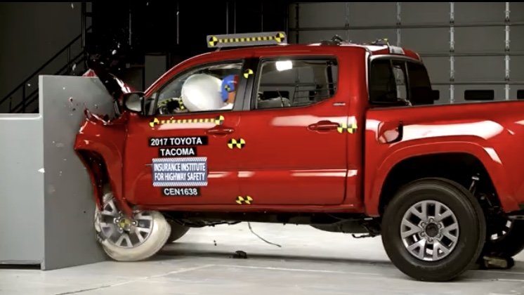

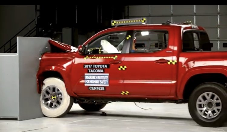

    Just randomly landed on this thread & want to offer a quick opinion. I really don't see a problem with CMC's, unless you are seriously worried about that very specific crash as shown on the video. That seems like the only type of crash that a cab mount would --- hypothetically --- be of help.
    If you're driving over 50-60 mph & God forbid, you hit a metal post, you're going to need more than the cab mount to save you.

    I also have been a mechanical engineer for almost 30 years and, you are wrong on many points of your post.
    Let's get a few facts straight to start with:
    The cab mounts are UHSS with around 1480 MPa strength. You should know that you cannot patch or splice or section anything safely over 440MPa. It just won't work.
    In addition, the cab mounts are designed to deflect the front unsprung mass downward in the event of a very specific crash, and that is the small frontal offset crash. That is really the only type of crash that could cause the wheel or brake rotor to encroach into the cab space. Are you honestly going to tell me that scabbing a 3/16 piece of cold rolled steel is going to do the job that the original formed mount is doing?
    Stating your opinion is one thing. As an engineer, stating your opinion as fact (like you did) is a sure fire way to lose all credibility.
    If you are going so fast that you send the wheels and tires towards the cabin in a full frontal crash, I concur, you have other problems that make cab mounts inconsequential.
    By the way, the 2016+ Tacoma has several parts to the frame and cab pillars, all different strengths that all require different methods of repair/replace. This information is freely available. Google it.
    Bottom line, I will never ride a family member around in a vehicle that has had a safety feature modified by some jackleg with a torch in a driveway. Chances are good I will never be in an accident where this feature is needed, but we both had probability and statistics right?
