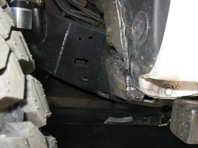

    Depends on a lot of variables that will be specific to your truck. If it rubs when you drive, your options are to not turn as sharp or chop the mounts.

    Well, I had to chop my cab mounts to clear my 33" tires with the LT setup. Mine are an inch wider, but still.
    You can sacrifice caster and camber and shift the LCA forward to help with clearance. Generally speaking you'll only really rub when turning tight. Say hello to 3-point turns, but the truck will look pretty sweet. :)

    With the 305's I had to go with a full smooth chop and I still have to keep the LCAs shifted way forward to avoid contact.
    But like you said, it wouldn't be as much of an issue strictly on-road. I ran 33's on an F150 I had years ago and dealt with rubbing before hitting full lock. You get used to it and adjust your driving accordingly.

    Just do the friggin' cab mount. You WILL have to trim with 295's. Most guys with 285's have to trim. I have had my cab mount done because of a slight rub with the 285's. If you didn't know, you wouldn't even be able to notice it. Cut, plate, weld, paint. You will save yourself from a lot of headaches by just cutting it.

    I have 305/70/16's on 3" of lift and I don't hit the body mount and I have no need to chop it and I have taken it offroad once so far with the 33's and sill haven't touched the mount.
    It depends on many factors as to needing to chop it or not.

    ok so check this out. My caster before i got my alignment was 4.1 and 4.2 and I never had a problem with rubbing the cab mount. After my UCAs with the extra caster built in and a proper alignment it went down to 2.2 driver and 2.6 passanger. I cant make U turns and on the drivers side because my caster is so low. So I think i found the answer
