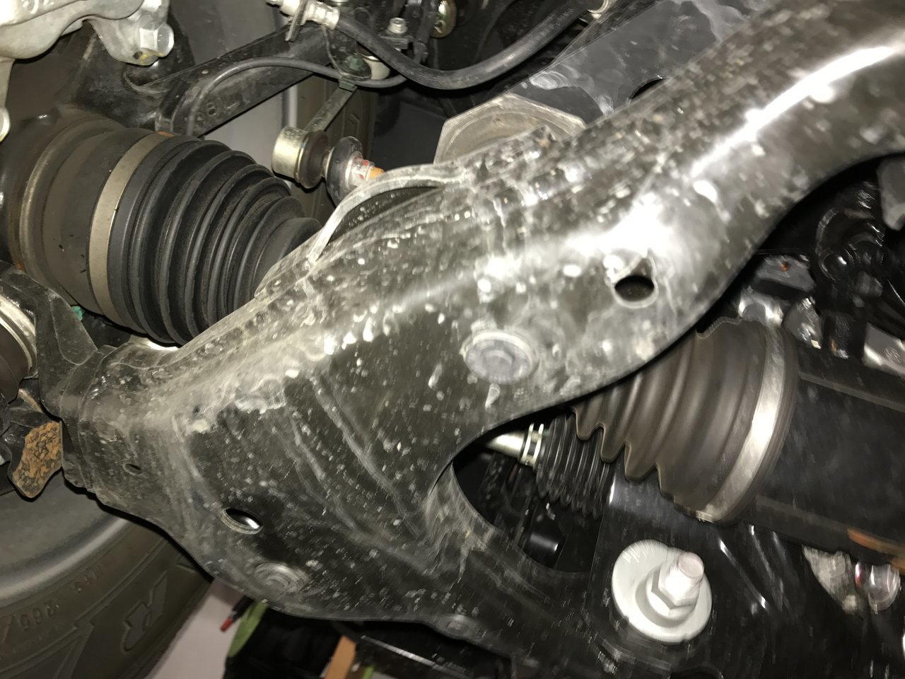

    The dealer put plugs in the frame holes. No more noise. They said there was a service notice on this issue. I believe it was 4 Holes in the frame causing the noise. This was fixed almost a year ago. Bo nouse since.

    Any idea where the holes are they plugged? I would love to see that and do it, the noise is a pain. Thx

    There are two rubber plugs on each side. I think lower control arms. Im no mechanic, but i crawled under and thats the only plugs i saw. Strange that it would cause such a noise. Guess air swirling through. Hope that helps.

    Here's a picture that may help you locate the area.

    Thx man. Big help. I had already done that mod myself based on info from this forum re a Toyota TSB. Glad this helped your noise issues. Cheers

    There's a TSB for hollowing noise in front that usually starts approximately 40 mph. Both lower control arms have holes that require plugs. Also, a friend had his 2016 Tacoma to the dealer and they replaced the front cab insulators bushings that secure the cab to chassis to stop chatter coming from front.

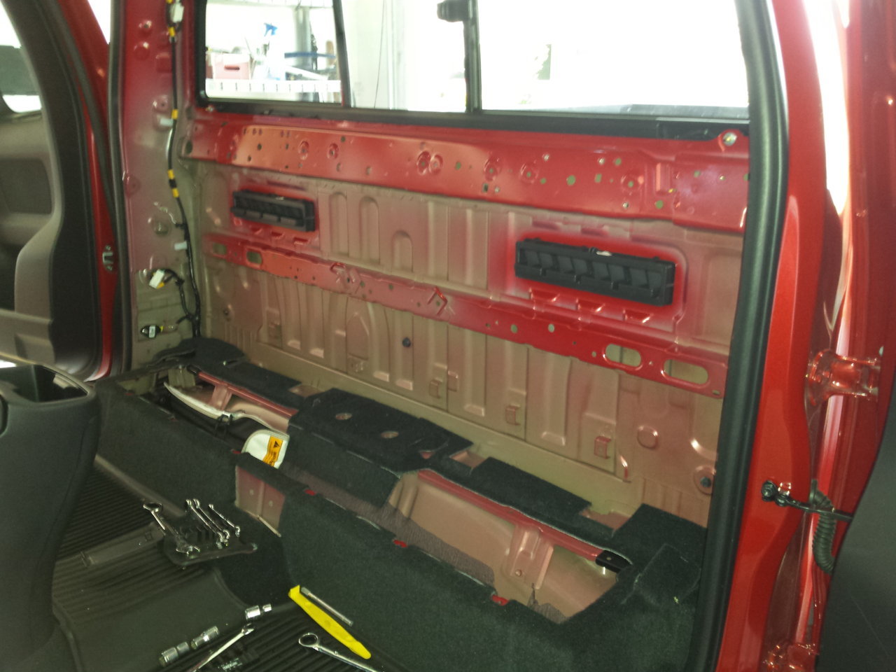

    2018 Access Cab: swapping out my rear seats with another TW member. I'm going to copy what Over 60 did, but I'm going to use Boom Mat Spray. I'm also going to cut some foam filter media and stick it in the vent holes. I'll include pictures

    Here’s what I did on mine. Helped reduce road noise.

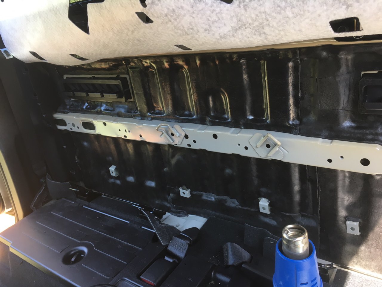

    I came from a Wrangler so I thought the Taco was very quiet comparatively, but I thought it could be better so I put sound deadening everywhere I could in the cab which meant taking the entire interior out including the headliner. Now it's as quiet as my GF's GX460, and the stock (JBL) sound system sounds better too.
    It was a huge PITA, and I would probably pay someone if I were going to do it again, but now that it's over it's totally worth it.
