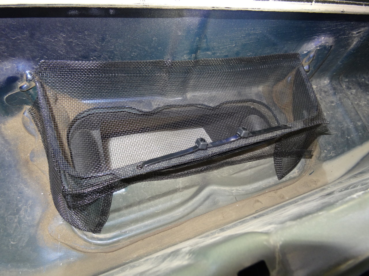

    I did this yesterday. I went to Lowe's and spent $6 and that included additional zip ties I didn't use. I followed your write up except I used 2 zip ties only. I also painted mine hammertone silver. Thanks a bunch!

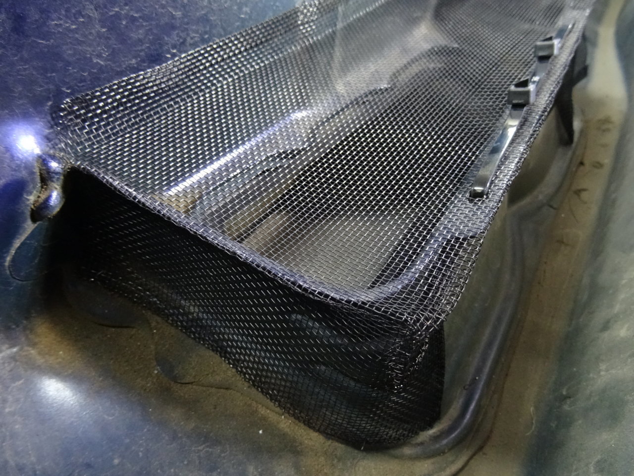

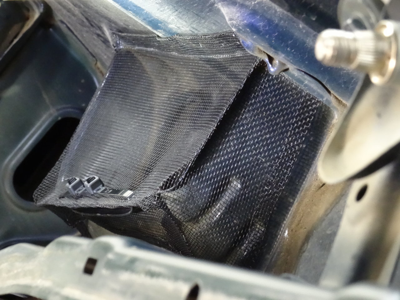

    DSC01205.jpg DSC01206.jpg DSC01208.jpg I bent up a piece of metal window screen to keep the crap out of my cabin intake last year.

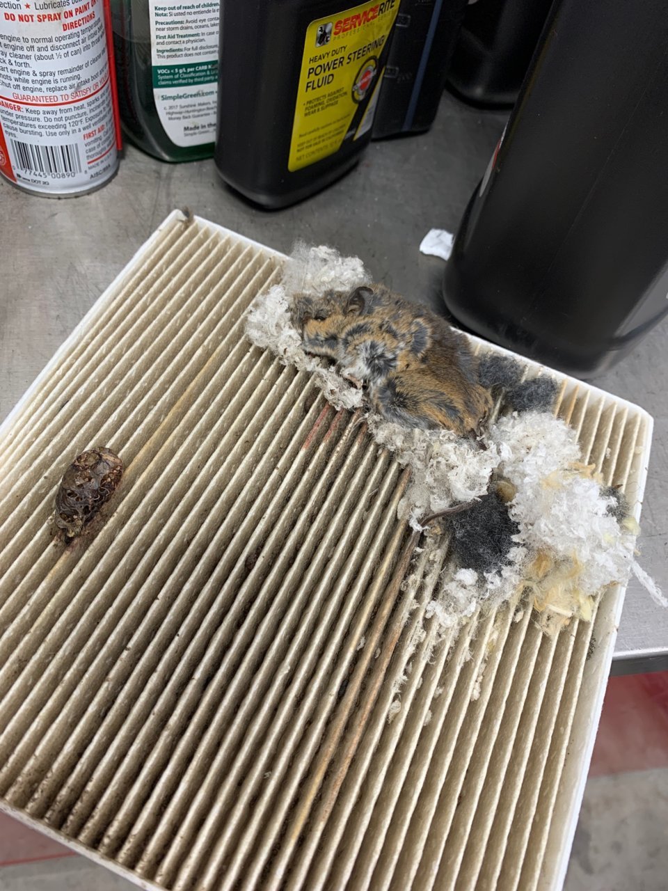

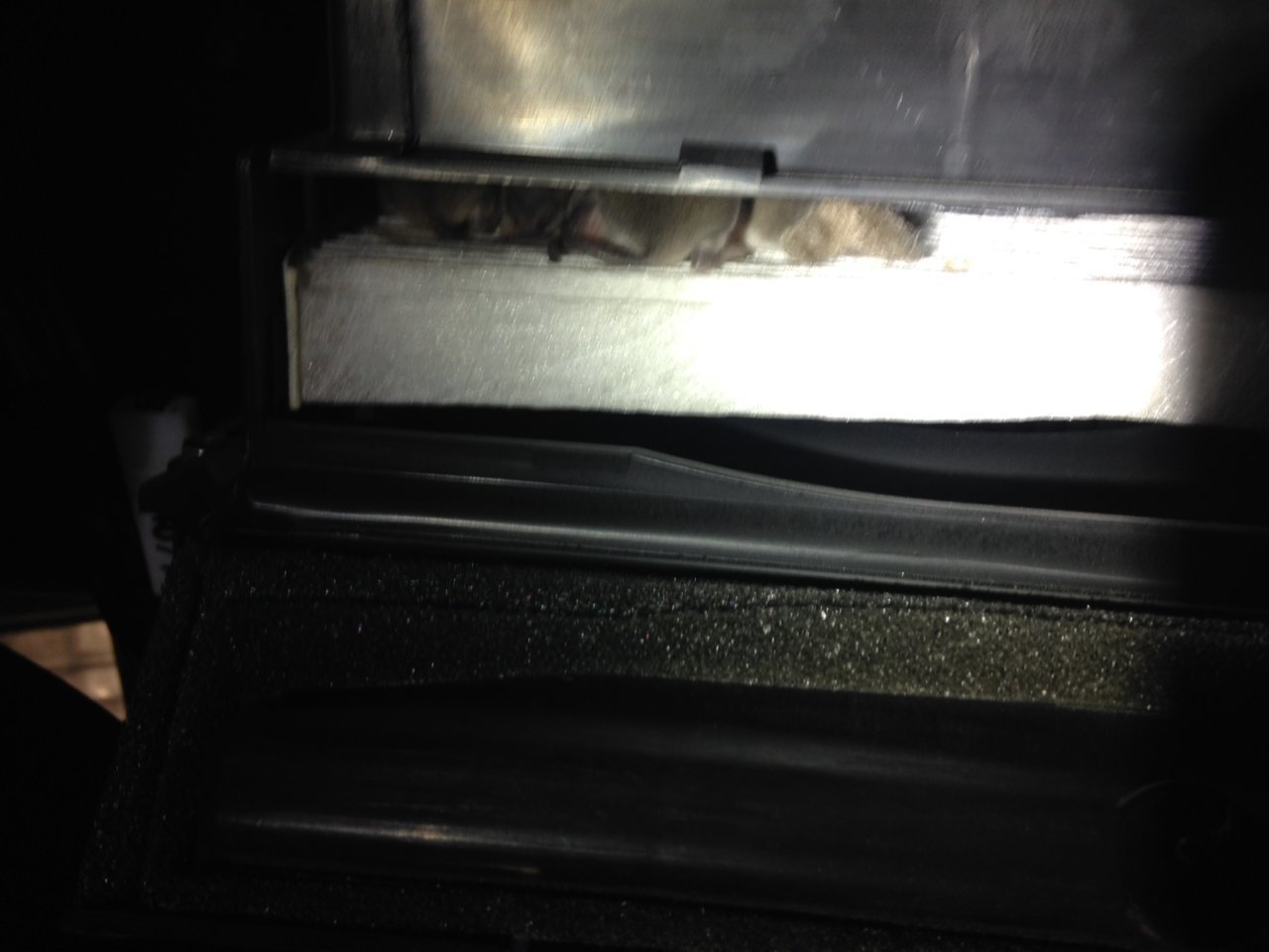

    Because you haven't seen something like this in your cabin air filter yet...

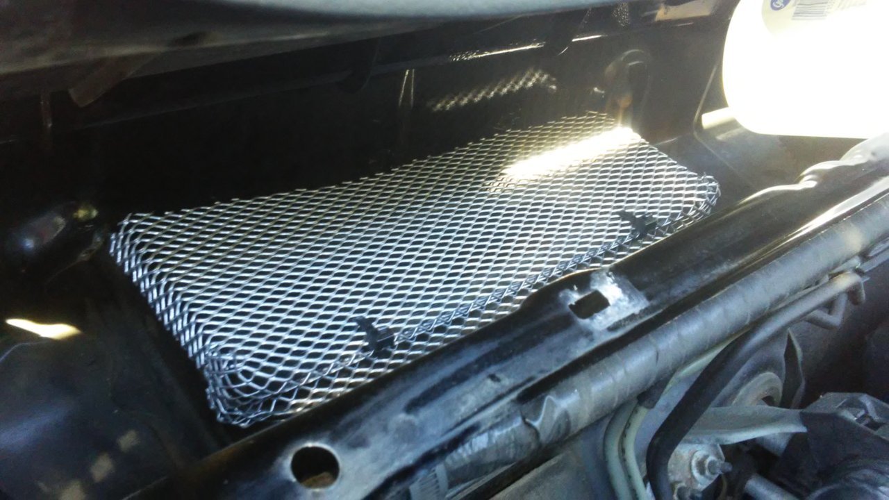

    No, no I haven't, fortunately. No bats in my garage but have seen them early in the morning in garage at work.
    Went with aluminum screen and secured it with the existing bolt holes and some gray RTV where screen touches the firewall. Also made a lid of sorts that I cut from flexible plastic that wedges in the area over the opening at an angle where air can enter thru screen and even if something does leak past cowl it will not drip right into cabin air opening. Turned out great.
