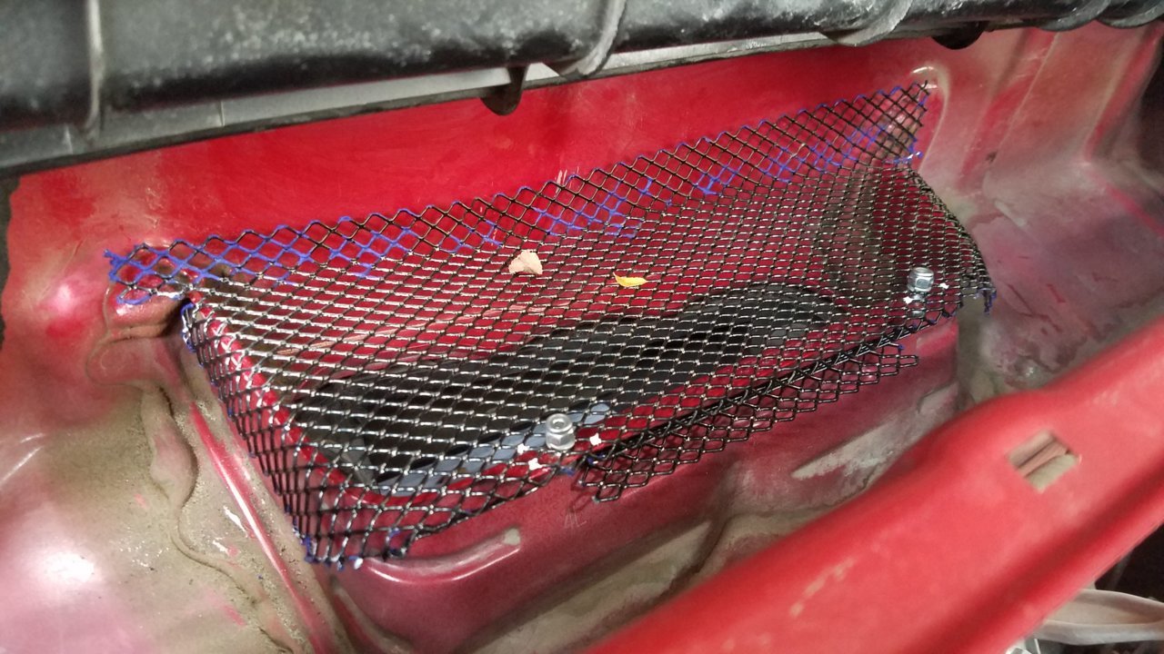

    Great info! Didn’t know I had a problem until baby mouse dropped onto passenger side floor mat. My 2019 has slightly different cowl but opened up the same. Used a piece of 1/4” hardware cloth to cover opening. Thanks for posting such useful info!
