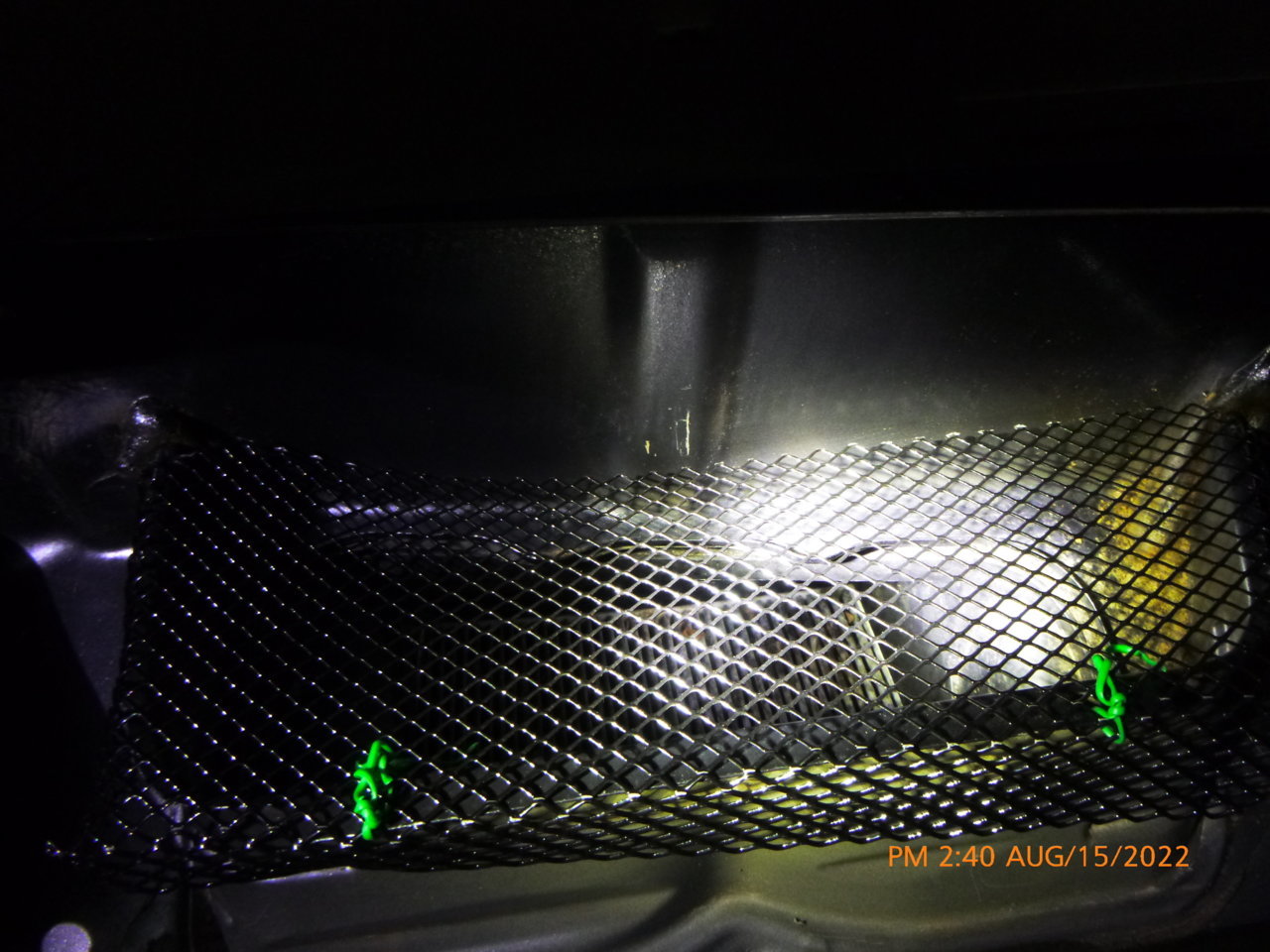

    Found a huge nest atop my cabin air filter including acorn shells.
    gutter screen works great as OP suggested:

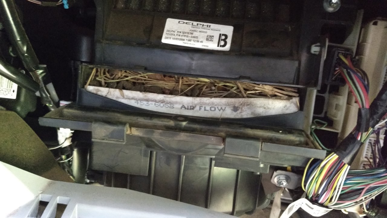

    I had an issue with rats hanging out in the engine compartment, managed to trap and dispose of them and vacuumed up their turds. Kept smelling them inside the truck though and the airflow seemed a little weak so I figured the cabin filter had captured their smell and was due for a replacement anyway.. This is what I found-
    This great discussion showed me how to access the air intake so I could scoop and vacuum out the debris and crap and not have it fall into the blower housing when I pulled out the filter!

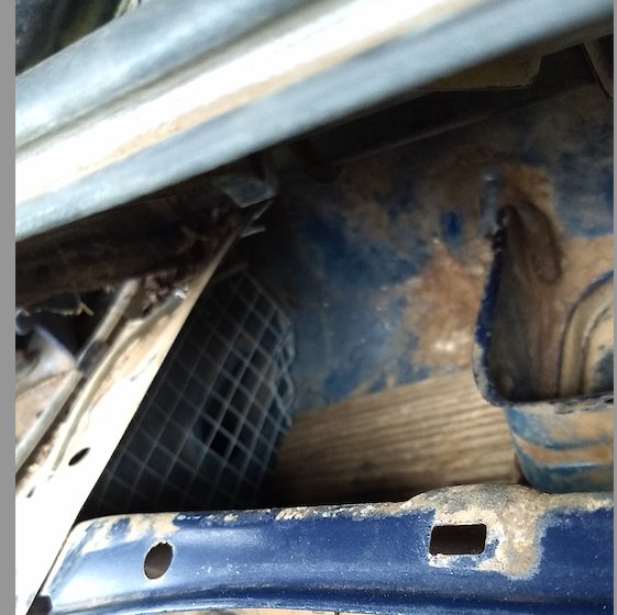

    But how did the rats get in there was the next question, all I could figure was they were coming up thru the truck body and out the holes to the left of the air intake. So I wedged a piece of hardware cloth in that area to cover the holes, the ones on the driver side have the wiper mechanism in the way so I’m hoping to find where they enter the body lower on that side and block it there…haven’t figured that out yet. IMG_20230724_112456692.jpg
