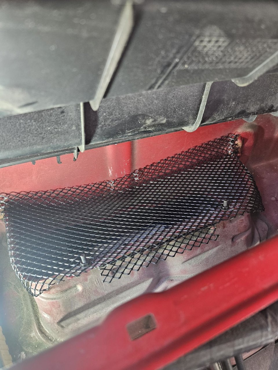

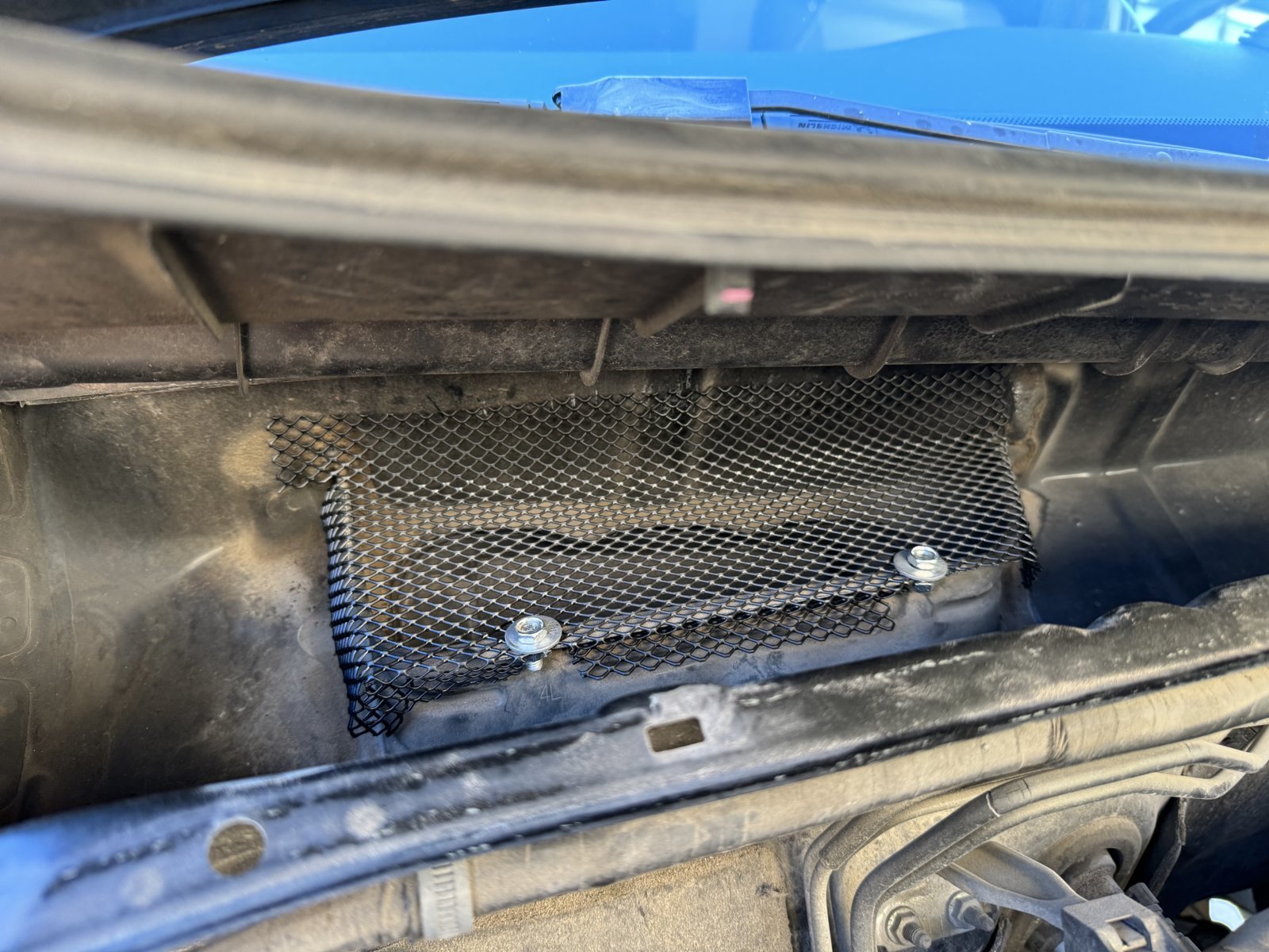

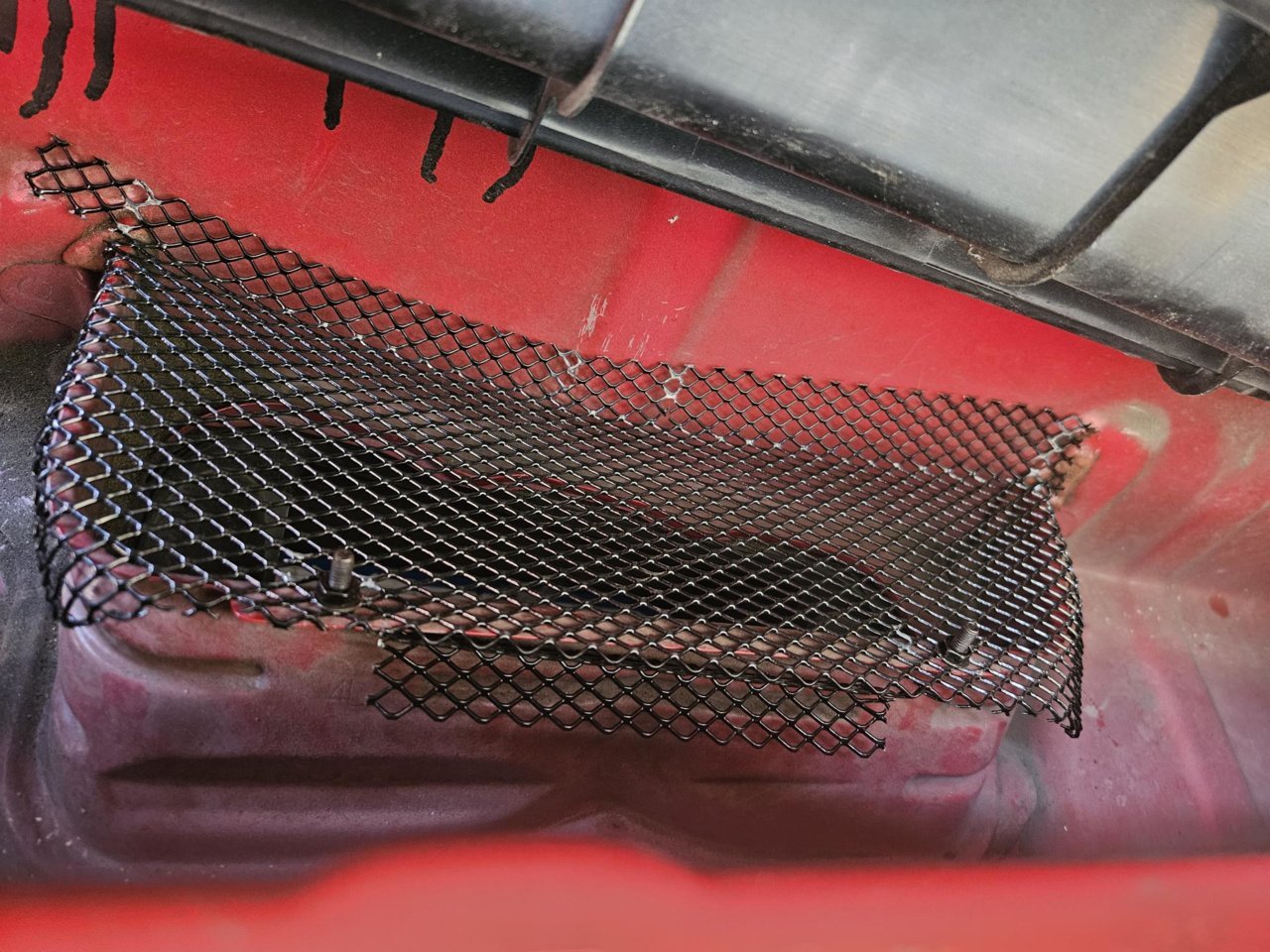

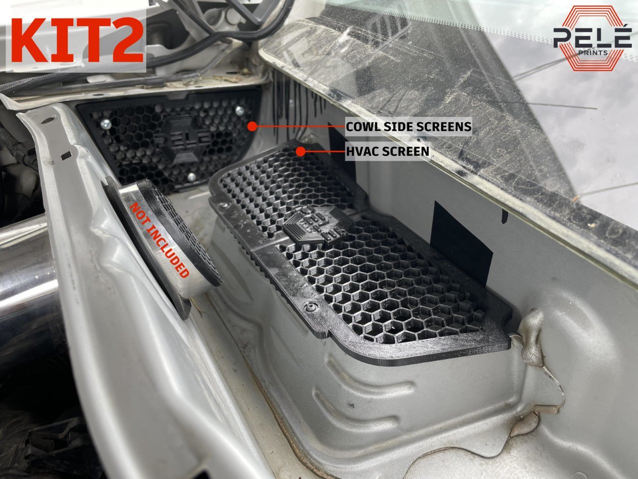

    Hey everyone!
    I'm thrilled to announce that my Cowl Intake kits and 3D printed HVAC covers are finally available for purchase!
    It's been a crazy few months getting everything ready, with some setbacks along the way. My 3D printer broke, but I quickly purchased a second one to make up for lost time.
    I'm still working on building up my stock, so there might be some longer lead times than I'd hoped for. But don't worry, I'm doing everything I can to get your orders out ASAP!
    I want to extend a HUGE thank you to all the amazing folks who showed interest in these products early on. Thanks for your support and patience. Check out my thread HERE or message me to place your orders. Get ready for some awesome products, even if there's a bit of a wait.

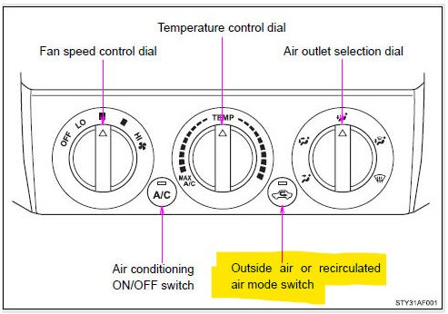

    Anybody knows how to clean the mesh when air circulation is on? Mine is a little dirty but I don’t know how to clean it. Like the one in this quote

    From inside the glove box. That is how you change it.
    https://youtu.be/9363_oFuoTg?si=Clcx55npwROJjG4e

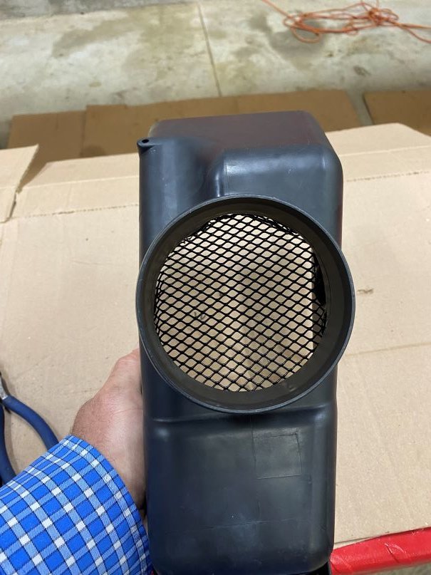

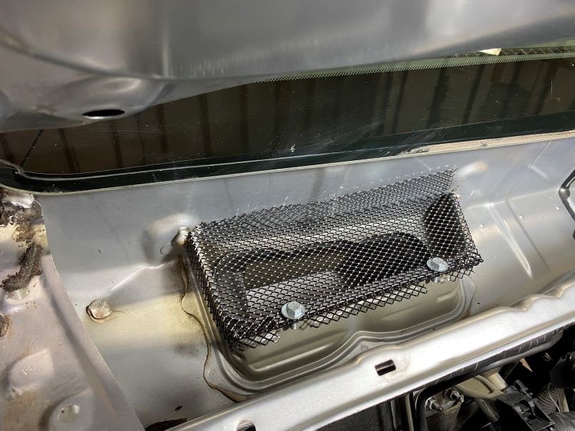

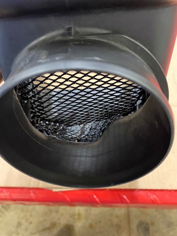

    Big thanks to BlackBeerd for the How-To. We did this tonight on my son's truck.
    My son used the left over screen to make one for the engine air intake. He did a real good job.
    He cut it a little long and folded under to fill the low swag in the bottom of the pic.

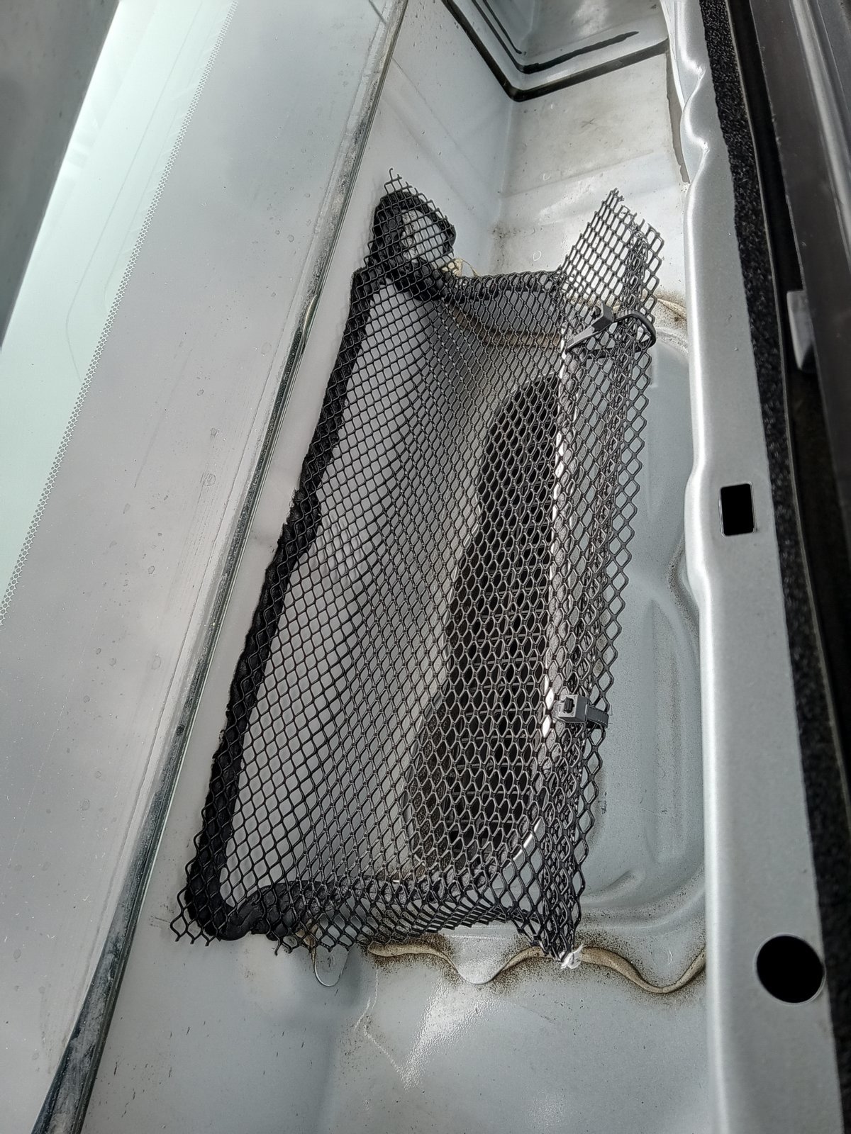

    IMG_20240105_175648027.jpgThank you for the thorough instructions. I know this post is about 5 years old, but I'm excited to not smell mice stench or pull out live baby mice out anymore. Next project is engine filter.

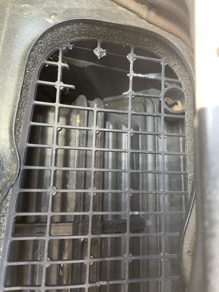

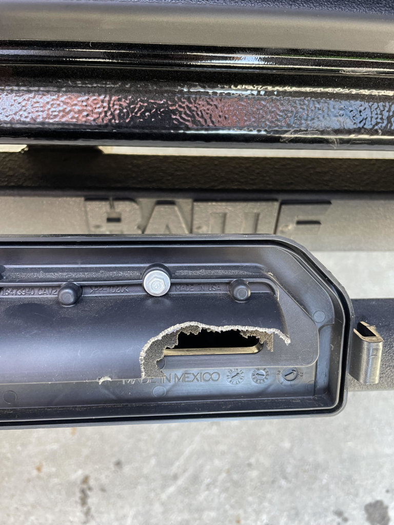

    Thanks @BlackBeerd for this write up. I became an unfortunate member of this club recently. I wish I would of kept the original K&N cabin air filter that I replaced a month or so ago before doing this mod to show that they even chewed a small hole through the very thin metal mesh of the K&N filter. I also didn't take after photos of my install because it was hot and I was ready to go inside. I did however take these photos of the damage to the "grate" that Toyota put in the 3rd gens and how easily the mice chewed through it, as well as the access panel with the two clips you squeeze in the glove box to replace the filter. All is well now. I used 1/4 inch hardware cloth and painted it black for the rust factor, although I do believe it is galvanized. I also covered the two side holes near the fenders using JB Weld Steel Stick which worked amazing since there were no real attachment points for the side holes. It's a two part putty that when massaged together makes a malleable putty that hardens fairly quickly. It stuck to the painted surface great and I just pressed the hardware cloth into it and it was solid after about 10 minutes. It's not coming off.
