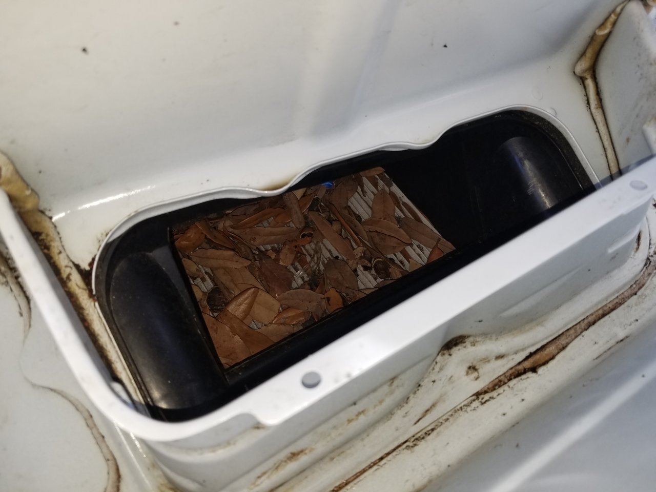

    So you'd rather have this (and more) in your evap case, and eventually clogging your drain?
    (Shot from under the cowl area where your 'fresh air' enters, looking down into the case. Filter is first line of defense)
    Yea, I didn't really understand the whole filter thing either, thinking like you related to what it was for.
    But it's actually a good idea that's simple to service.
