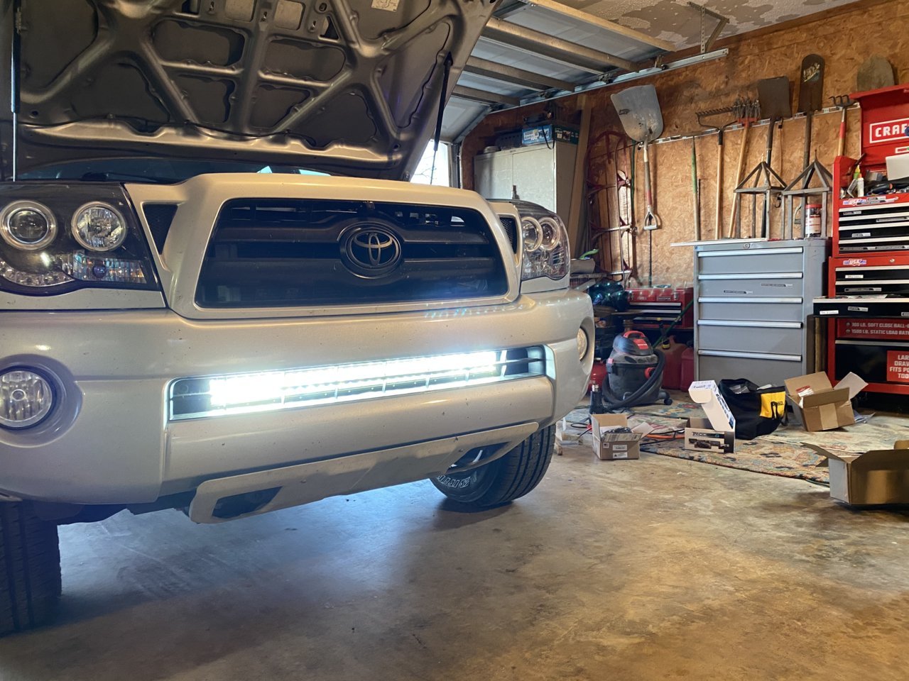

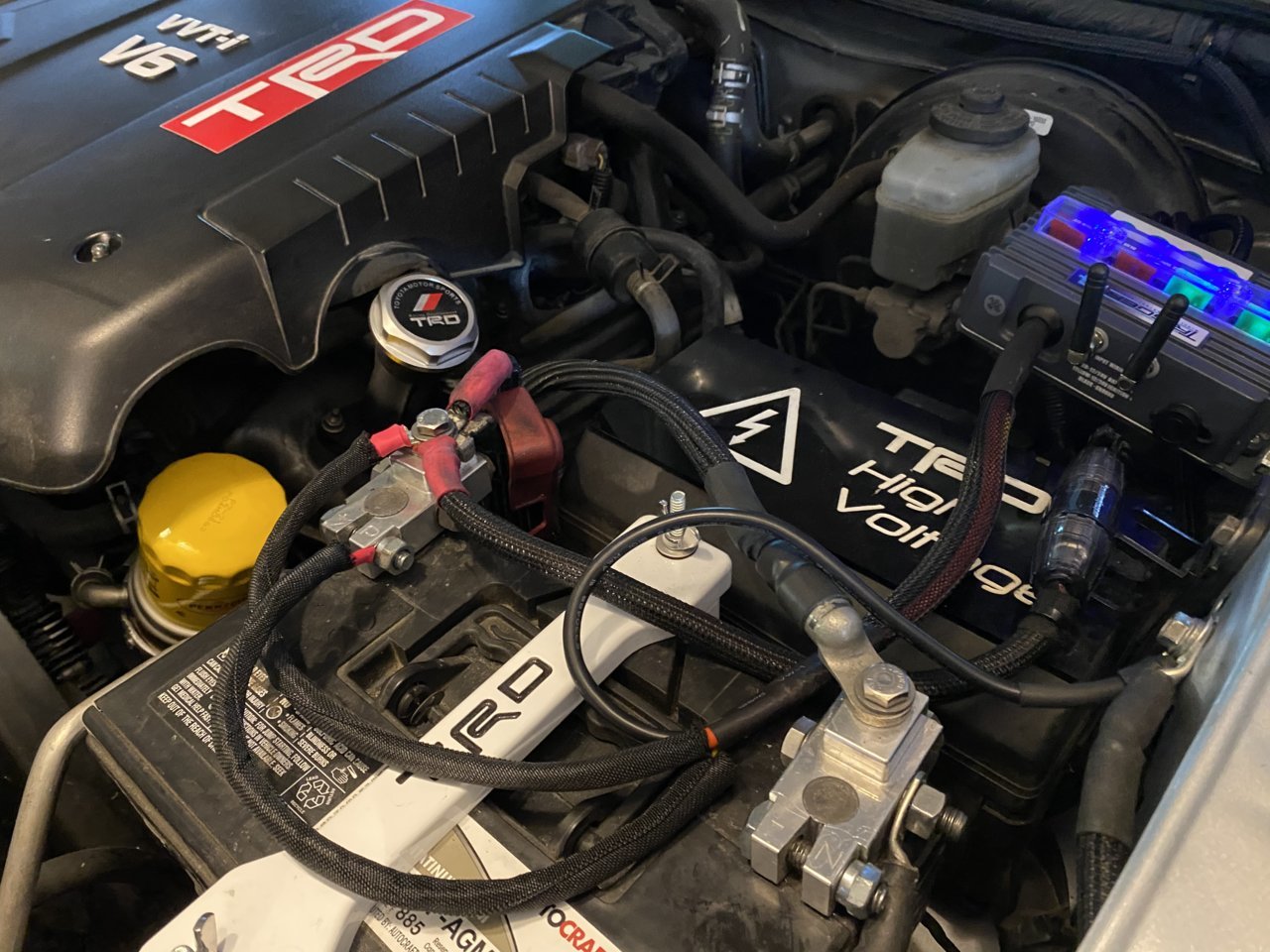

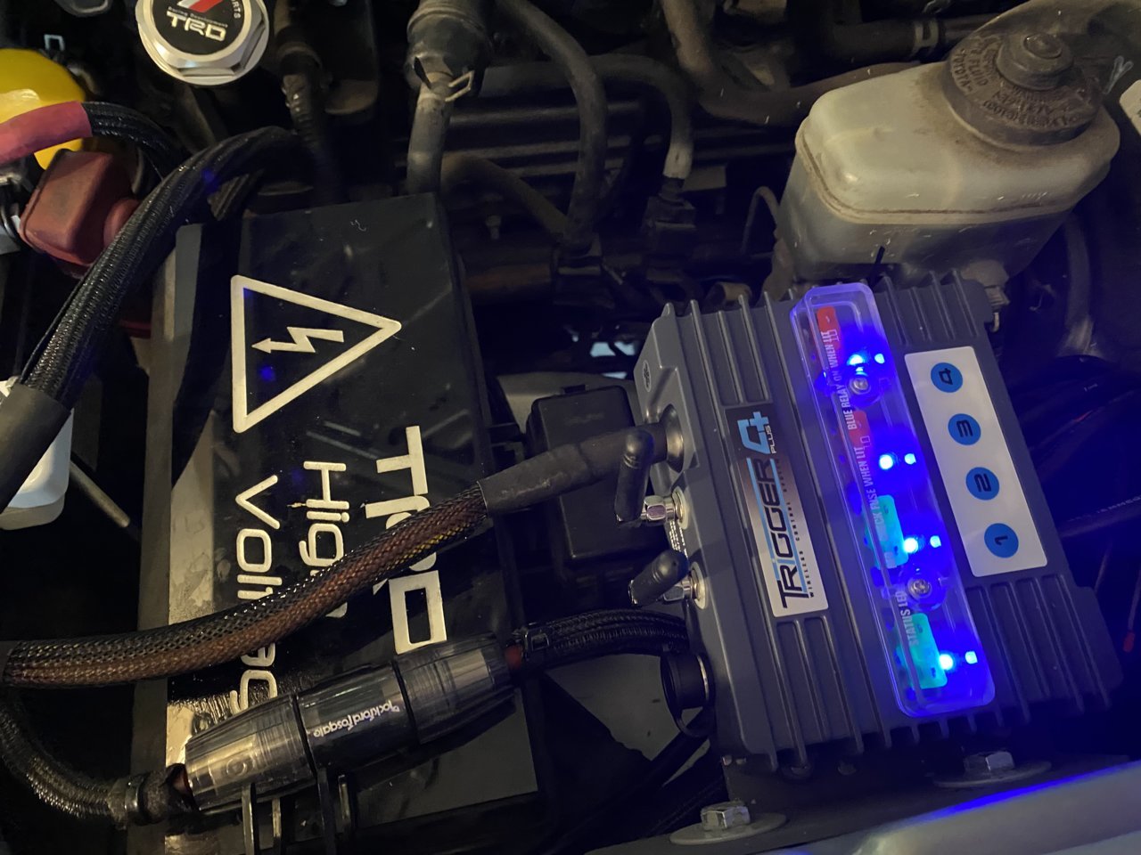

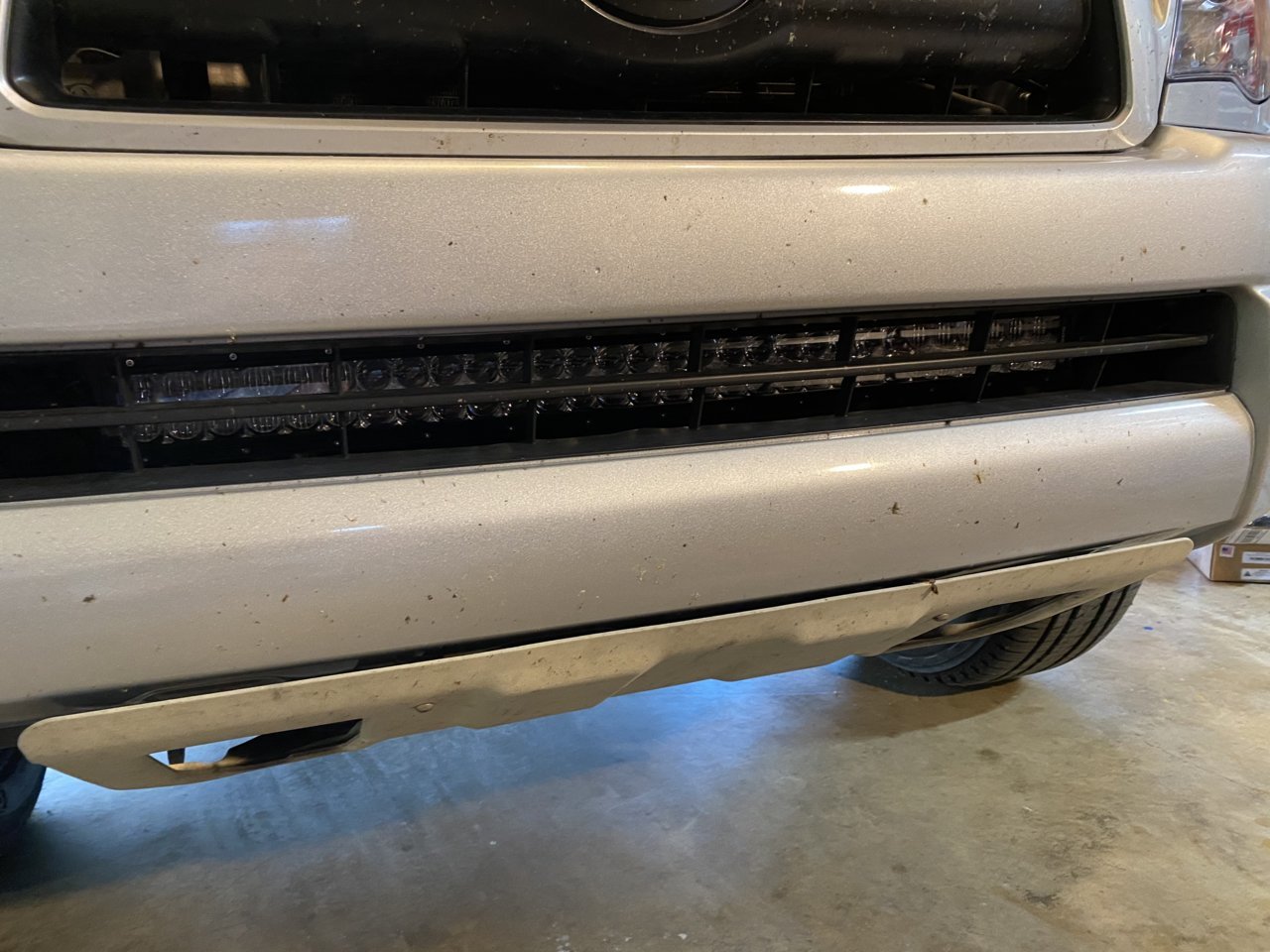

    We got it done today! great project and only cussed a few times! Auxbeam 32” lightbar. Caliraised brackets, Trigger 4 plus wireless accessory system for no wires Into cab

    Nice job! Glad you got everything successfully installed. You might want to consider some sort of revised cover for your positive battery terminal though.

    What would u suggest ? Open to all suggestions. I got those battery terminals before I started upgrading some mods

    Can you modify the OEM cover by cutting some slots in it for each of the additional cables?
