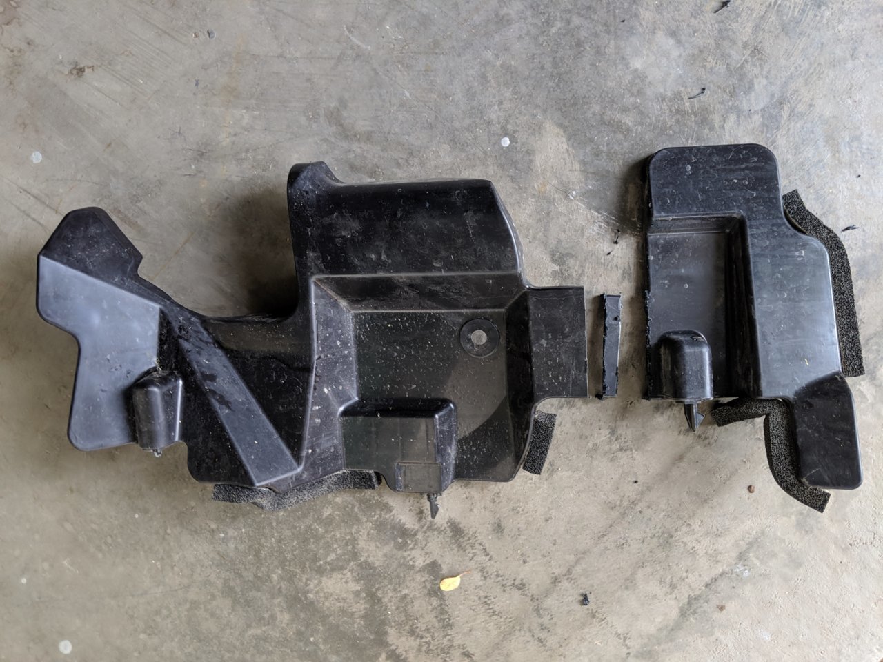

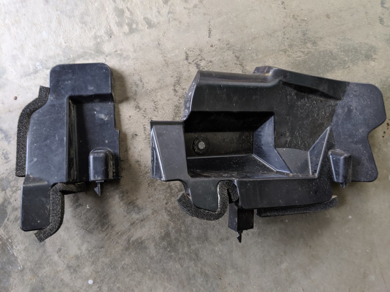

    +1, I just trimmed mine as well. Worked out down the line too, it gave me somewhere to mount the hid relay and switchback controllers when I had the BHLM done.

    Thanks for the pic! That makes sense.

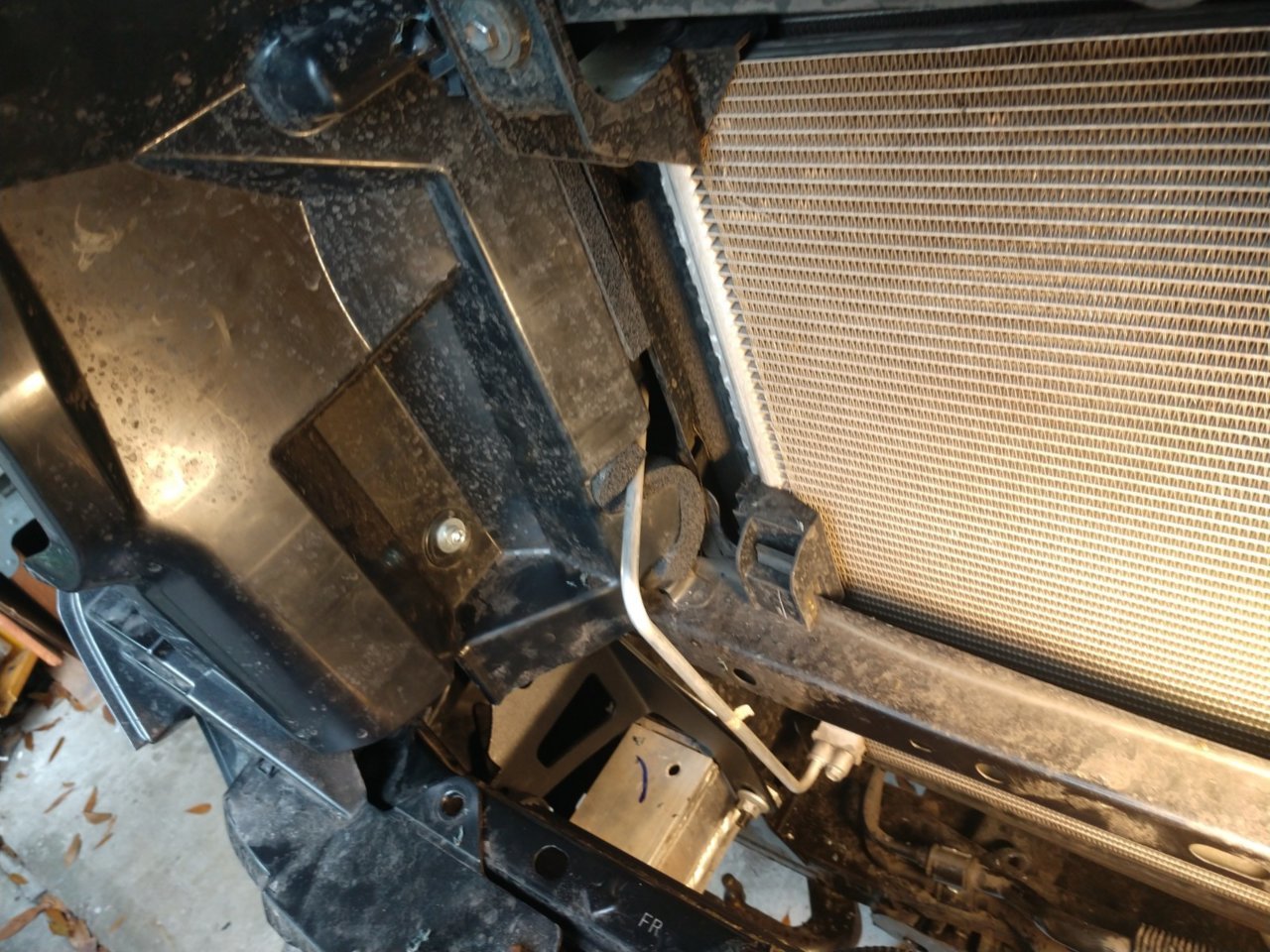

    I found a couple other photos of actually installing it and what I did on the air dams.

    Great pics, thanks so much. Always helpful to have a starting place headed into a project. I'll take some pics when I do mine also.

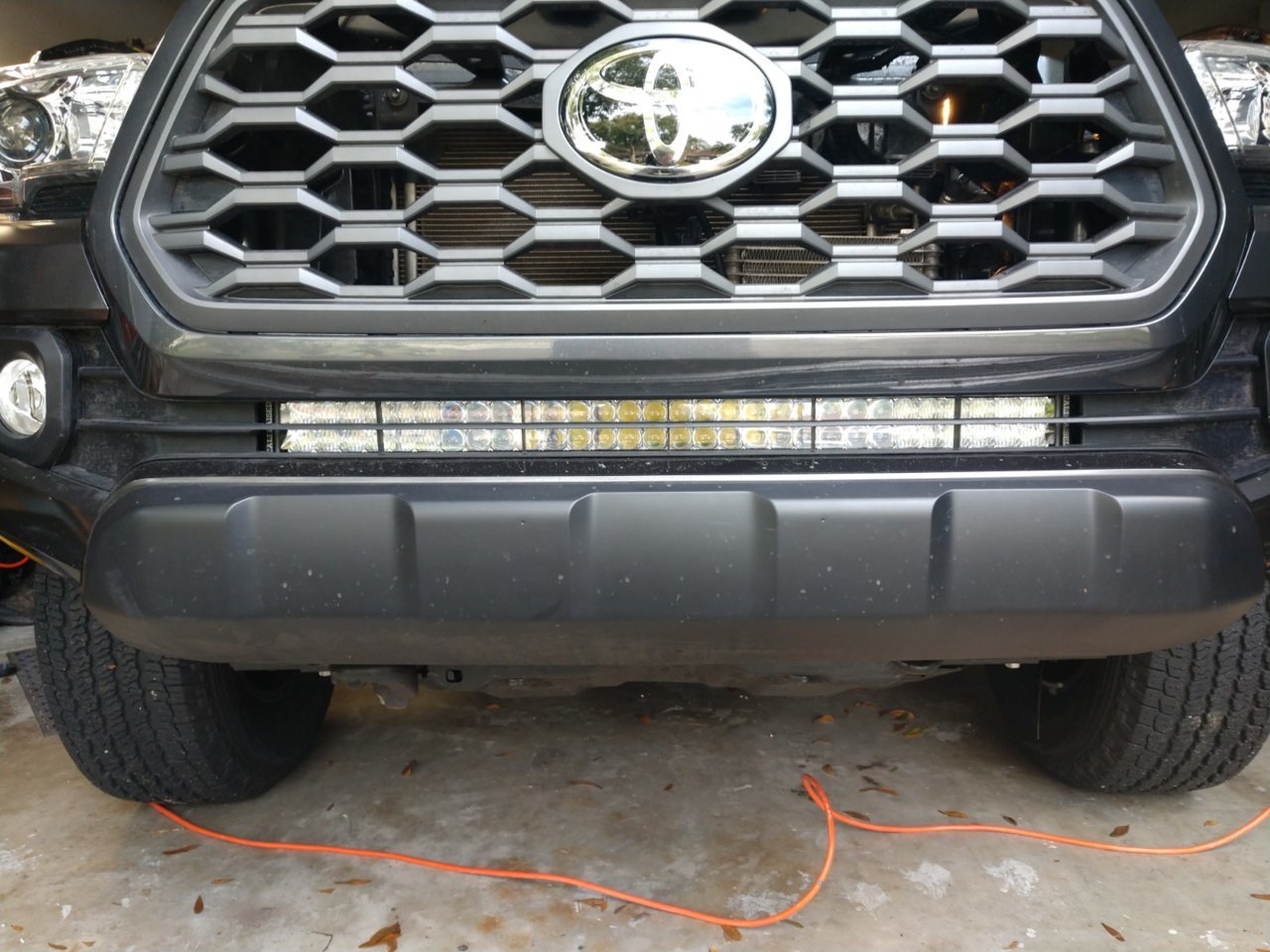

    IMG_20191228_143753226.jpg I
    I went ahead with the install, despite the lack of a wire kit. Empyre Offroad got back to me in a timely fashion, and said they would contact Caliraised about it, since it shipped from them. Hopefully that gets sent out soon.
    I was able to keep my air dams, and trimmed them using the pics that WyoRoadDog had posted, which saved me a lot of trial and error. I had a lot of trouble getting the lightbar itself down in there following the video on the Empyre Offroad sight. It tells you to install the bracket loosely first, then somehow weasel the light-bar down in there. It very conveniently does not show how they actually do it, you just have to guess. I tried if from the left side first, (as you are facing the front of the truck) then the right side, then back to the left side with no luck. It kept hitting the bracket. I found that if I removed the left bracket (or didn't install it first) then the light-bar easily drops down in there, and you can slide it over, then install the bracket.
    Reaching through the tiny holes to tighten all those bolts is another big pain, and I found that removing the two visible screws and the clip for each headlight allowed me to flew the headlight assemblies out of the way just a couple inches, which helped get my arms down in there a little better. I suppose removing them altogether would have made it a lot easier, but I wasn't sure how to do that, and this was my very first mod, so I'm still learning. (unless you consider looking up the odometer/ignition sequence on a 2008 taco to disable the seat-belt alarm, which I suppose really isn't.)

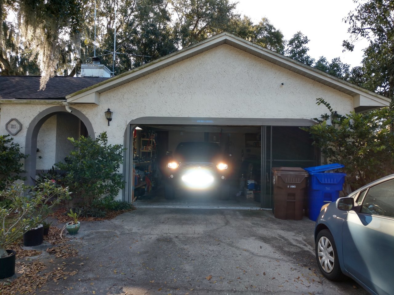

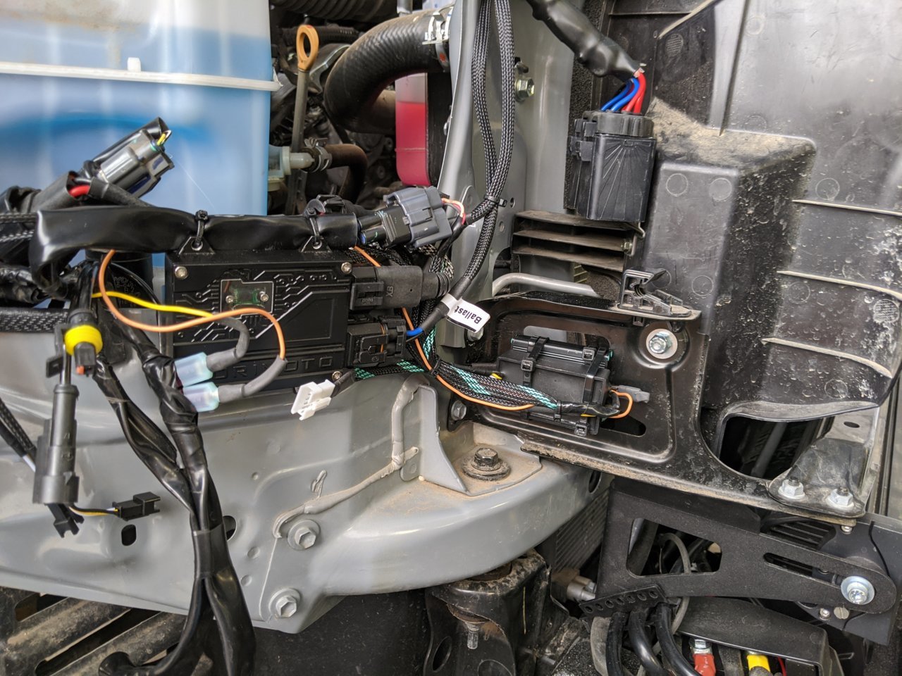

    Well I finally got the wire-harness from caliraised yesterday, and installed it today. Install was a breeze, and I used an OEM switch instead of the one that came with it. The switch lights up nicely to tell you it's on, but isn't obnoxiously bright. Instead of cutting a hole in that big boot with all the wires running through it, I ran the wires through a small hole that had a little rubber plug in it just above that hole. I had already removed that plug anyway, to install a dual-band mobile radio system.
    I was worried that it wouldn't be bright enough. Boy was I ever wrong about that. This thing is awesome. Granted this was taken at like 10 O'clock this morning, those are the high-beams for comparison. Can't wait till it gets dark.
