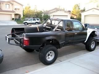

    2000 Tacoma Prerunner
    Supercharged, Linked and Caged
    So my girls truck slowed down for a while until she gets her own cash..
    figured ill keep track of whats going on with my truck
    I don't have pictures of everything, but there will be ALOT of pictures
    Ill start from when I got the truck

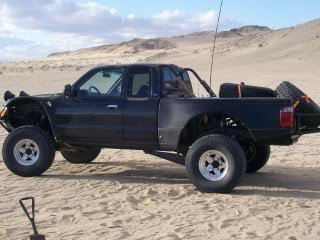

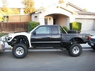

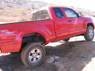

    well I started with this guy
    Decided that I was going to be dedicating a lot of my time/life to offroading and saw fit that I needed to ditch the new wheels and getting something more... fun :)
    Then i saw this ad on RDC month or so later... ended up talking the guy into trading my truck for his truck (complicated situation)
    and pretty much I scored.
    it was built by HNM in 2000-2001
    it had Camburgs first Lt kit for the tacomas (mix of b/js and uniballs)
    a custom 3 link made by hnm
    Currie 9 inch rearend
    Detroit locker
    bed cage and cab cage all 1.75 and mix of 4130 and DOM
    tundra front clip
    2 sets of seats, and ungodly amount of tires and rims :) never a bad thing
    32 gal fuel cell
    and al ot of other things
    3.4
    auto
    supercharger
    The truck came with the new updated Uni-ball uppers from camburg
    aswell as spare tranny
    It has 2.5x10 fox coilovers in the front w/ bilstein bumps
    The rear has Bilstein 9100 coilovers and 4 tube bypasses per side (honestly noone has any idea what size the shocks are, there ginormous

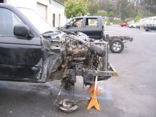

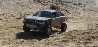

    I took the truck out for thanksgiving and had a little fun with it
    ended up snapping a driver tie rod 10 mins after doing shell reef, but that was after day 5 of mashing on it, so in my books its was a great buy, motor was fast as shit and the rear soaked up anything i could do it. the front on the other hand fell short.

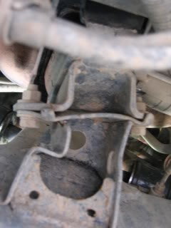

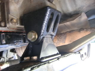

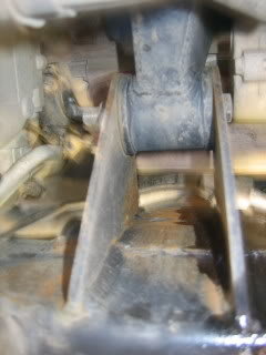

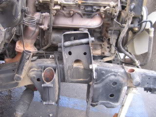

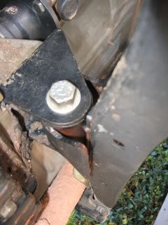

    a month or so later i ended up smashing the tranny/engine mounts chasing a sand rail that ended up leading me right to a random wall, that i charged, at 45 and it hurt, alot.
    smashed tranny mount
    and engine mount
    so with this problem leaving me out of driving i quickly found a shop that would be interested in helping. I finally decided on Richer Racing after a great referrel from my step dad.
    they really helped me out and made some bitchen mounts at a great price
    tranny mount
    engine mount
    Got the truck working great, revalved front shocks and put some new tires and rims on it, did a little painting
    decided it needed a testing run at oco, did great, 90's through the straights and hitting 80's in whoops

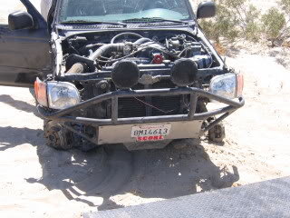

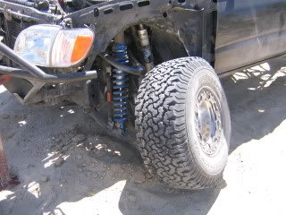

    then on the way back down the railroad from watching the mdr race, hell broke loose again, just cruising down the railroad at about 75 i hit a little riser and shot me up higher than i thought, came down and snapped the puny little camburg kit in half
    i snapped both lower arms off before where they connect to the spindle, i bent bother brand new uppers nicley spindles looked kinda funny and smashed all the inner fender well that was left.
    So great, i probably have some of the worst luck possibly, none of these mishaps have been due to driver error, even though the last one seemed as it was.
    I recieved a apology from Jerry over at camburg for the failure of the kit, and was offered some insentives to put his new race kit on my truck, but decided to go with the company who i know personally and trust.

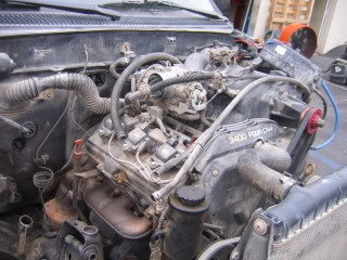

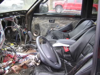

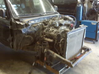

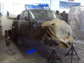

    SO back my truck goes to richer for Jonny and Mike to put his brand new(just finished designer yesterday) tacoma race kit
    and to have an engine cage and some other misc stuff done.

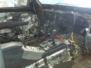

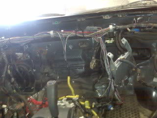

    heres some tear down pics

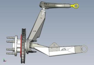

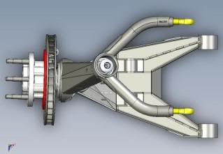

    Heres some cad desigs of the kit
    the kits is 5 inches wider than stock per side
    everything is Cromo
    uniball/heim
    wilwood 4 piston brake kit :))
    Will be Tig welded

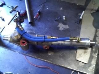

    the stock rack posed a huge problem in the design stages with this and jonny ended having to modify the stock rack to attain 0 bump steer, im not sure on travel numbers, its 16.5 right now.

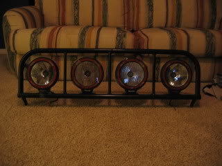

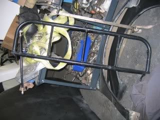

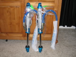

    i also picked up these bad boys a few weeks ago(traded the race bike for these)
    3.0x10 kings 4 tubes
    and a light rack

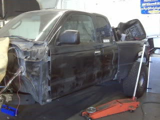

    Truck is in the shop and getting the front cleaned up so we can hang the suspension

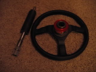

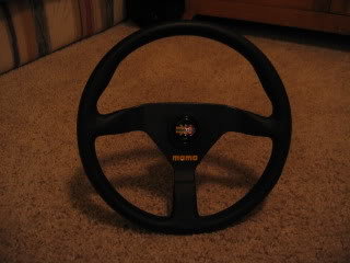

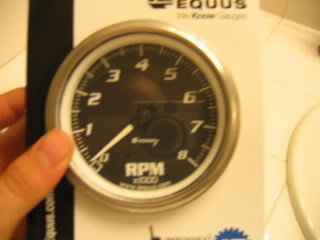

    got some new goodies today after selling some motorcross gear

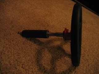

    Momo Steering Wheel, Sweet mfg. quick disconnect, bms steering column
    Gauges- Volt, water temp, oil press, tach (speedo being shipped)

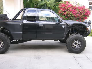

    when the truck was built no one made tacoma fenders to fill the massive ass rearend and tires im a little over 80 inches in the back, i think 82 with the new rims, and even these 6 inch fenders are about 3 inches short on each side.... the truck will definatly get all matching glass and a repaint before i race it.

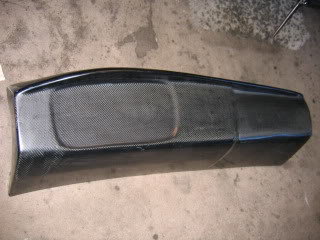

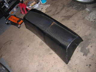

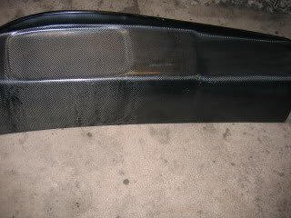

    got a great deal on a fiberwerx carbon fiber dash
    its cool, there is a few scratches on it.. but i have to cut out holes for gauges and such right there so it works out
