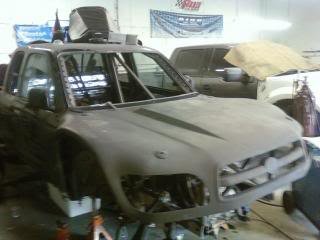

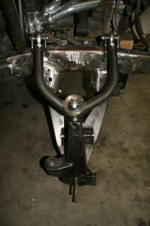

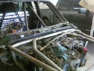

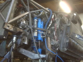

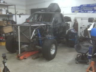

    Hey sorry, been super busy helping out with the truck, got alot of updates, and will hopefully be making a full speed debut on thanksgiving in ocotillo
    progress so far...
    these sexy shock mounts are just mock ups :)
    kit pulls just under 18", truck is on the ground, but then was pulled off again to change the shock mounts to a stronger style.
    this week and next will be the most progress and will be done probably 4 days before thanksgiving

    thanks, it took alot of cutting of the lower arm mounts and such to get the numbers... also those numbers wouldnt be possible without the custom modified rack

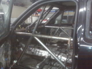

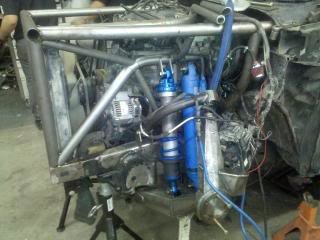

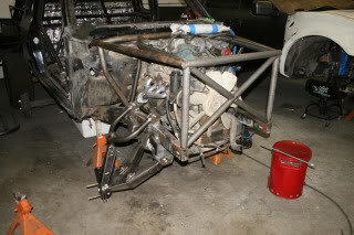

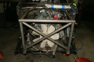

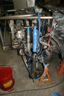

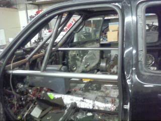

    door bars are gettin there
    more on the engine cage
    only like 4 or so more tubes on the engine cage

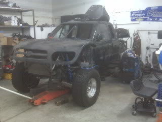

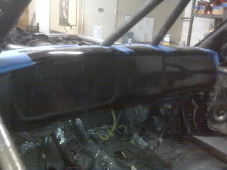

    this dash is not supposed to fit in a tacoma! lol
    door bars are done
