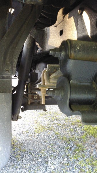

    I just got my leaf springs replaced. I didn't look at how they where installed before, but the new ones look odd to me. Not the way I would have expected. Does this look correct?

    Looks like the proper Tacoma no arch.

    Is your back end squatting? Out here looking at mine right now (original 3 leaf pack) and I seem to have wayyyy more space between the bump stop and frame. I also have helper springs, but that only gives me an inch or so.. I dont know, might be illusions from shading in the photos or something?

    Thanks for that. The lack of an arch is what threw me.
    Here is a pic of the bump stop
