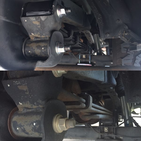

    not only did they NOT move the AAL over, they appear to me missing in action. serious rear dragging. i'm not even sure the AAL will work with the new leaf pack. there seems to be an extra set of banding..oh, it is four leaf pack.
    i got the shop guy and he was horrified. not so sure what my next step is. i'm tempted to find OEM parts for the front and drop it back down to stock.
    i'm over it.
    LESSON LEARNED..if you have any lift, dont do the recall. the shop guy said he messed up. they were not even supposed to touch my truck with the AAL.

    I'm gonna take a deeper look this weekend. I may end up cutting of the tips of 2 bands to be able to slid the aal in

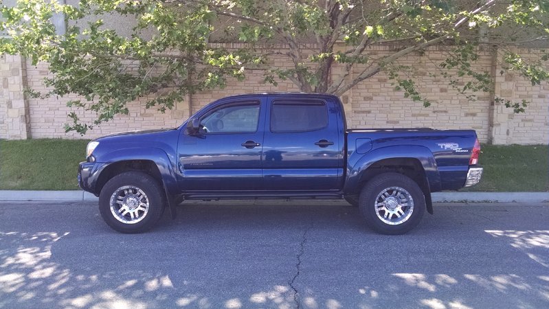

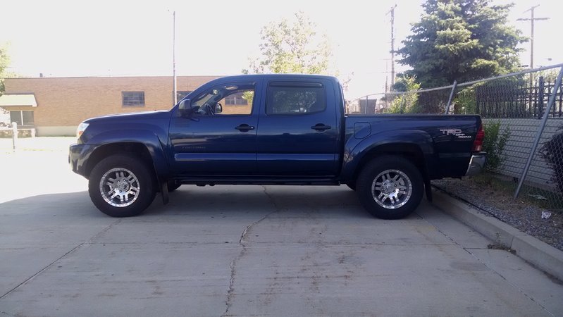

    Proof is in the picture...saggy as $hit after less than a week!
    Took measurements before I installed my AAL this morning. Rear was at 35.5" almost two inches lower than my TSB pack. Front was at 36.75" with 5100's at 1.75".
    After install of the AAL the rear sits at 37.5-38".
