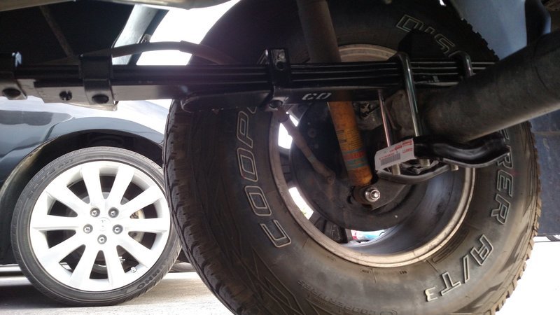

    Anyone else notice this photo of the new RH spring in beavis87 post? Looks to me like they installed the spring with the center pin binding, preventing the overload from sitting flush with the rest of the leaves. I am looking to get my TSB springs replaced. They have been good so far. Will be pissed if I lose ride height.

    mine sag too, this things are no better than the old ones. They may not break and puncture your gas tank which is good but they sure dont help with weight in bed or just by them selves..
