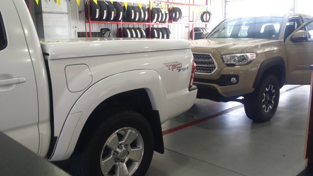

    In line for leaf inspection 9am this morning!

    Well they told me they need to order the leafs and about 3 months and pretty much everyone is qualified for the replacement
