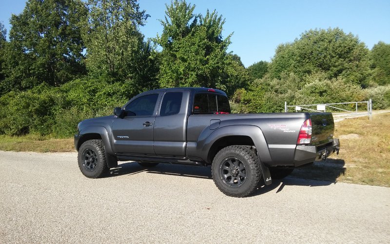

    I installed sumo springs to my recall springs today. It's noticeably firmer and I gained 3/4" lift in the rear. The sumos are contacting the frame in the truck's static state with whatever cabin/bed/slider weight I have. I took it off road and the truck still flexes enough for my needs. I'd say it's stiffer than the 3 leaf aal setup I had before. My centerline measurements are 21 1/4" front and 22" rear. I'm happy with the stance and no doubt it will haul what I need. This is how it looks with eibach springs at the front with billy's set at 0 and 265/70/17 duratracs. I think this is a viable solution...especially given how ez it is too install the sumo springs.
