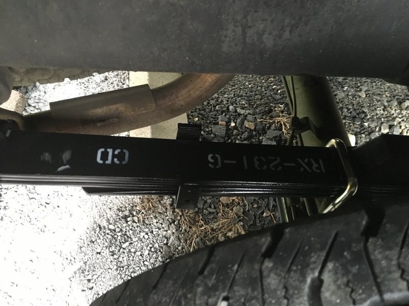

    Well my friend helped me find the source of the squeak - looks like the mechanic didn't pay attention to what he was doing.
    Passenger side looks good:
    Driver's side not so much:
    Don't ask me how you could look at that and think that's how it's supposed to be - obviously the mechanic was indifferent or unknowledgeable about this install job or just did not g.a.f. Since I have to go back to have the correct spiral (airbag?) cable on the steering column from the other recall they didn't properly carry out, I'll have them flip that bolt around too.
    Scary to think these guys are paid what they're getting paid to pull this kind of nonsense. I'd like to get paid as much as they do working on my truck and actually putting effort into it. That's life though. :) Guess I'm glad I'm learning how to work on my own vehicle. Nobody will give it the thought I do at a major mechanic shop I guess. It's fun to learn and saves money so I'm happy lol.

    Wow that is some terrible wrenching. Looks like you have some nice scratches from that bold. Hope they properly seal the metal so it doesn't rust there.

    Not only did the put the bolt in backwards, they were too lazy to replace the rubber shackle bushings as called out in the Technical Instruction.

    mine chirps like a bird after the recall. i'm gonna take a look now.

    Thank you for the heads up! I'd say something if I was keeping the rear suspension for long, but it's getting replaced soon so as long as they flip that bolt back the right way it'll be fine with me and it'll most likely be the last time they touch my truck. The customer service at this dealership is really great, but the techs are either rushed or inexperienced - they also left the moulding around my steering column unclipped after replacing the airbag cable that ended up being the wrong cable.
    The great customer service and limited ability of the techs is like driving a really sweet sports car with an anemic engine and no handling - all show and no go. Oh well. The biggest concern to me is that they didn't even check their work - heck everyone makes mistakes sometimes, but to not check their work is not a mistake someone working on vehicles should be making.
