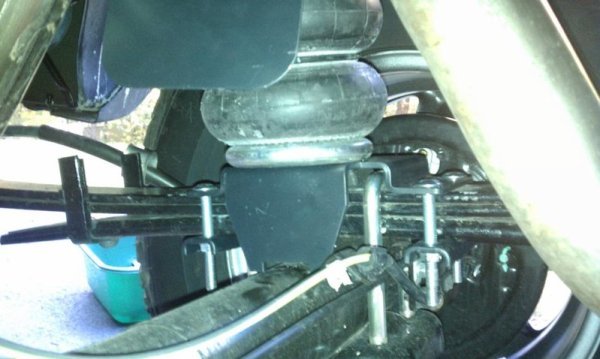

    Can you measure from the top of the springpack to the axle.

    top of springs to top of axle looks to be about 2.5", its a tough place to get a measurement using my tape measure
    ok, cheap dial caliber says combined spring pack at thickest part is 1.70", or including hte U bolt shackles, 2.40". this measurement does NOT include the welded-on platform on top of the axle that the spring pack rests on

    Thanks, I appreciate you doing that and those measurements should answer my question.

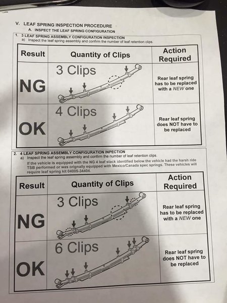

    Usually the stealership will have any information on the truck regarding recall work and tsb work. I'd call and ask them about it and see if they can look up your truck and see what's been done or not been done.
    If you only have 3 leafs then you most likely qualify for the recall. The last recall (before the one discussed in this thread) that was done replaced the old 3 leaf packs with 4 leaf packs

    There used to be a pdf or a picture of the criteria that toyota looks for when the inspect the the truck. I believe it stated that if you have the 3 leaf pack with 3 clips then you get the replacement pack and if you have 4 leafs with 6 clips then you've already had the other recall done. Im not 100% sure about that last statement so don't quote me but I remember my old leafs had 4 leafs (3 leaf Springs and 1 overload spring) with 3 clips.
    I wish I could find that pdf to be sure though

    The number of leaves is not relevant in determining if the recall has been performed. There are "post recall" 2+1 spring packs available.
    Here is the thing about the recall... it has NOTHING to do with making the spring less prone to breaking, and *EVERYTHING* to do with those clips you mentioned. Their purpose is just to keep the leaves in line WHEN they break, so that they don't swing out sideways and break things, like your gas tank or brake lines. I.e., its a "safety" recall, not a "quality" recall.
    The easiest way to determine if your springs qualify for a recall is to look at the clips that are riveted onto the OVERLOAD leaf. If there is only ONE clip on the overload, then the recall applies. If there are TWO clips on the overload, you're screwed.
    The total number of clips for post-recall springs will be 4 for 2+1 leaves, or 6 for 3+1 leaves.
    All vehicles shipping AFTER OCTOBER 2010 will have the updated springs.

    Check to see how many clips you have on your leaf springs. If your 07 has never had the springs replaced under this recall then you should have the leaf pack with 3 clips like my 07 had in which case they will replace them with the new leaf springs.

    Yup, only three clips on mine.
