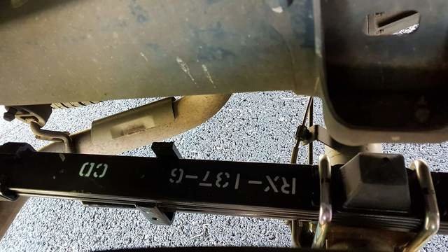

    The numbers are probably just for the manufacturer for QC and stuff like that. I'm only guessing though

    FWIW the springs were replaced on my '09 before I bought it last October¹ they have this code:
    ¹ - As much as I knock the "Certified Pre-Owned" thing (they certify it's used) I have to admit it has its benefits--Toyota will not let a dealer label it a such unless all recalls and TSBs (including "expired" items) have been applied. The official recalls you can get for free at any time, the TSBs are a different story...
