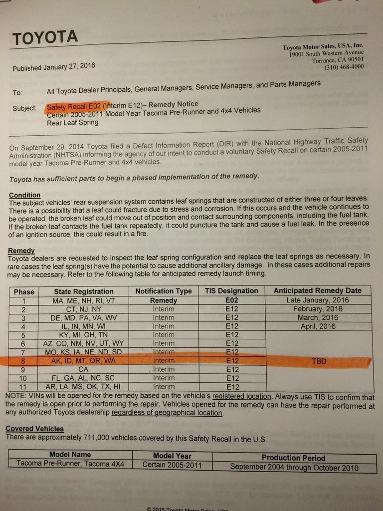

    I just got a call to schedule my recall repair for the leaf springs...I have a 2010 with 90,100 on it and it's still covered by my Certified Used warranty until 100,000k so I have been nervous they would give me guff if it went over 100,000K so i am not doing any unnecessary driving...

    I have been "on the list" at my dealer since like march of '15
    Absolutely...
    $10 says they only do the left side :(

    My buddy just got back to me. I guess I'm in phase 8!!!!!:mad: He says it should be late summer early fall before they start phase 8!!!!!

    If they stick with a phase every month, I am looking at June sometime....this is probably the worst handling of a recall I have ever seen....
    I am also bugged with the wording in the notice "replace the leaf springs AS NECESSARY...." WTF! They should be replacing them, no if's, ands,or butts about it!!! How could they not, when they have been deemed to be a safety risk.
    I will continue to play ball, but when they only replace the left side, or try to deny replacement, I will throw a set of Dakars on, and they WILL eat the cost for them.

    Good luck with that. Toyota Corporate and the dealers have been supreme pricks about this from the get go. I've gone rounds with both. I'm in the same boat as you, Oregon. I agree that the new wording "As necessary" is absurd. Corporate told me months ago that they will replace them all. They just wouldn't say if it was during my lifetime or not.
