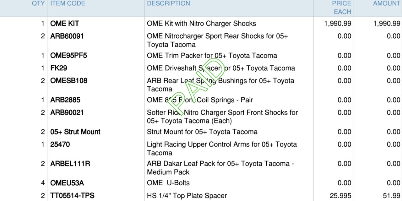

    Hello everyone, I just ordered my lift kit and was looking for some input. Is there anything you guys would recommend me doing differently? and Is there anything you would recommend that I know before I install it? also thoughts on the 1/4 inch spacer? and last question how much lift do you think I will achieve front and back on my 2006 tacoma double short bed cab 4x4 with a topper and no other added weight other than about 150lbs of tools in the bed. Screen Shot 2021-01-29 at 8.13.51 PM.jpg

    Dont forget the ecgs bushing
