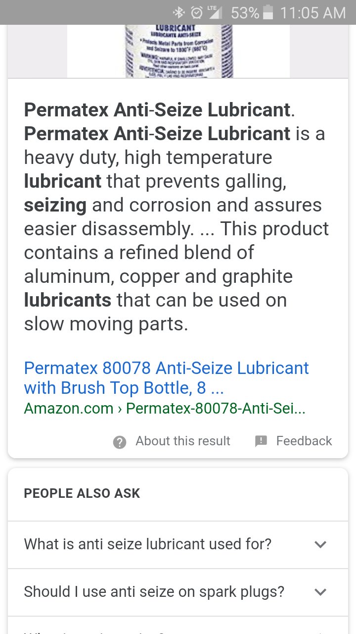

    First of all, great writeup! It got me thinking about doing something to my 2014 - if it's not too late. I live in an area where we use tons of road salt and I fear it may already be too late.
    I do have one thought / comment though. Never Seize does not contain any corrosion inhibitors. In fact it was designed to prevent metal to metal contact causing the surfaces to gall and lock together - not corrode (rust) and lock together. When I do mine, I plan on using Waterproof Trailer Bearing Grease instead. It's designed for use on boat trailers where the bearings take regular baths - sometimes in salt water. It also contains corrosion inhibitors to prevent rust. Although either product will definitely do more than the factory plated finish on the bolts, I think the grease with corrosion inhibitors will work better.
    Hope that helps.

    I'm sure the grease will work well too.
    I went with antiseize/lubricant because I've had great luck with it over the years. I've used it many times to prevent wheels from seizing to hubs. Also, rotors to hubs....and many other applications.
    The whole point is not so much actually lubricating the cam bolts and sleeves....but to prevent them from becoming one with each other and/or the LCA bushings.

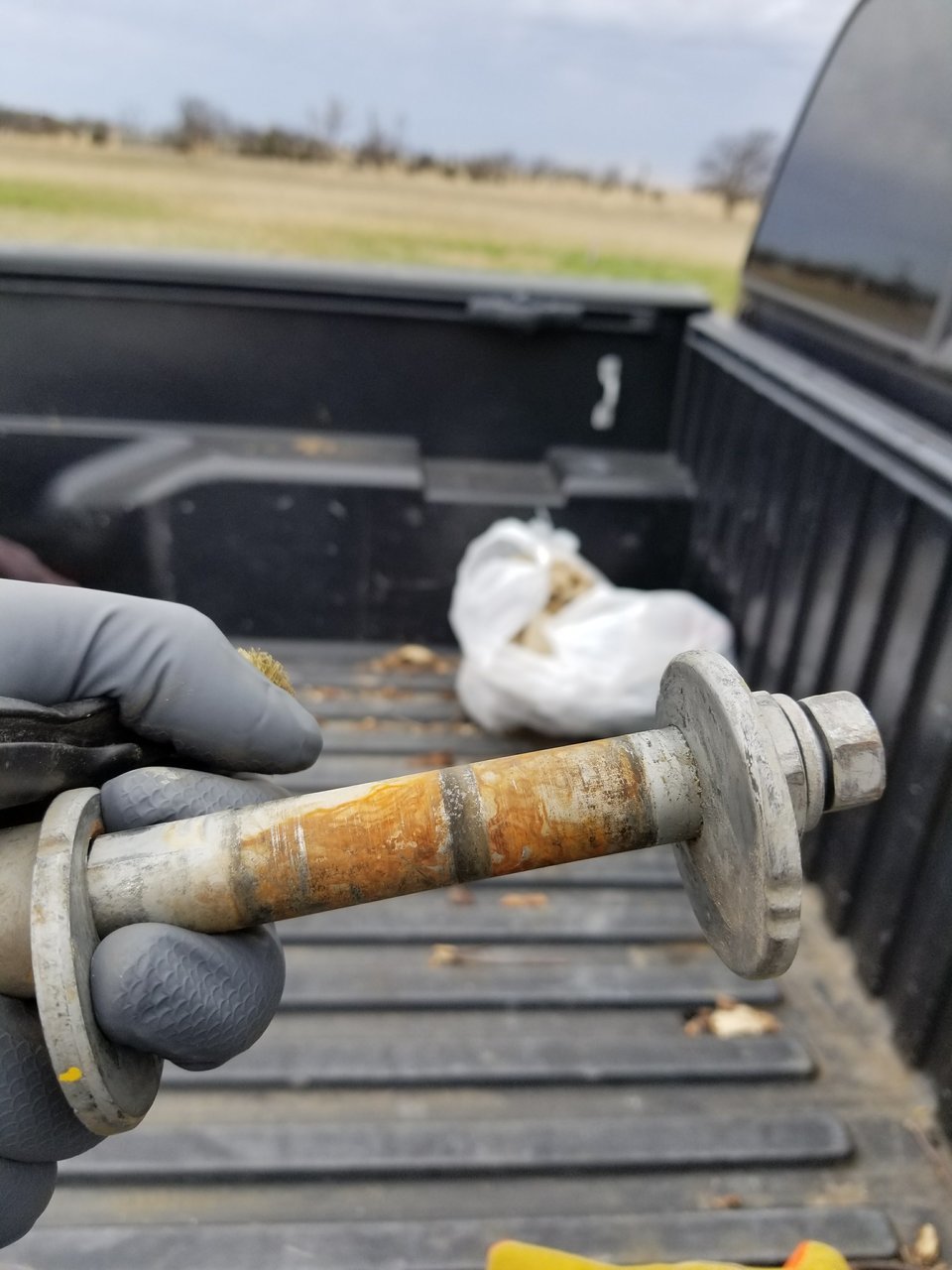

    Ok. 2 year update. I wanted to pull these adjusters again just to get an idea of how things have held up after two years, including two more winters. I also wanted to share with others so they could have an idea as well.
    I'm pleased to say I have nothing negative to report. Everything came apart like butter....easier than the 1st time, in fact. Nothing frozen. Zero corrosion anywhere.
    I didn't take any pictures as nothing significant was different other than not having to sand off any corrosion. The only other differences between this time and 2 years ago was that I have a TRD skid. No reason to remove it like the factory skid, as you have plenty of clearance. I didn't need to mark my alignment either because I could still see my white touchup paint marks with a bit of wiping.
    So now I know. This procedure works great and the anti-seize does a great job of keeping things easy to disassemble and corrosion free.
    I encourage everyone to do this ASAP. Don't wait. And I don't think it absolutely has to be anti-seize. Any type of high temp grease or marine grease. Just some kind of heavy duty lubricant to keep things from becoming one
