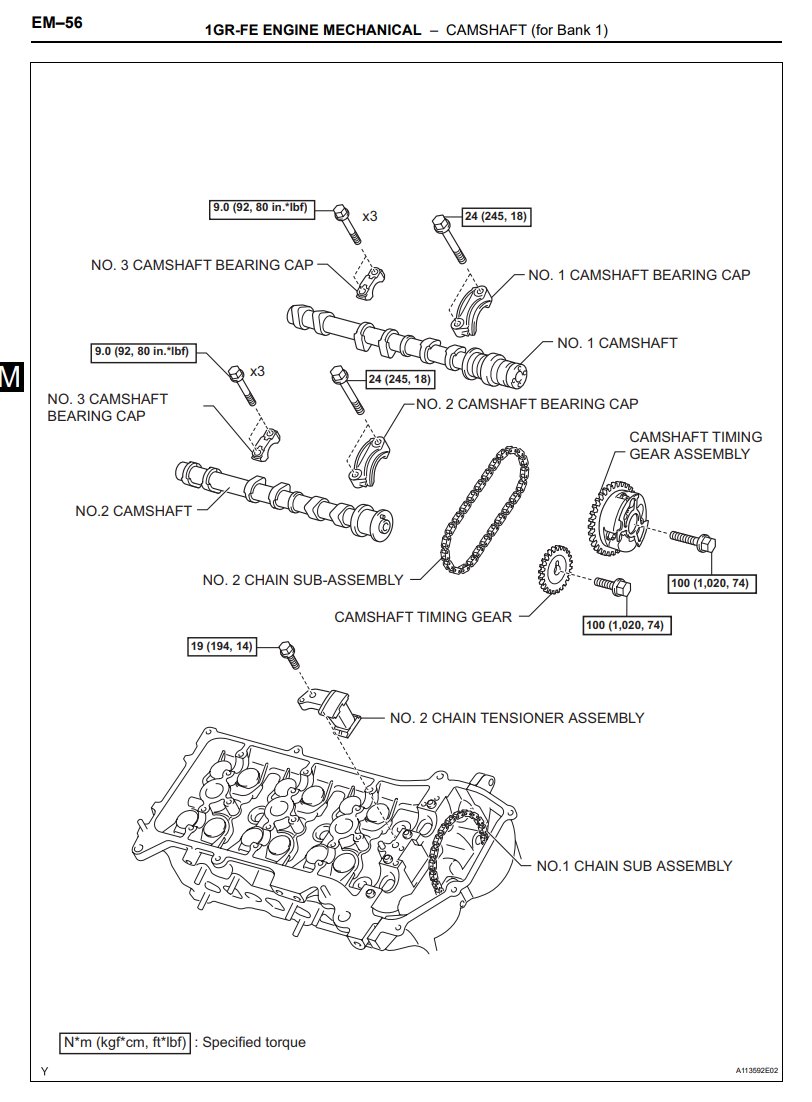

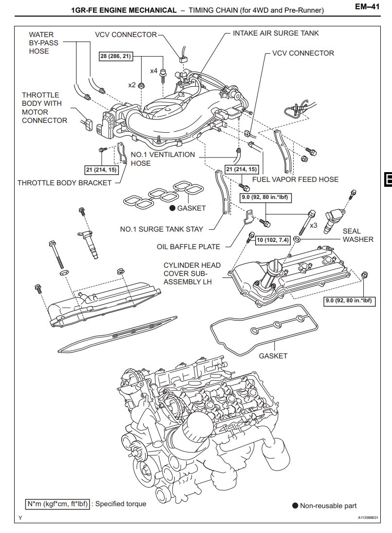

    OK, getting all the info I have researched in one place, figured id share it here as well
    Replacement Gasket part numbers:
    Torque values:
    • Cam Bolts - 74 ftlb
    • No.2/3 Chain Tensioner Assembly bolt - 14 ftlb
    • Valve Cover
      • Outer Bolts (7x short) - 7.4 ftlb (88.8 inlb)
      • Outer Nuts (2x) - 80 inlb
      • Inner bolts (3x long) - 80 inlb
    • Coil Pack bolts - 7.4 ftlb (88.8 inlb)
    • Surge tank (aka Upper intake) to lower intake (2 nuts, 4 bolts) - 21 ftlb
    • Surge tank stays / throttle body bracket bolts - 15 ftlb
    • Throttle body bolts - 9 ftlb
    Optional Stuffs:
    • PCV Valve - 20 ftlb
