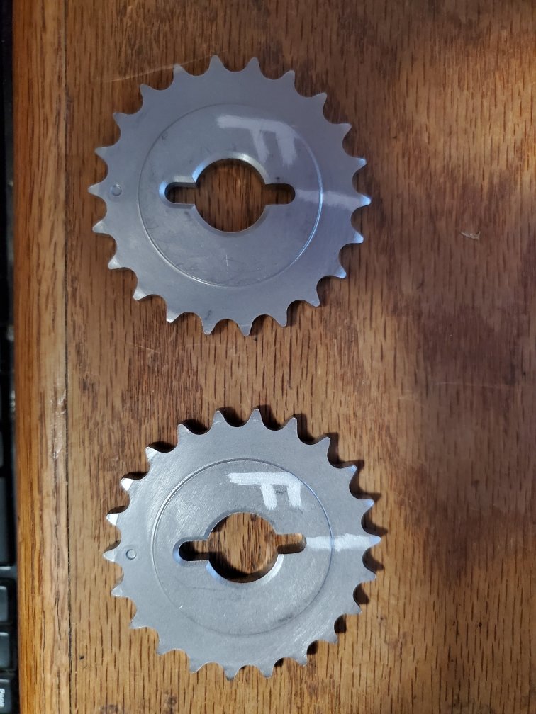

    Curious why my cam gears have a slot on bottom versus URD instructions showing gears without the slot? Prepping for an install. Top picture is from URD.

    Go back to page one... yours have been recut to 3° retard. The urd ones were cut that way by them. It's why they cost so much more.

    Make sure you actually use the new slot! Otherwise all that work to end up at square one haha

    Use the slot that is marked, not the original slot.

    John if or when you install- post a pic of them in place without the bolt on the end of the cam so that myself or another member here can confirm you have installed them correctly and give you piece of mind.

    Is there any potential for an unbalancing that would take place with the two slot design of the re-cut gears?

    These gears will never spin fast enough that balancing will come into play. But I would have my money on the re-cut gear being more balanced than the original. The 2nd cut is almost directly opposite the original balancing the gear as a whole vs removing material on just one side.
