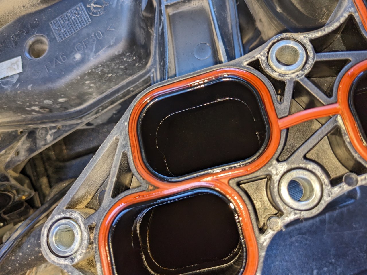

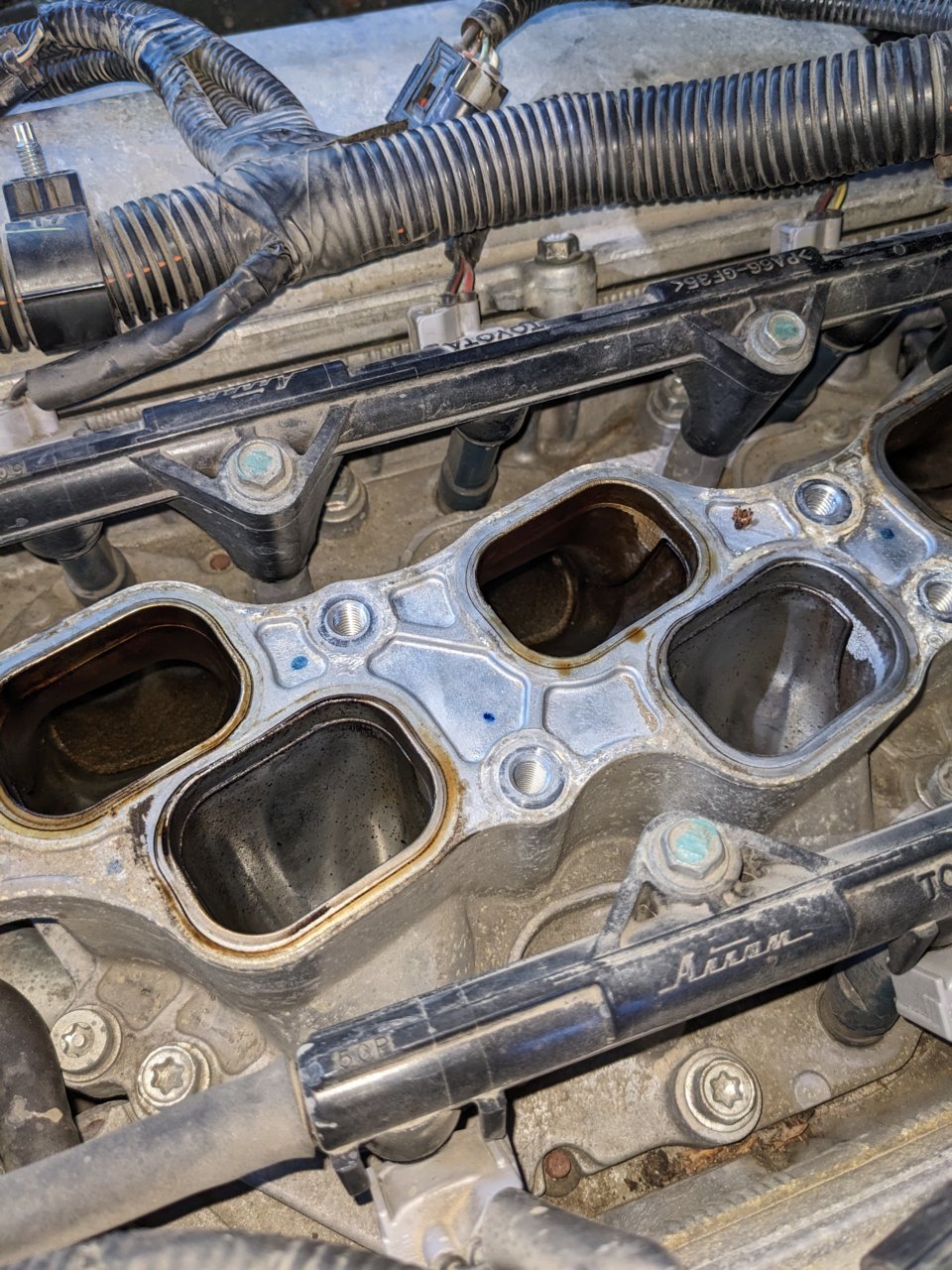

    I did get lazy and break one bolt tho during reassembly... The 10mm on the rubber isolator on the front of the secondary air filter box... There are ample threads still sticking out and it's easy enough to reach without too much disassembly... Woops...
    Things that helped a lot:
    - Etorx for SAI reinstall. Removing the studs was great.
    - Wrench extender bar for the 17mm
    - 17mm Crows Foot
    - Paint pen
    - Lunch
    - Patience
    - Tacomaworld
    My truck also has a Overland Tailor Tune (OTT) and I can't say I can feel huge gains from the Cam Gears like I did from the tune. This was just an initial on ramp test drive to and from , with some country roads in between. Certainly no worse in the power department.
    What I can say is I immediately feel more glide and less deceleration when coasting. Areas where I typically coast or apply slight throttle, I was instead applying brakes because the truck was coasting so much better. This must be the lack of reburn and less compression of exhaust gases at the end of the exhaust stroke?
    Eager to see any mpg changes and also to pull some larger hills on the interstate.
    Lastly, I noticed some oil within the intake manifold (lower intake) and the a surge tank (upper intake). Is this normal? The truck doesn't burn oil, has 77,000 miles, and runs great. Do I have a PCV valve problem?
    Thanks for everything y'all!

    Pcv valve can still let oil through and be functioning correctly. This is one reason some add catch cans.
    SUMOTNK and PNW15[QUOTED] like this.
