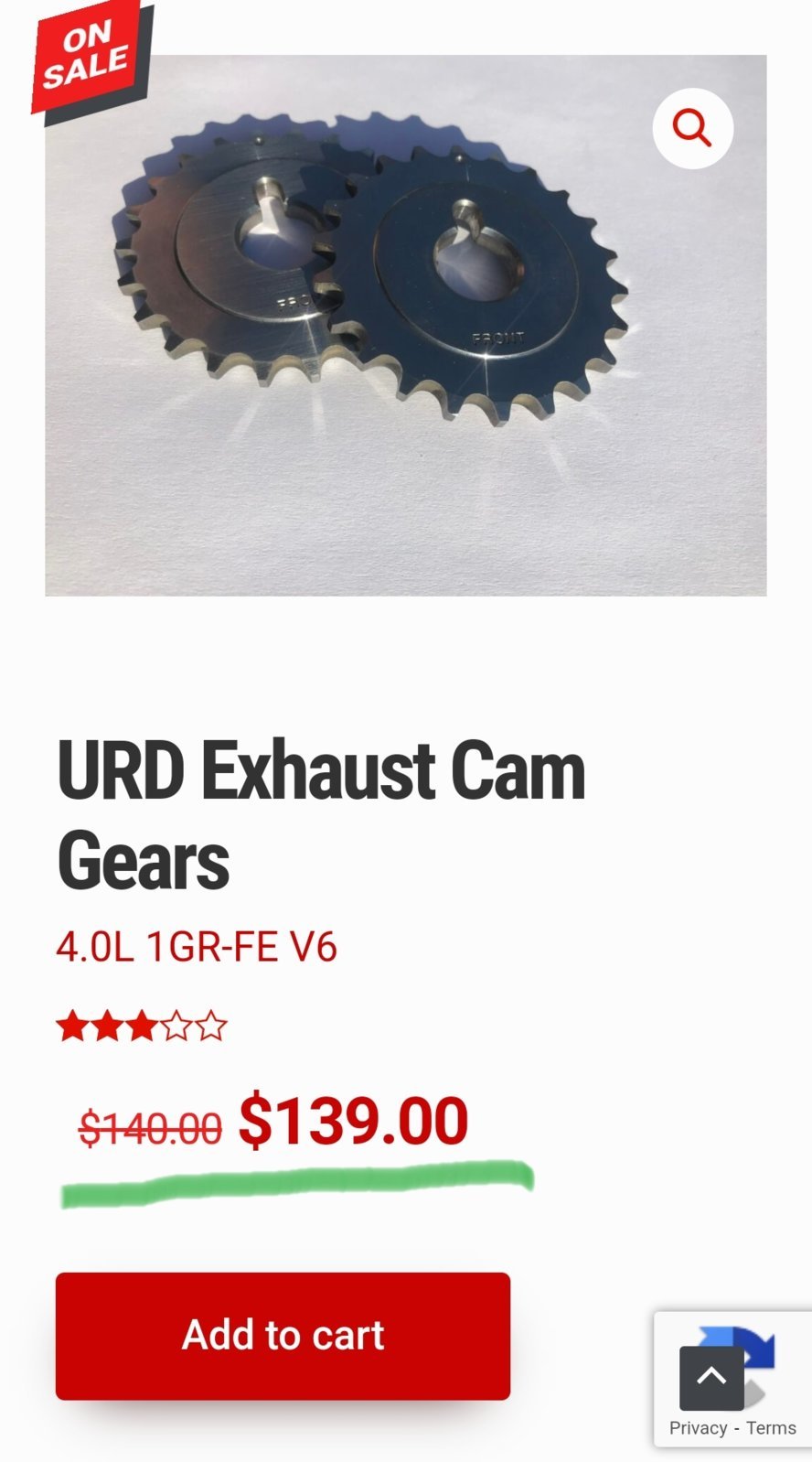

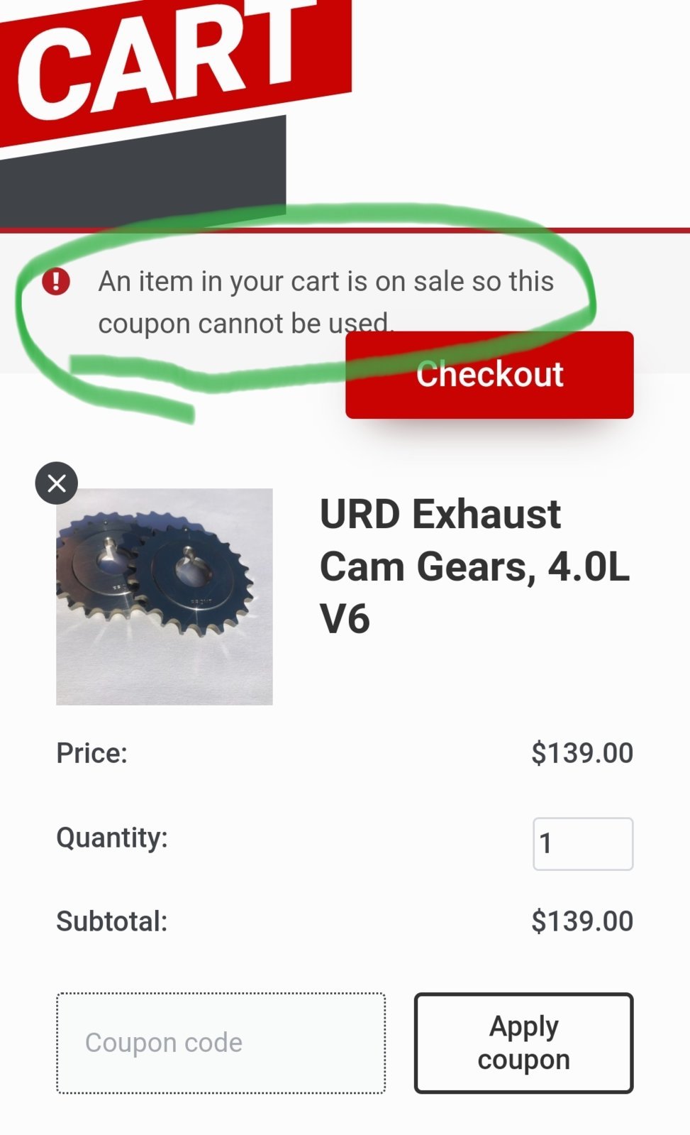

    I just though this was funny.
    Shadowhunter and TodayWasTHeDaY like this.
  17. Oct 14, 2023 at 7:30 PM
    #2097
    TodayWasTHeDaY
    TodayWasTHeDaY Hoser
    Jul 10, 2017
    #223673
    2,056
    Russ
    Calgary
    2015 DCSB SC M/T TRD Sport
    Hahaha that's some serious savings there.
    And it vetos the discount code to boot.
