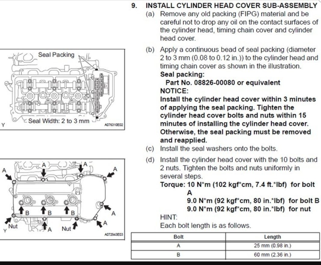

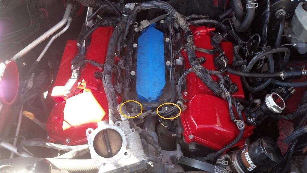

    I operate on the premise that the only dumb question is the one you don't ask so got a couple of questions before I start this next week:
    1. The thread said in a few places you might have to turn the engine up to about 30 times to have the timing line up right. Am assuming this means you might have to turn it that many times in order to get the timing marks on the cams and the crankshaft mark to all line up on the marks. Is that correct?

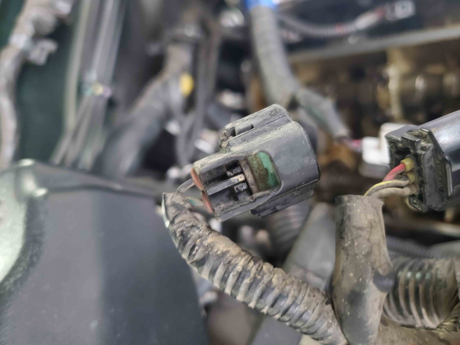

    2. This was one of the comments on the thread. Picture of what he was referring to is posted below but for the life of me I cannot see what the arrows are pointing at. Conducted some searches for the connector but still in the dark. Can someone post a few close ups of what he is referring to?: In an effort to gain as much free movement of the wiring harness as I could, I unhooked the ocv/vvt connectors. In hindsight, don't touch the damn things unless you have to! Upon start up I immediately threw a P0010 code. Cleared it and I think it was back before I even released the "clear codes" button. I wound up cracking...like, BARELY cracking the sensor's connector. It wasn't unclipping easily and wiggling it a little bit was enough to do damage. I put a tester on it to check continuity and got nothing, however I do not really know if it needs power to it to properly test it. The thing looked brand new too.
    3. Does the Permatex only have to go over the two small gaps near the front of each cylinder head not around the entire perimeter as the diagram below indicates? From all the videos I've seen it just takes a small amount on the gaps. Think the diagram might have been for an earlier Tacoma.

    1- been a while but i think 8 turns off the motor will get the cam chain marks lined up. The chain will only line up with those marks every 30 or so turns. It's not necessary but can help increase confidence if you're worried.
    2. He's talking about the vvti sensors- some engine knock sensors are near them too. Some people have broke them removing the electrical connection. Use careful hands.
    3- about an inch of the permatex where the front cover meets the heads is all you need. Regardless of the year of the 1grfe

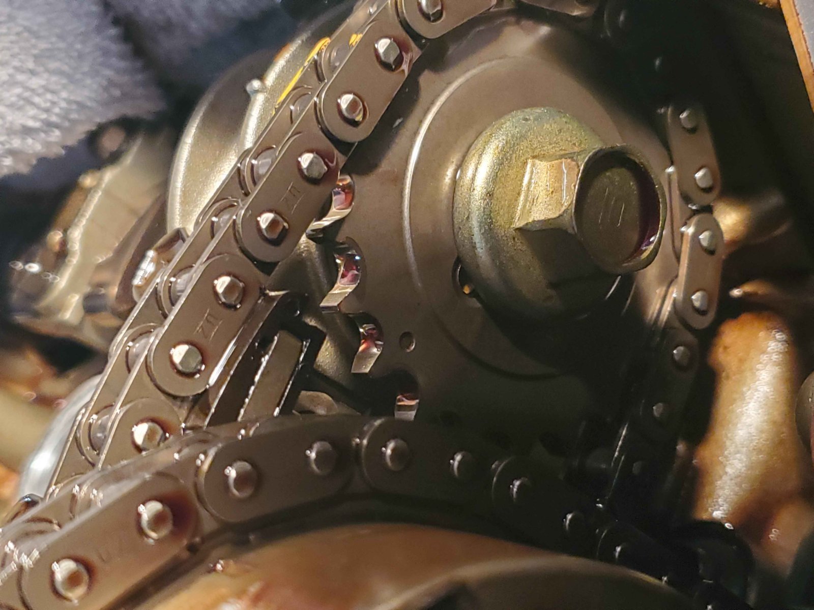

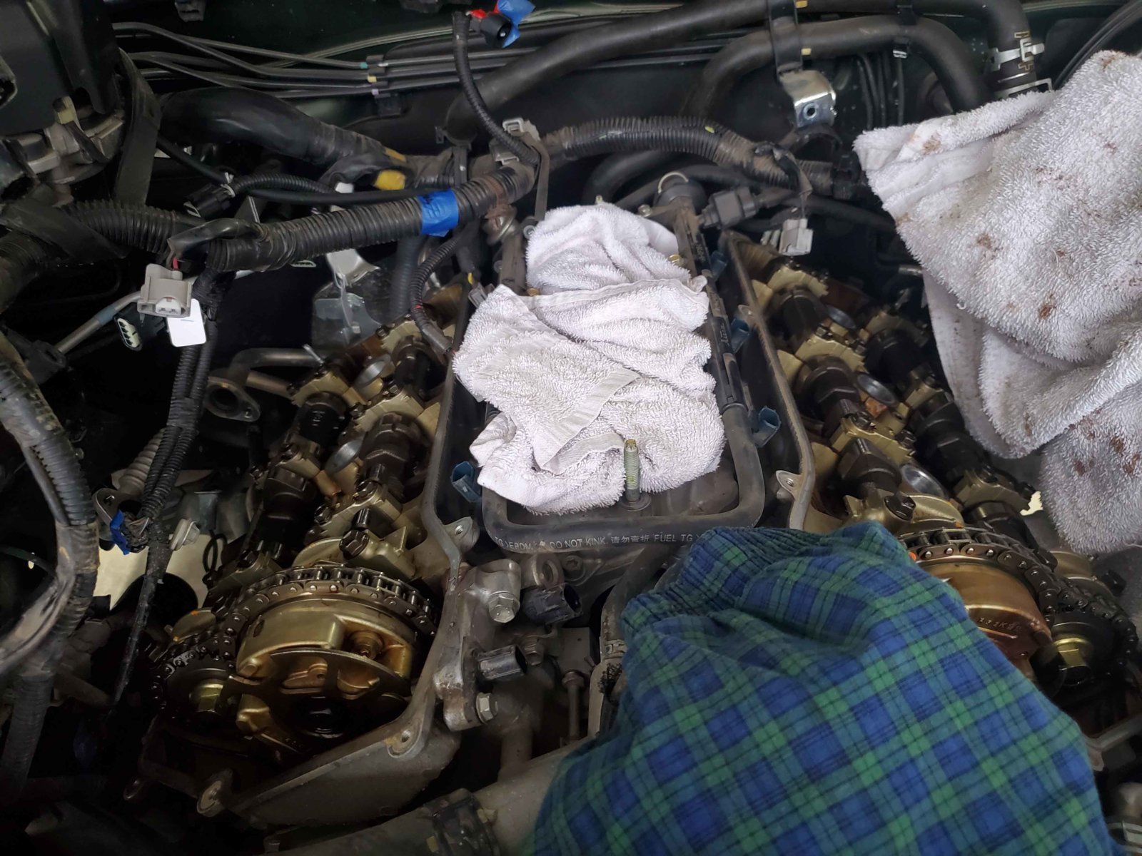

    OK, I'm there with removing everything. Couple of questions:

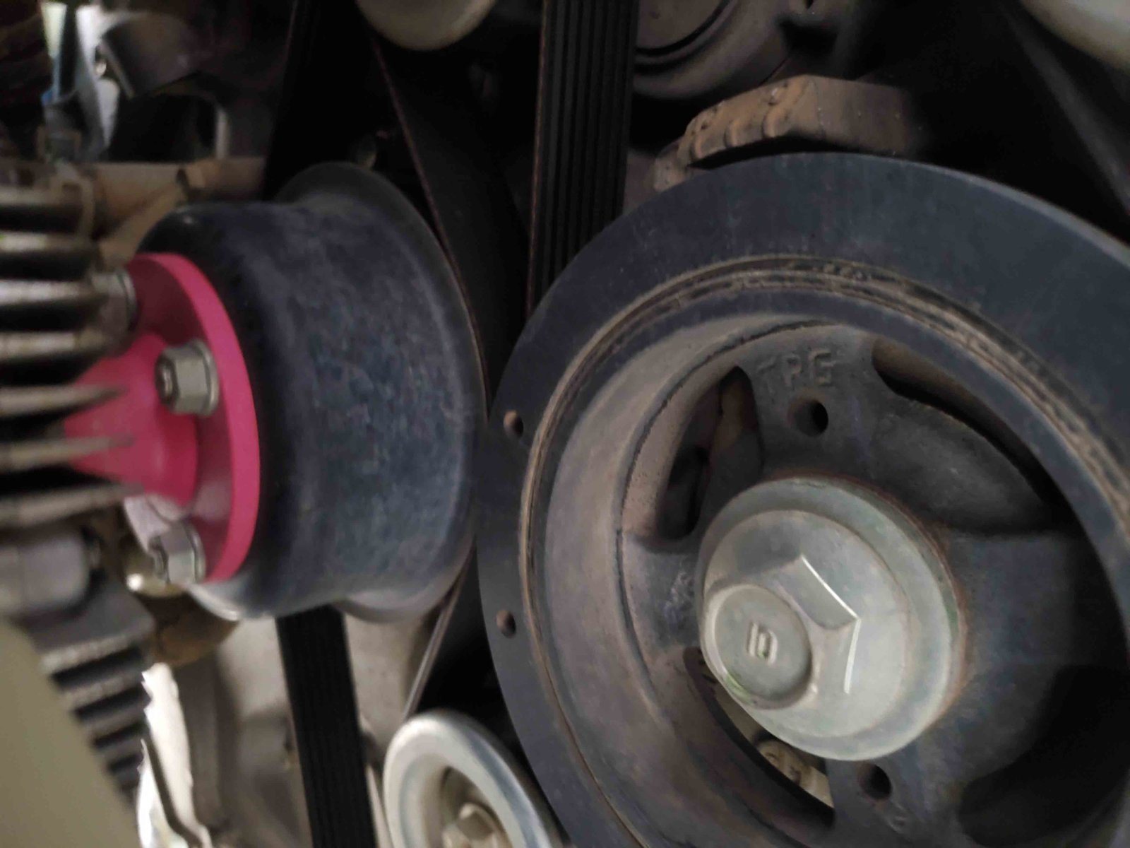

    1. Have two indentations on the flywheel. Do they indicate anything?
    2. Broke one of the locking mechanisms on this plug. Hope that won't cause any issues.
    So guess at this point I just start rotating the engine till everything lines up?
  16. Feb 22, 2024 at 1:27 PM
    #2116
    mightytacoman
    mightytacoman [OP] Mighty-known Member
    Apr 3, 2013
    #101270
    2,412
    Kel
    4.5L 1grfe
    Brian Crower stroker kit, Carrillo pistons moly/ceramic coated, BC sportsman rods, arp s2000 head bolts, Darton M.I.D sleeves, Kelford race cams, Magnusson supercharger, hp tuner tuned, 650cc flow matched fuel injectors, CSF radiator, Walbro 255 fuel pump. pulleyboys quick change pulley with 2.3", fpr mod, NST crank, water and alternator pullies, 160° mishimoto thermostat. Puma On-board air, Radflo CDC ext coilovers with 14" 700# springs, extended length rear Radflo shocks with CDC, Dakar leak pack, Brute Force Fab front bumper galvanized and powder coated, DTRL mod, yellow fogs, fog anytime mod, relocated rear differential breather, synthetic fluids, custom airbox, tundra sized intake. 76mm throttle body, secondary air filter removed, Airflow snorkel, 4x innovation sliders powder coated, URD equal length headers, DT y-pipe, Aero-Turbine 2525xl exhaust dumped over axle, seat belt chime disabled, Warn 8000i winch, 1- 20" slim light bar in grill, 42" curved roof light both with custom brackets. Mesh grill, Brute Force Fab rear bumper with extra reverse lights, u bolt flip kit, SS extended brake lines, hockey puck bump stop extension, AT shackle flip kit, Light Racing UCA's, 4crawler 1.5" bodylift. custom built front and mid skid plates, re-geared to 4.56s, windows tinted 25%, Sony stereo, 8" skar sub-woofer, 1000 watt mono amp, retrofit headlights with legal demon eye, Kryptek Marathon seat covers. North Star agm 27f battery, Helo 791 rims, 315/75/r16 Mt/r ARB front air locker
    1 indications mean nothing for this job. You should have a timing slit in it if you're trying to get timing by it but i don't recommend that method.
    2. Fingers crossed it won't matter.
    3. Yes- turn over till things line up.
    4. Disconnect battery if you haven't yet

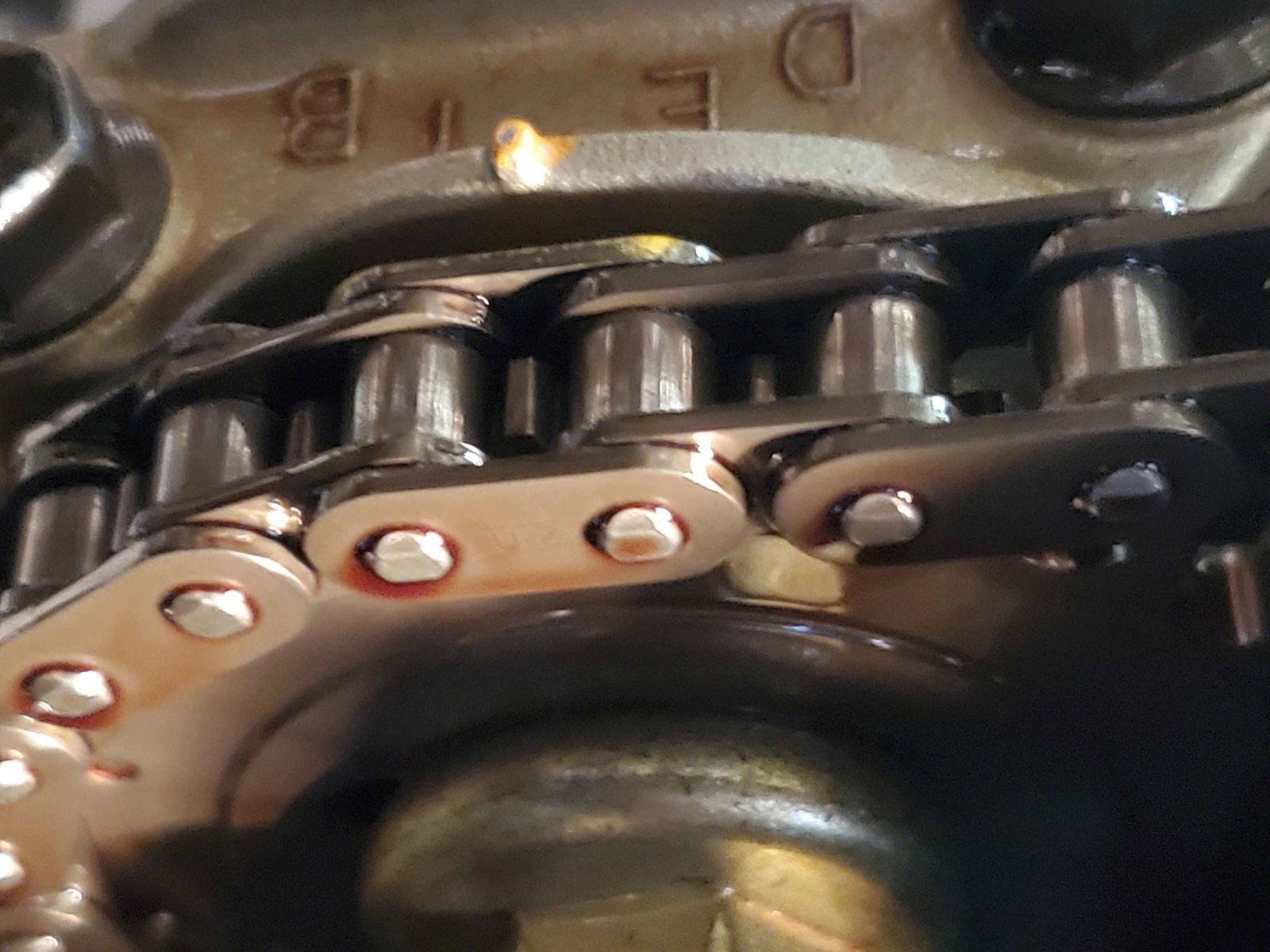

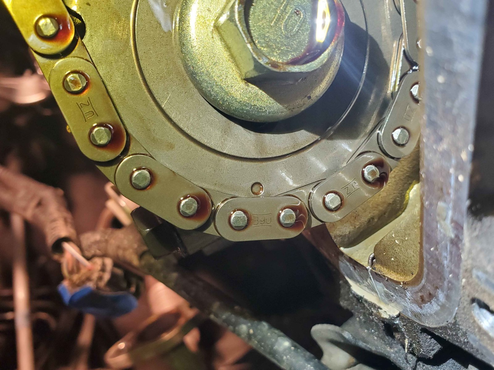

    A Crap Load

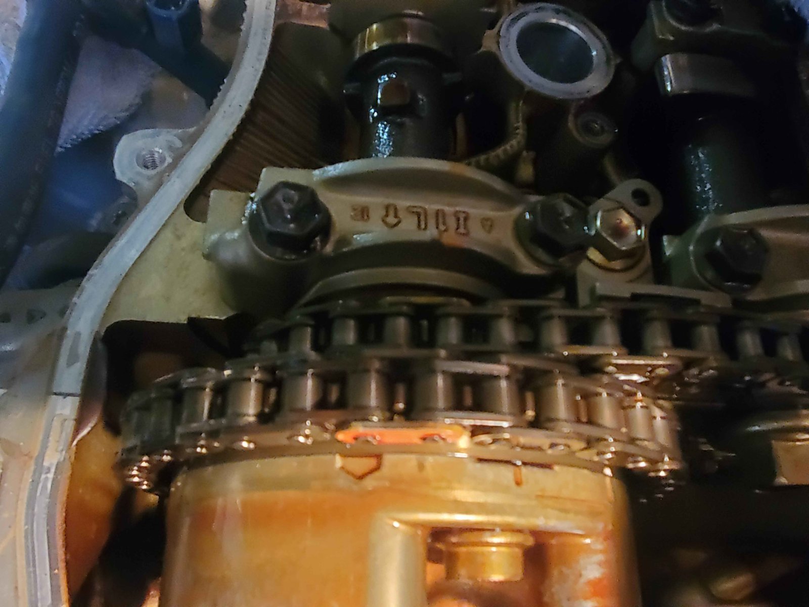

    Battery definitely disconnected. Gonna start turning.
    So how does this look?

    John,
    You are overthinking this.
    Spin the motor to get the alignment mark on the cam gear up (as close as possible, to be easy to see and access) and mark the link at the alignment mark. Pull the stock gear, replace with the new gear, lining up the mark on the link with the alignment mark on the gear. You may need to "adjust" the cam position slightly (backwards) to accommodate the 3* retard of the new gear.
    You're not retiming the engine, only replacing a gear - in the same position.

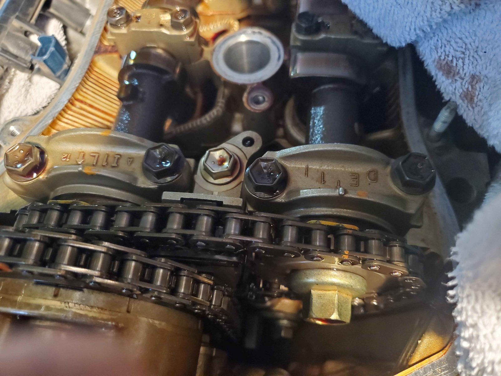

    A Crap Load

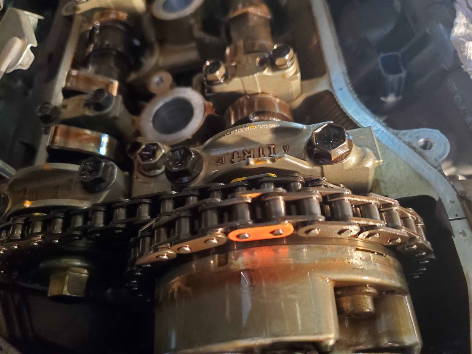

    Yep. So if I advance the engine a bit more both of the dots should line up at the top (they are both in the same relative position), mark the links and insert new cam gears?
  20. Feb 22, 2024 at 3:23 PM

    Advance till gear mark is on link. Mark the link. Then go for it
