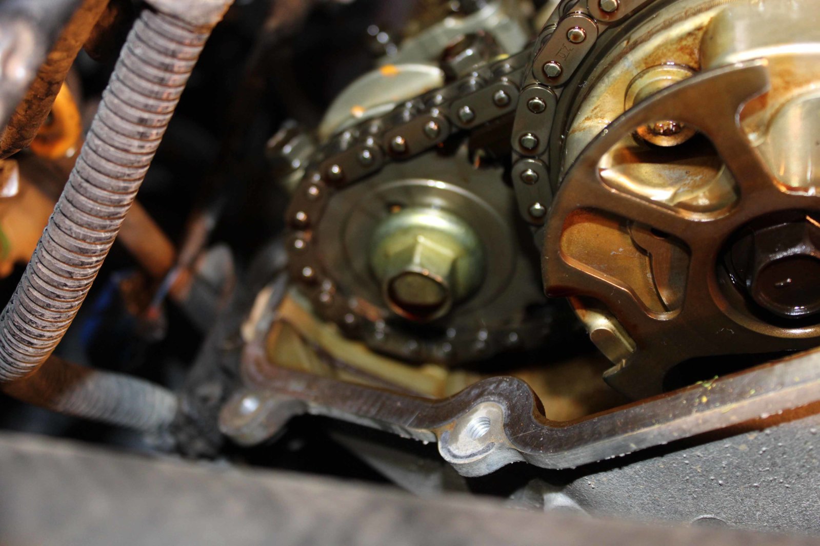

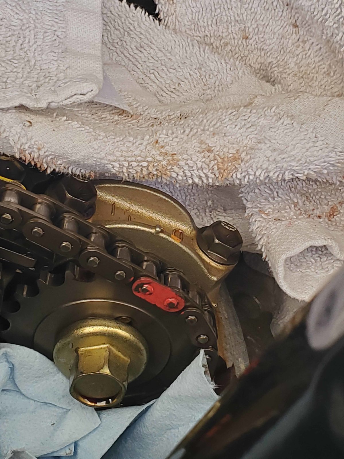

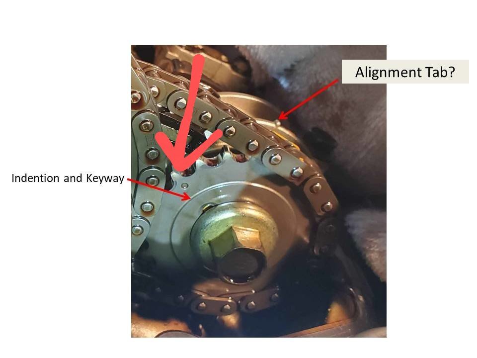

    So I advance the engine till both keyway's and indention's are in line with the alignment mark (or the tab sticking up) then mark the links and replace the cams?

    That dot on the sprocket is the one you want to align with the alignment tab on the head that is referenced.

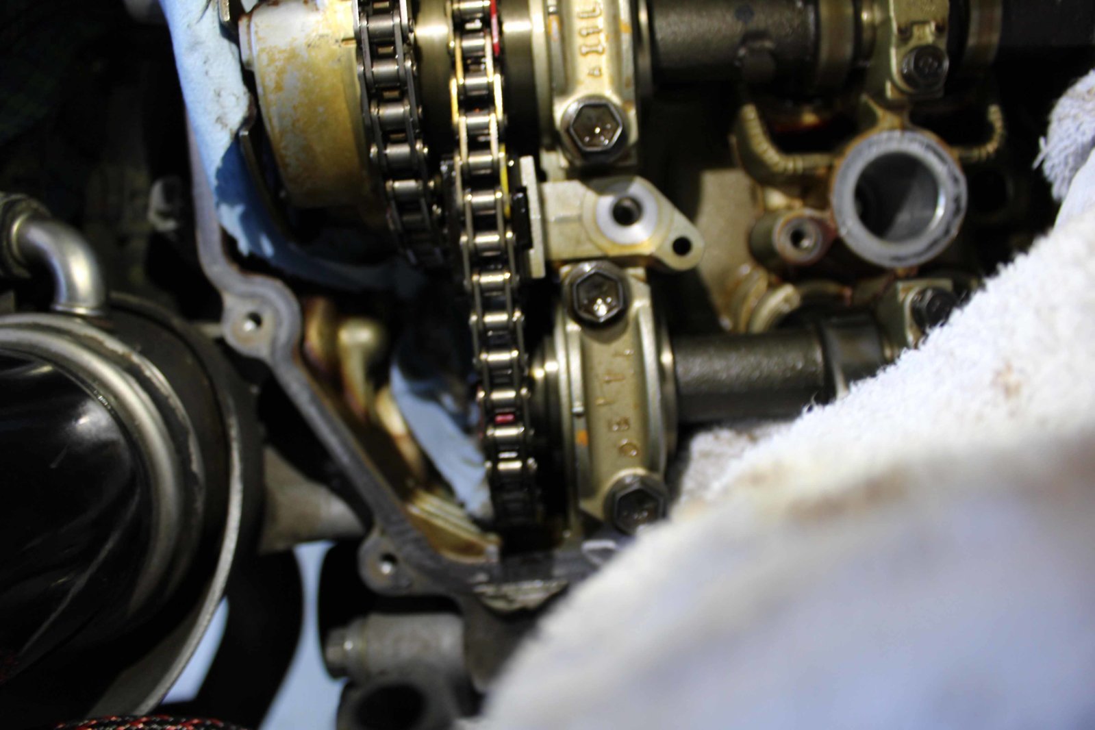

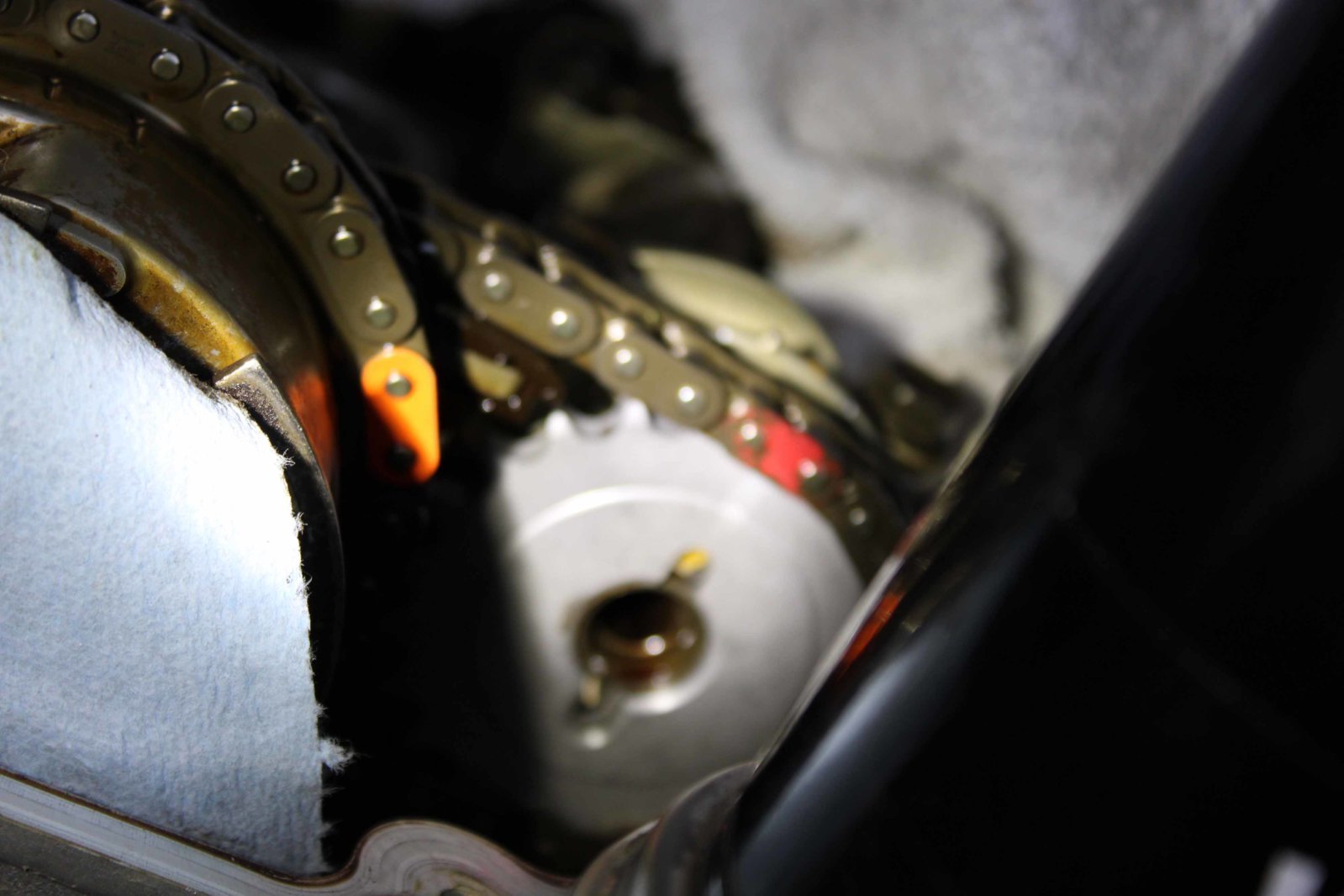

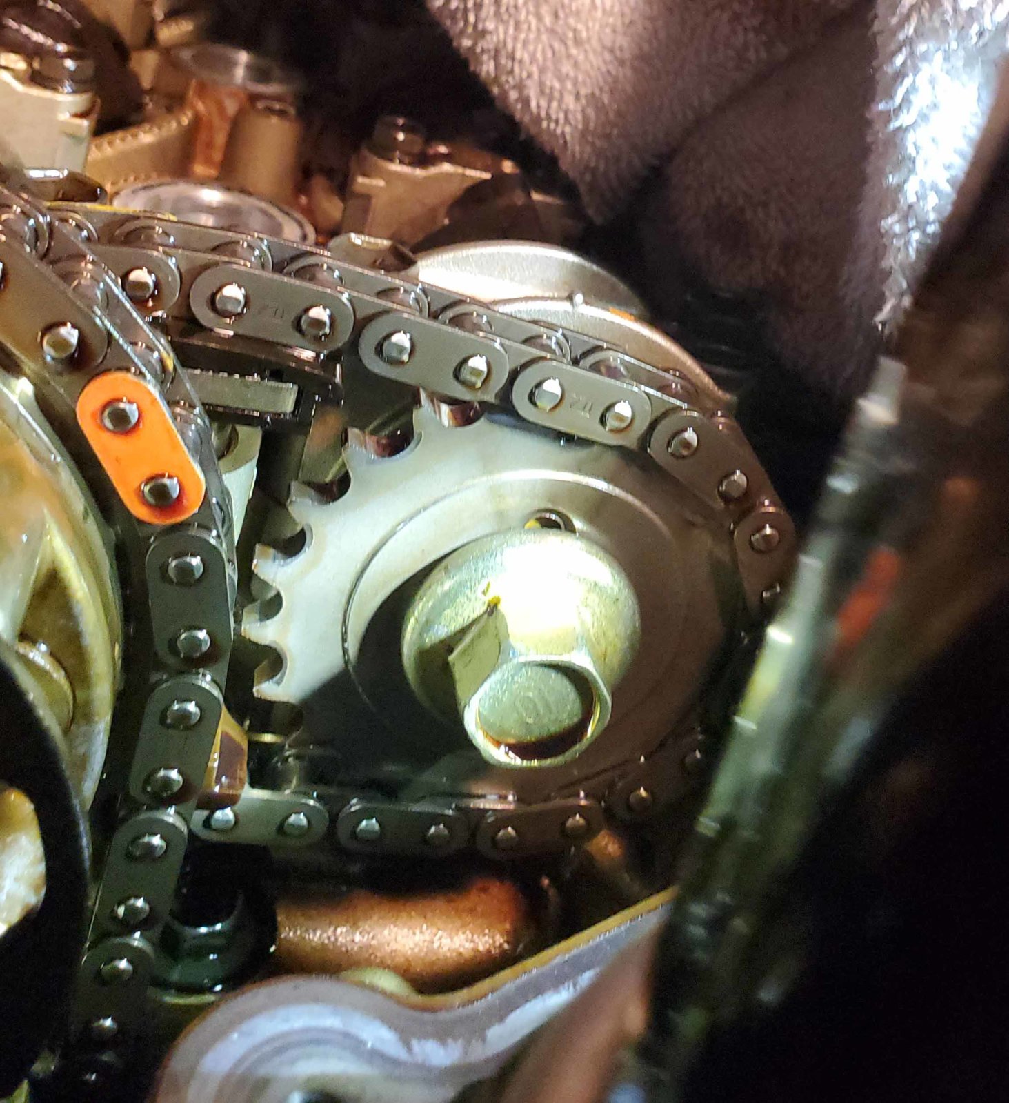

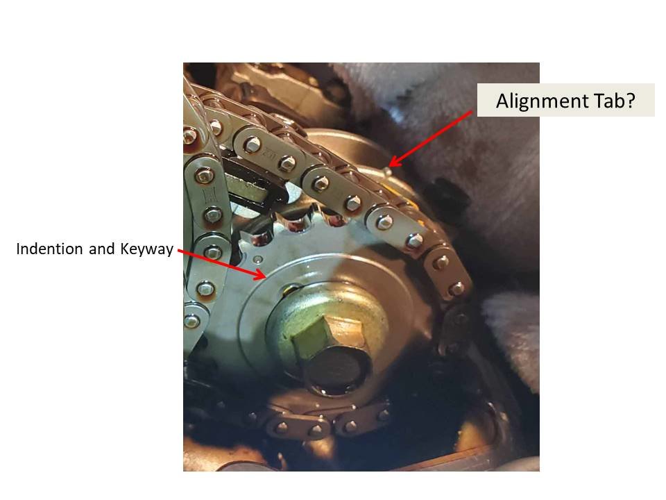

    Think they are lined up right now.

  4. Feb 22, 2024 at 4:11 PM
    #2124
    VoodooBlueATL
    VoodooBlueATL Well-Known Member
    Jan 9, 2018
    #240775
    171
    2007 FJ Cruiser
    There you go. Now mark that link, remove the sprocket, and align that link with the new sprocket.

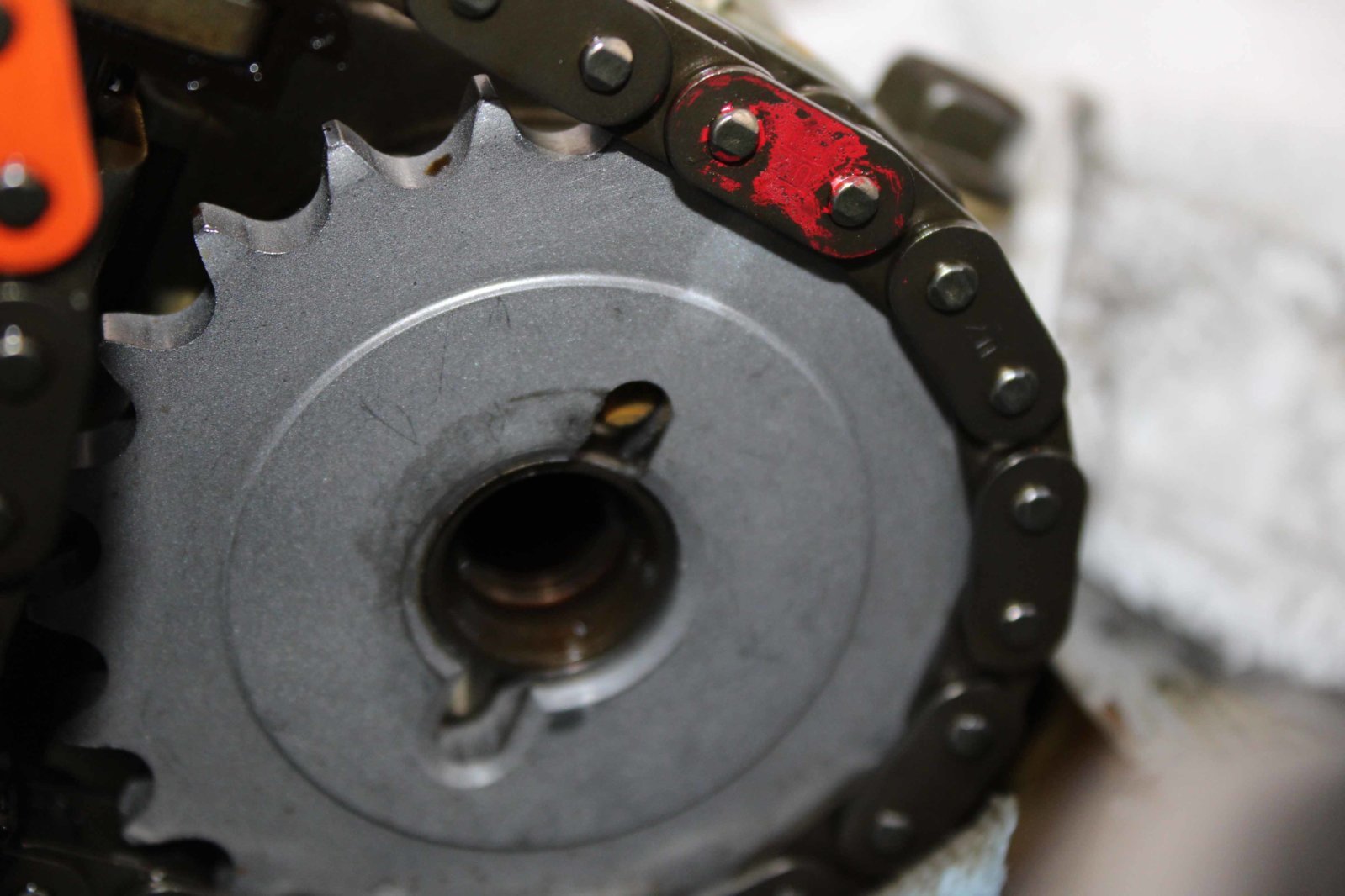

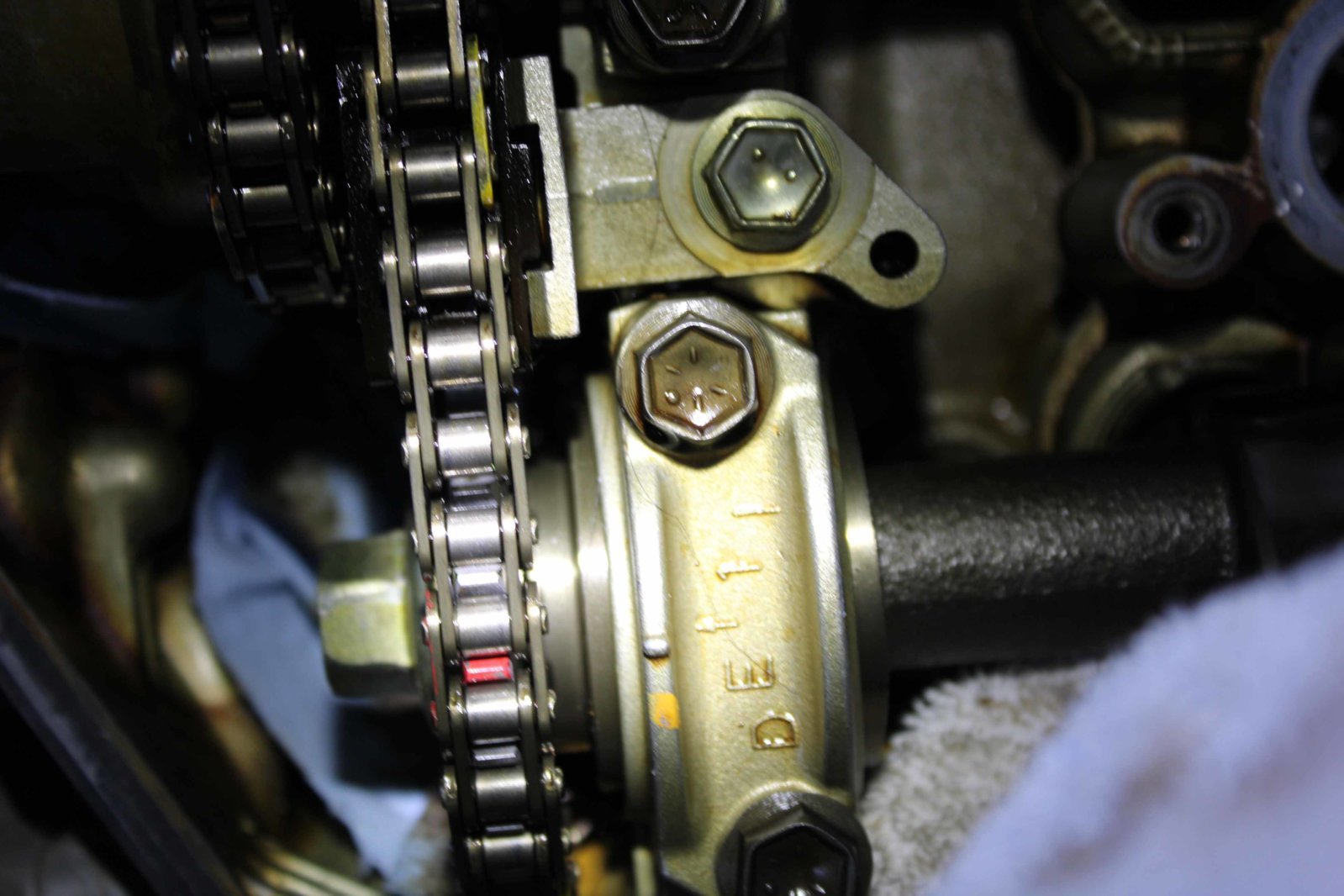

    Last pic and signing out for night. These are obviously marked right with the correct sprocket to be inserted. Will send you a pic tomorrow once I have them in.
    Many, many thanks to you all for your help.

    Mark the link and stuff a paper towel down in the hole. Then break out the 17mm and 24mm and pop that sucker loose.

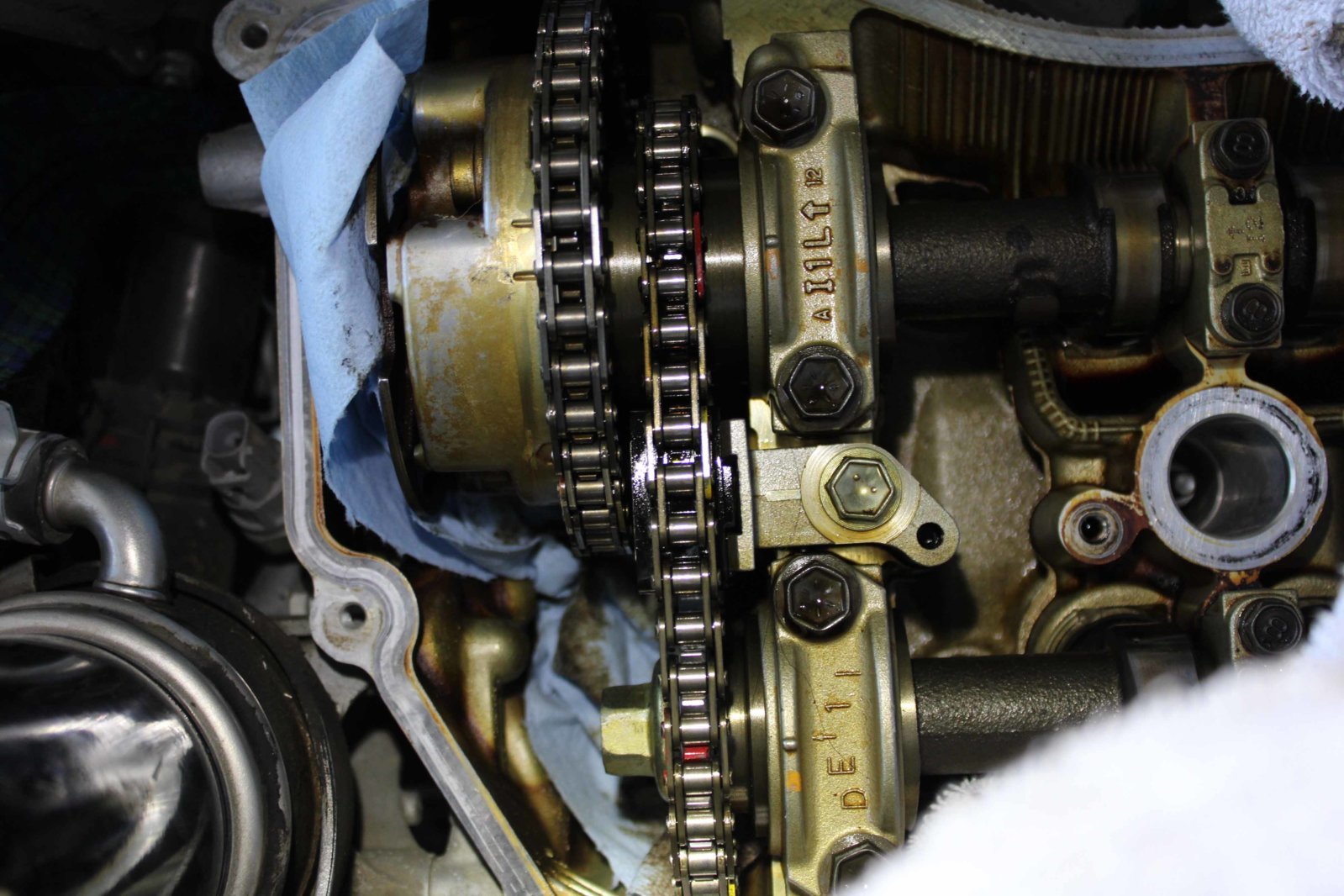

    OK, cam bolts are loose. Moved link just up to edge of timing tab. Am I still good to go to replace the cam gears? Read I am not supposed to turn engine counter clockwise but can you move it just slightly to adjust if necessary?Cam Loose.jpg

    Stuff a towel into the dead space, Pop the nut off- wiggle gear out. Replace and you're done
