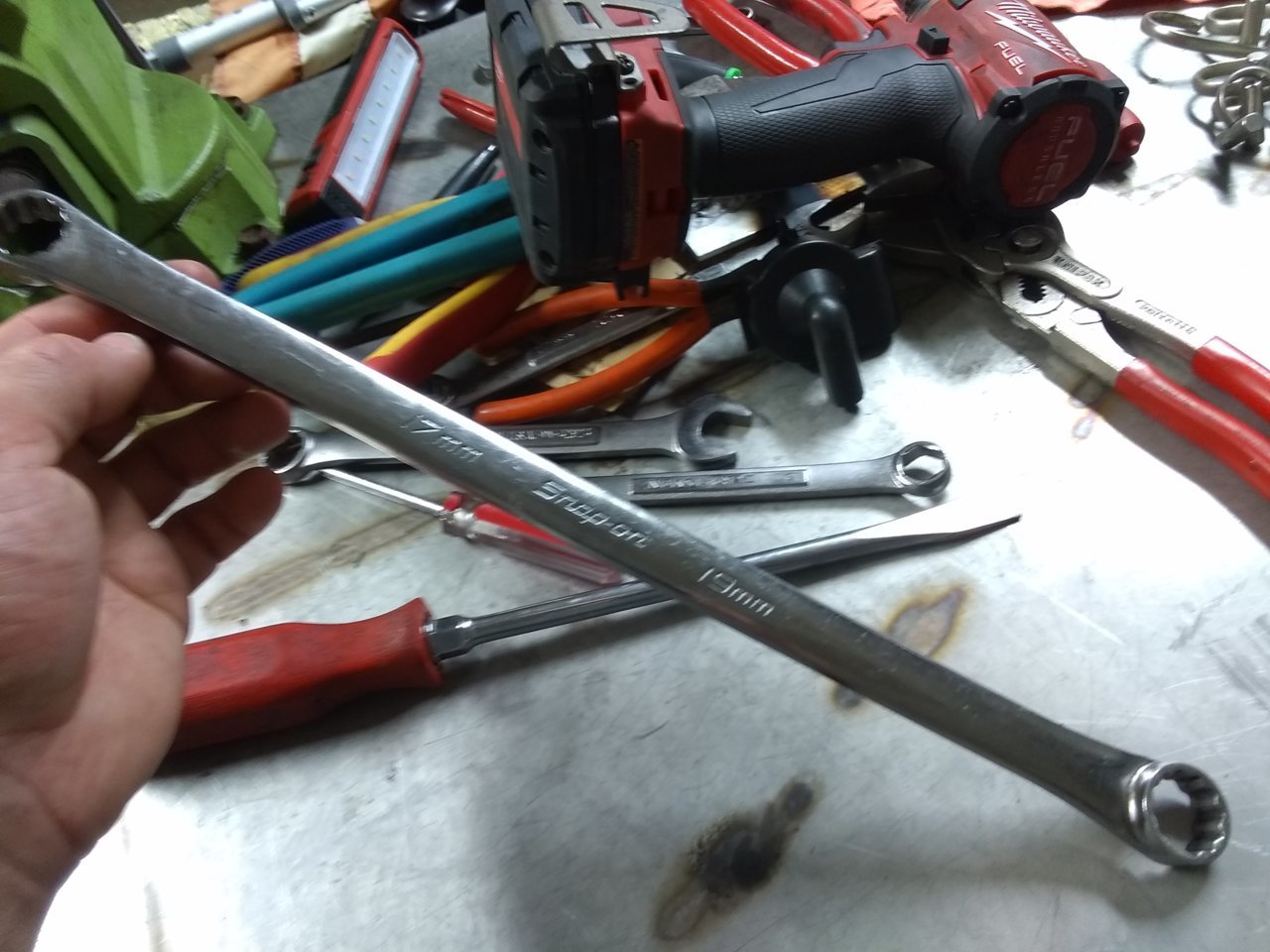

    This works great. Won't deflect like an open ended wrench.
