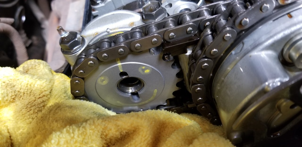

    Almost got em! Well, I know you guys said the cam bolt was on there pretty good, but geeeeez! I also noticed during the procedure that I did not have a 24 mm wrench!

    First pic I seen of that side ????? no mark on chain ???? So the top dead center chain mark is only on the the other side ?
    This engine is all new to me ! (old chevy guy ) Forgive my ?????? I have my gear set , Just need more Info ? Thanks
    Update I see yellow paint on link ???
    deeezy likes this.

    Yes, both sides had a painted link. I had to rotate the crank quite a bunch to get them lined up. I also tried using a craftsman flare nut wrench for the cam bolt and it couldn't do it. It started to deflect and was ready to strip. I used a box end wrench instead.

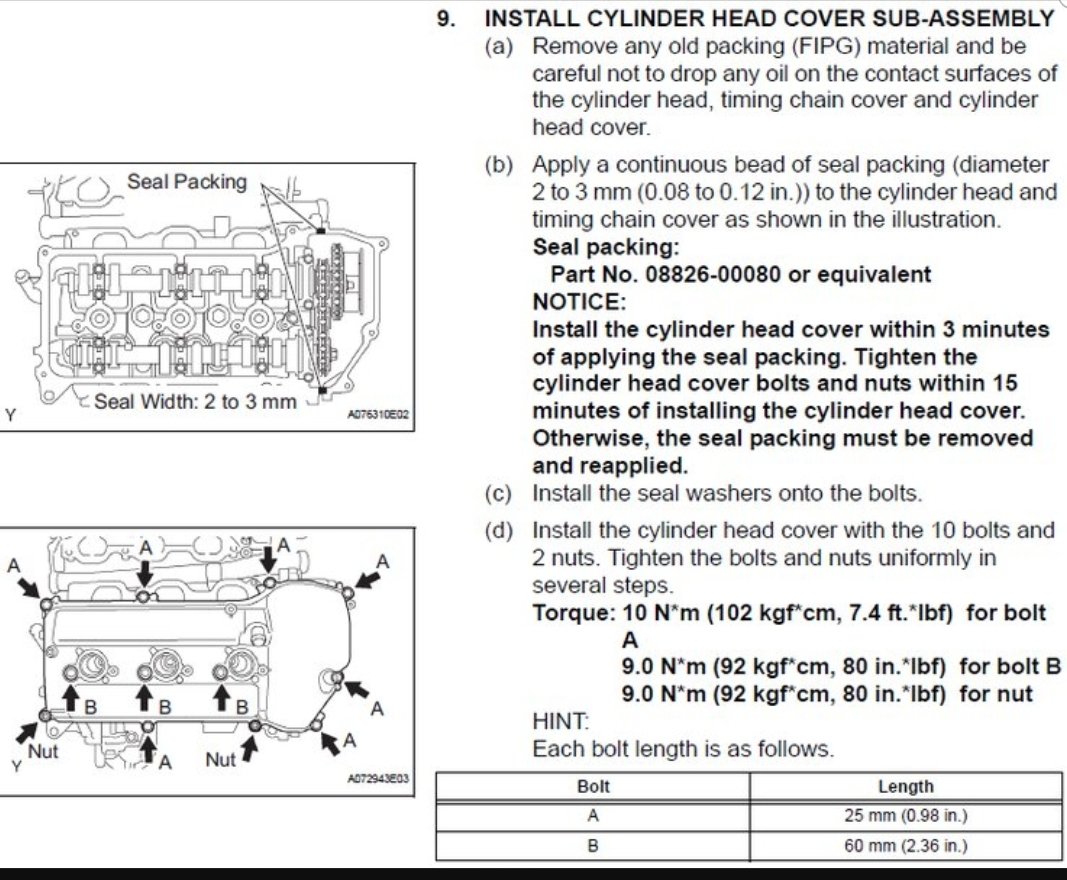

    Also, make sure you apply some fipg when assembling the valve covers, or I used Permatex Ultra Grey, at the areas shown in the upper diagram (seal packing). There is an uneven area there that will leak oil if not.
    Edit: I was able to torque the cam bolt using a crows foot.
