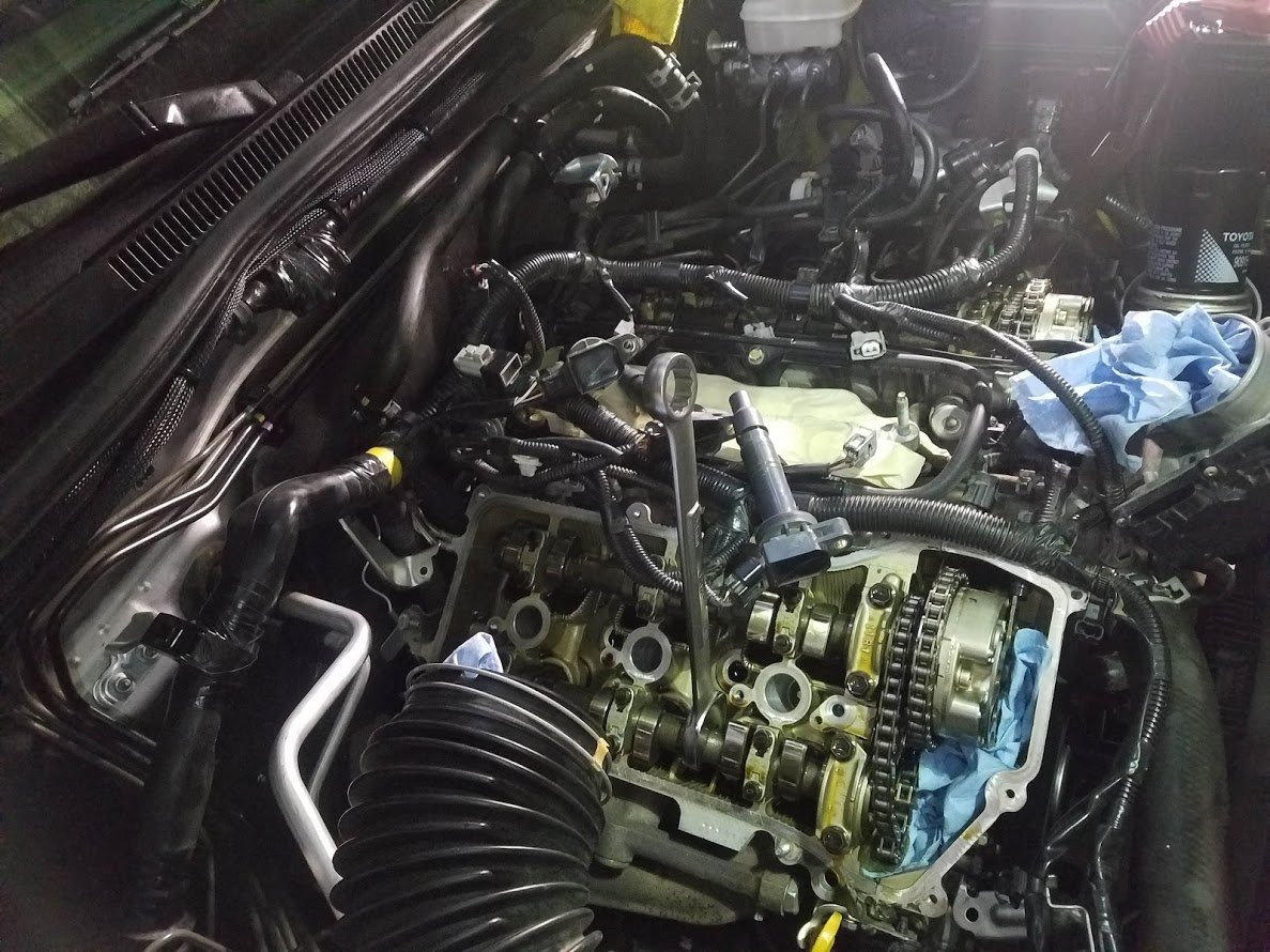

    Knocked it out. Now I'm retarded.
    Truck runs good. Need to data log and send the file to Justin to have it dialed in, but I am happy. Thanks Kelby!
    x4woc_M3f_8ZE6XKPz7Ulmp5bEf7JB5HPj9prf7b_34ded831b43626a55fd1e5e953f2f86bced399c3.jpg
    A couple things to note:
    -Due to intake cleaning, MAF and throttle body cleaning and maybe having the battery detached for 5 hours, truck didn't start immediately. In fact, it took 5-6 attempts with me running around crazy trying to troubleshoot and see what I forgot to attach in between attempts. It scared the bejesus out of me, but no codes, everything I could see was put back together right and then it finally sputtered to life. Whew!
    -I didn't remove the spark plugs. Was able to get to TDC just fine without taking them out
    -BFCB (Big F&#$ing Cheater Bar) over the 17mm wrench broke the cam bolts loose just fine.
    -If I had to do it again, I would remove the oil filter for more clearance for torqueing driver cam bolt.
    -I planned on 5 hours. Got most of it done in 4, but with MAF, throttle body cleaning, shop clean up and organizing the tool bomb, along with trouble-shooting the slow start-up, it ended up being darn close to 5 for me. As quick as things went in the first 30 minutes, though, I thought I'd have it done in 2 hours, but there's a lot of plastic clips and fasteners to figure out how to remove, old FIPG to clean-up, and also...
    -F$#@ that little 10mm bolt that holds the heater hose support bracket to the plenum. F$#% it right to death.

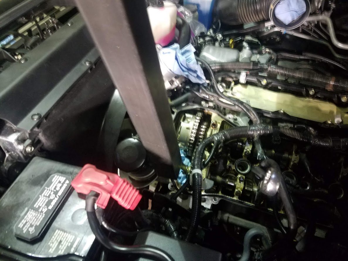

    I used a 3 foot cheater...
    POP!
