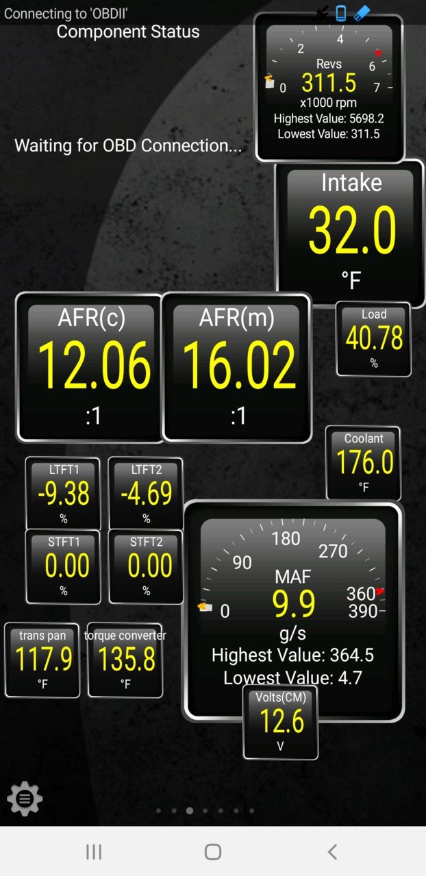

    Glad to hear it buddy. Ya I'm supercharged, running tons of boost and many other power mods.I don't expect everyone to gain 20 but gains should still happen. Before the gears I never broke 350g/s. I've since logged 368g/s several times but haven't broke 370... Yet. Pic attached is 364g/s but only ran it up to 5700rpm.

    So simple equation will tell you how much power those cam gears have made. @Roostfactor, what was that MAF number multiplied by? 1.15? Something like that?
    That's around 23 HP. We'll see what the number is when Roost or someone else chimes is.

    That's the multiplier I have always used on these trucks. That's crank hp I do believe

    It I at the crank, but still just as worthy a gain. ~20 HP is 20 HP.
