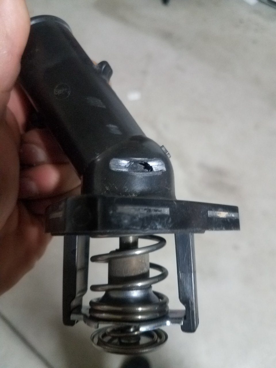

    Sign me up as a new member of the cam gears club!
    It was a long winding process and there were like a million bolts, but I got 'er done, screwed my OE thermostat and had to go buy an emergency t-stat replacement, so looks like I'll be getting a Mishimoto 160 thermostat tomorrow. :)
    A couple notes.
    - Finding number 1 was stupid easy. Once your marks are aligned and everything is at TDC, mark the link which the cam will be going into the center of.
    - If using @mightytacoman modified OE cam gears, make sure you mark the cams prior with an F for the front and an R for the rear of the cam. At the front of his cam you will notice one of the mounting locations is elongated, that is the side you want to mount face up. Draw a line so you know exactly where center is. This will help IMMENSELY during installation.
    - Make sure you do your workouts before breaking the exhaust cam bolt. It will be incredibly hard to break free even at 100K and you are best suited using the help of a friend to hold the intake cam while you break free the exhaust cam bolts. I broke mine using a 17mm box end wrench and a 3 foot breaker tube placed over it. It was still hard, but eventually snapped loose. :)
    - Make sure you buy valve cover gaskets, a spare thermostat, coolant and oil all as just in case items. You don't want to have to run to the store while you are doing this, especially if it's your daily driver. You will end up like me earlier tonight if you are unprepared.
    - After reassembly feel the burn! I haven't even been retuned and I feel a nice power gain starting at about 2500 RPM instead of 3200 like it used to, and the idle is much smoother now due to the now more complete burn.

    Thanks for the review and your impressions buddy! How did you manage to damage your thermostat in the process though?

    It got dark by the time I was finished with the work. I was limited to only the light of my flashlightand when I mounted the supercharger belt all of the routing looked okay but I happened to miss that one point by the thermostat and one of the bolts and I ended up somehow making the belt ride in close proximity to the thermostat so the damage ensued only seconds after I started it.
