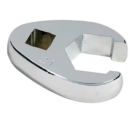

    Sorry for all the questions :D. Is the reason a normal socket and torque wrench won't work because the camshaft bolt sits at or below the lip of the cylinder head? I have a set of crowsfoot that looks like the one in the attached pic. Would that work?

    Yes, and such a crowfoot (17mm) will work to torque it back down but not for removal because it will probably shear and then you get to fish all the bits out of your motor

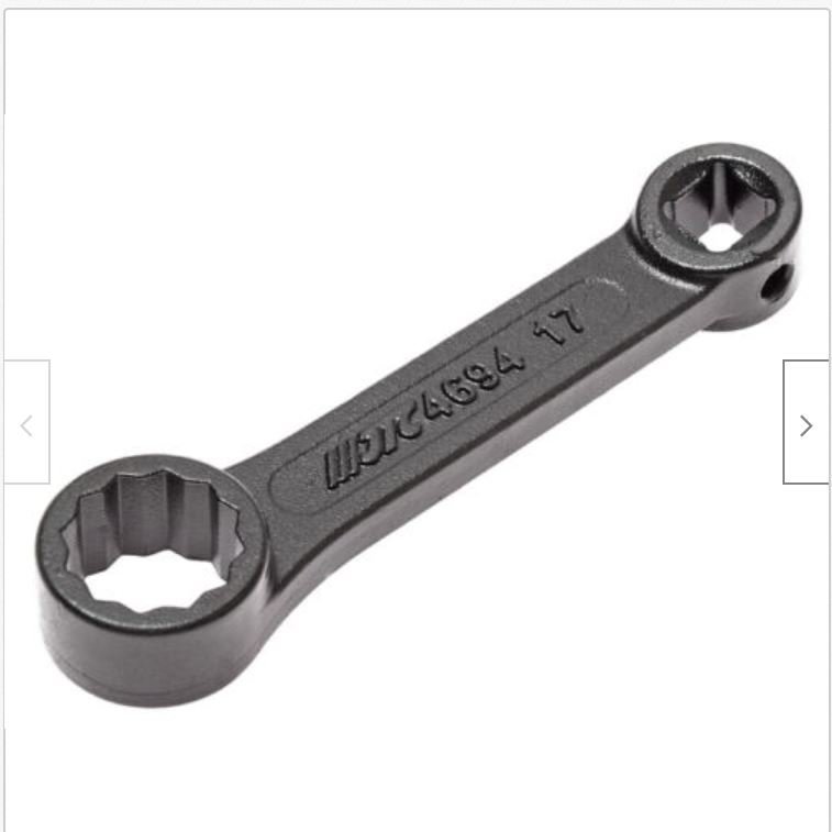

    For the other guys who are looking, I just found the 17mm offset tool on ebay. Apparently, they're made for Mercedes Benz engine mount bolts.
    JTC MERCEDES Benz Engine Fixing Screws Wrench (17 mm) JTC Tools 4694 Patented.
    https://www.ebay.com/itm/JTC-MERCED...hBBEV1Demotion&_trksid=p2047675.c100005.m1851
    JTC On Amazon, but you have to pay shipping:
    https://www.amazon.com/ENGINE-FIXIN...r_1_2?keywords=jtc+17mm&qid=1585350944&sr=8-2
    Also one sold by KTC tools
    https://www.ebay.com/itm/Mercedes-Benz-Offset-17mm-Engine-Mount-Wrench/254515752560?epid=1052544345
    KTC on amazon, but you have to pay shipping:
    https://www.amazon.com/Mercedes-Off...ds=offset+socket+17mm&qid=1585350255&sr=8-156
