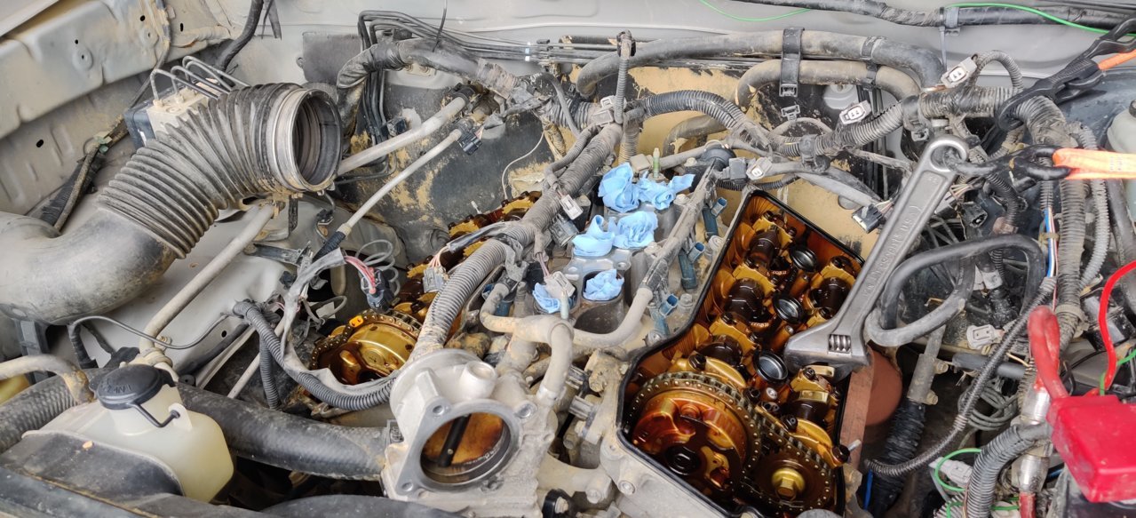

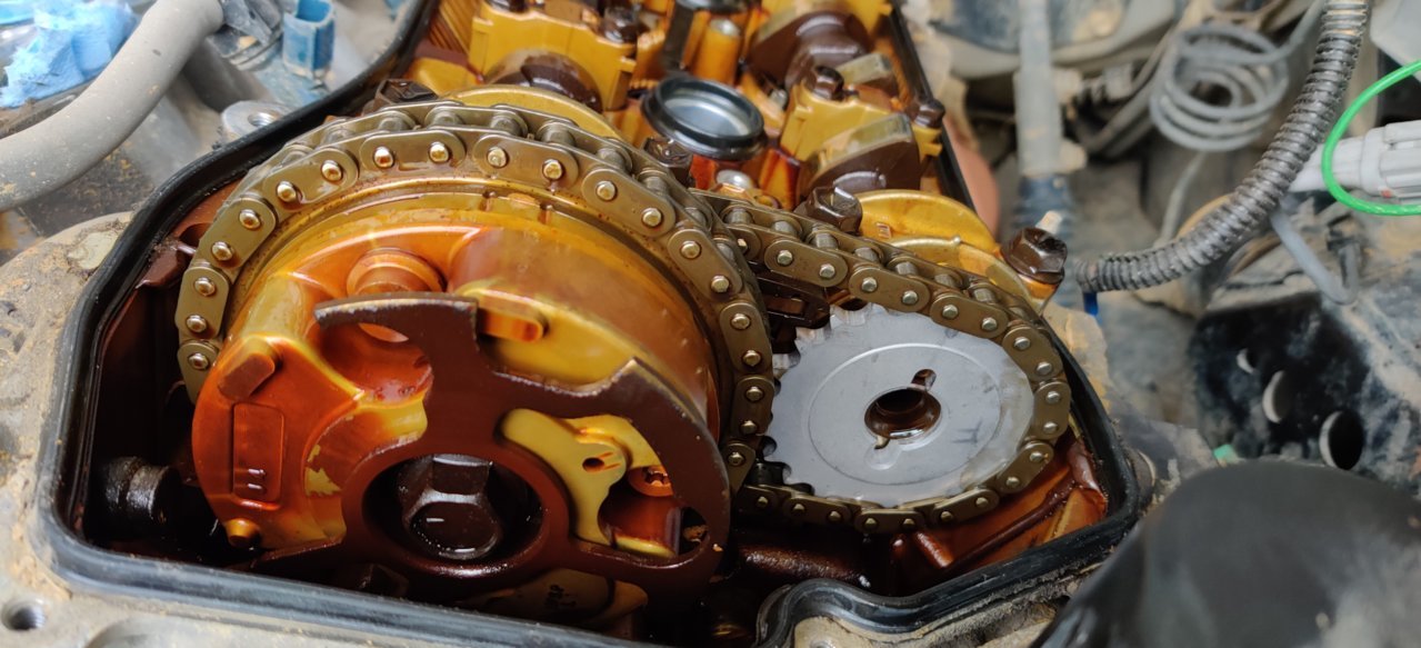

    Installed these today. That cam bolt was no joke. Used a ratcheting strap on a crscent and used a sledgehammer to whack the 17mm on the bolt. Came loose after a few tries. No issues aligning with timing marks and was straight forward. Install took about 3-4 hours with me taking my time.
    Overall impressions after < 10 miles:
    Increased pick up from highway/street speeds, engine definitely runs smoother. Haven't driven enough to really see how it performs through all gears and rpm ranges.
    One odd thing I noticed is increased smell of gas, probably from increased cycle efficiency from each stroke emptying more fully. I believe the ECU will relearn after a few miles and adjust trims.
    Happy with the purchase. Once I pair it with an intake manifold spacer I confidently believe the characteristics of the vehicle will dramatically change. Awesome awesome awesome. Highly recommend.
    No pics of passenger side as I got excited and installed it relatively quickly lol
