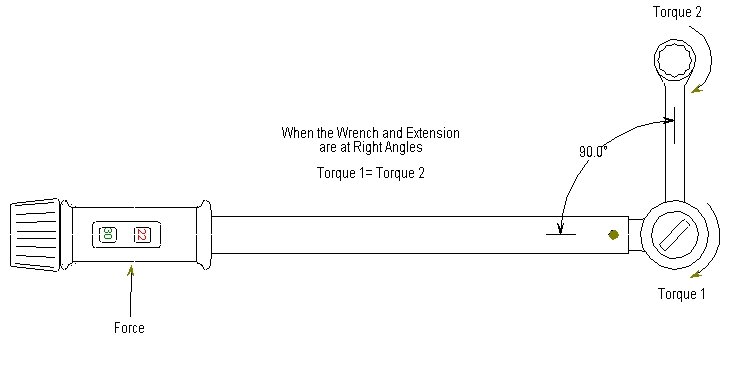

    I think I'd use a standard wrench with a snipe/breaker bar to break the cam bolt loose. The Mercedes wrench is very short and meant to be used with a ratchet or in this case a torque wrench to tighten to spec. A normal ratchet won't fit in the space hence the Mercedes extension piece

    fig_10c.jpgIf you adjust your torque wrench with the extension like this the torque value needed stays the same. Any other way changes the value and calculations are needed.

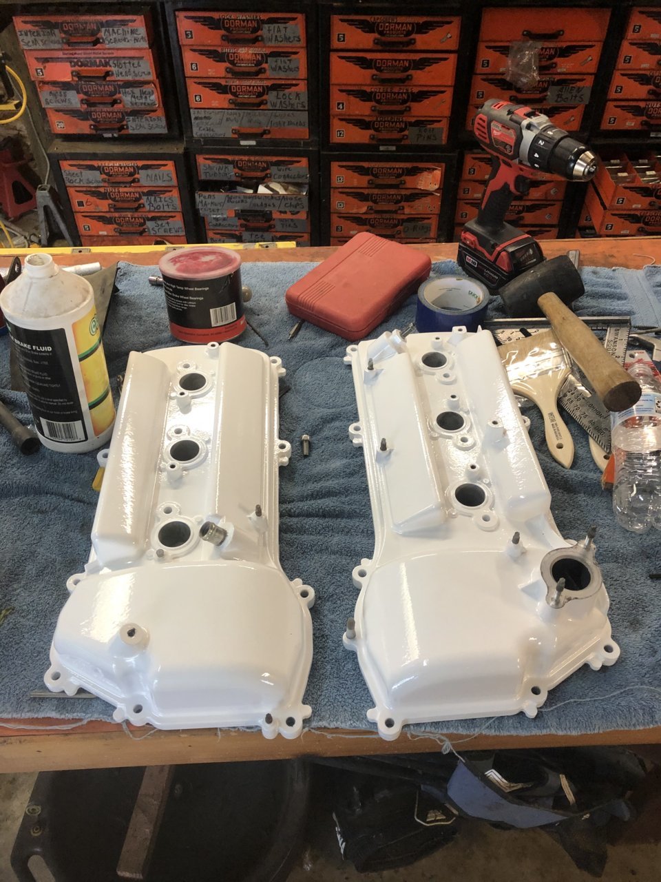

    24096A12-7223-4814-857C-87F8F5493212.jpg I have a plan in place for the SAIS
  12. Jun 19, 2020 at 2:51 PM
    #532
    nd4spdbh
    nd4spdbh Well-Known Member
    Oct 7, 2013
    #114055
    14,602
    SoCal
    13 DCSB TRD OR v6 Auto
    Those look good sir!
