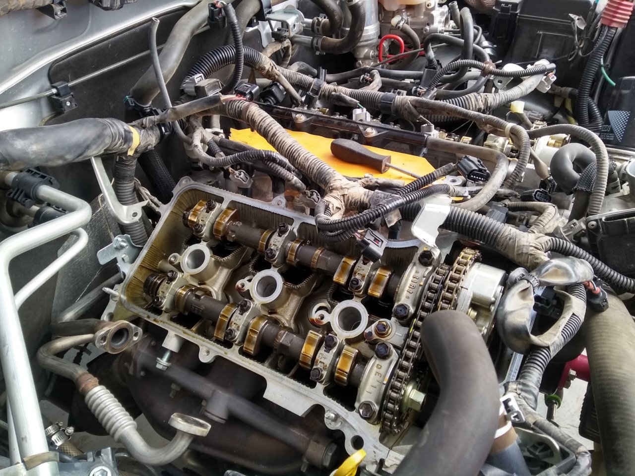

    Whelp they are in. It took a GOOD chunk of time (~5.5hrs), but I also work slow n methodical when it comes to stuff like this on my truck, as its my only 4 wheel vehicle and daily driver (i gotta few motos but still). I also had to deal with the 2012+ SAIS valve assembly, replaced all the gaskets, clean the throttle body, do a valve clearance check (all was spot on), as well as line up the intake manifold spacer when going back together. Also triple checked things cus paranoia, and a few beers with the GF while the process was taking place. Could I of done it quicker sure, but I wouldnt of been as at ease when I went to start it up.
    Things of note: All the driver side injector plugs need to come off. Only the front one on the passenger side does. For the SAIS valves, there are 2 nuts up top and one bolt on bottom that hold the assembly to the motor, the bolt on the bottom is rather hidden and can be accessed easily through the wheel well.
    Like others have stated undoing the cam bolts initially... GOOD EFFING LORD they were on there. A LONG handle 24mm paired with a doubled up 17mm and 21mm wrench was needed to pop it loose.
    The Mercedes benz engine mount 17mm with a 1/2in to 3/8 adapter was perfect for torquing things down. With my 1/2in HF torque wrench (calibrated with a digital torque adapter) which is right around 15in from center of handle to pivot, and the ~ 3.5in long benz engine mount thing, it calcs out to be 60ft lbs set on the torque wrench for the 74ftlbs at the end of the adapter.
    Got it all back together, n the truck started right up. Just drove it around the block as dinner was ready so no idea on performance differences, but the exhaust note has changed a smidge as well as she idles a bit smoother now! FYI i prepped yesterday and pulled the engine cover and fogged down the engine bay with the hose to knock any dust / mud / debris off things to have less of a chance of shit getting in the motor when opened up.

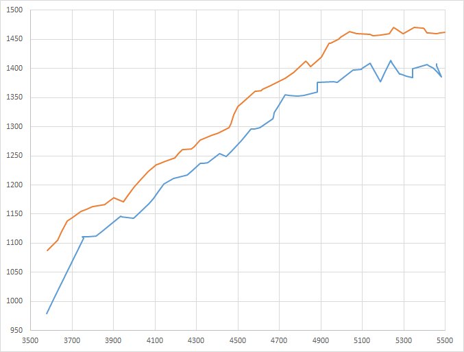

    Some data!
    Orange line = after install of 3* cam gears
    Blue line = stock cam gears
    Bottom axis = engine rpms
    Left axis = MAF reading in lbs/hr
    Stock cam gear pull and 3* retard pulls were done at the same air intake temps, same exact engine and maf tune, same trans tune, pull started rolling in 1st and the auto shifted to 2nd on its own (left truck in D), data below is from the bottom to the top of 2nd gear just before it shifted to 3rd.
    Your looking around 5% increase in MAF numbers!
    Truck feels happier for sure, and very curious as to mpg numbers over time.
    EDIT - Keep in mind, this is on a bone stock truck, stock exhaust, stock intake, stock throttle body with the ONLY addition of an XTP 1/2in intake manifold spacer between the lower intake manifold and the upper (surge tank).

    @nd4spdbh I love how detailed you are in your work. I remember seeing a post on the hptuners thread about a correlation between the maf numbers and horsepower. Do you recall this?
    Awesome to see this in a graph! Were you happy with the improved performance?

    Maf in g/s x 1.18 is generally accepted as the wheel hp for our trucks from multiple people performing dynos

    Butt dyno is hard to calibrate, and given so many variables as far as ambient temps / elevation around here its hard to get consistent logs, BUT it does seem happier thats for sure!

    Thanks for sharing! Great data

    How much help do you think the surge tank spacer helped with this outcome?
