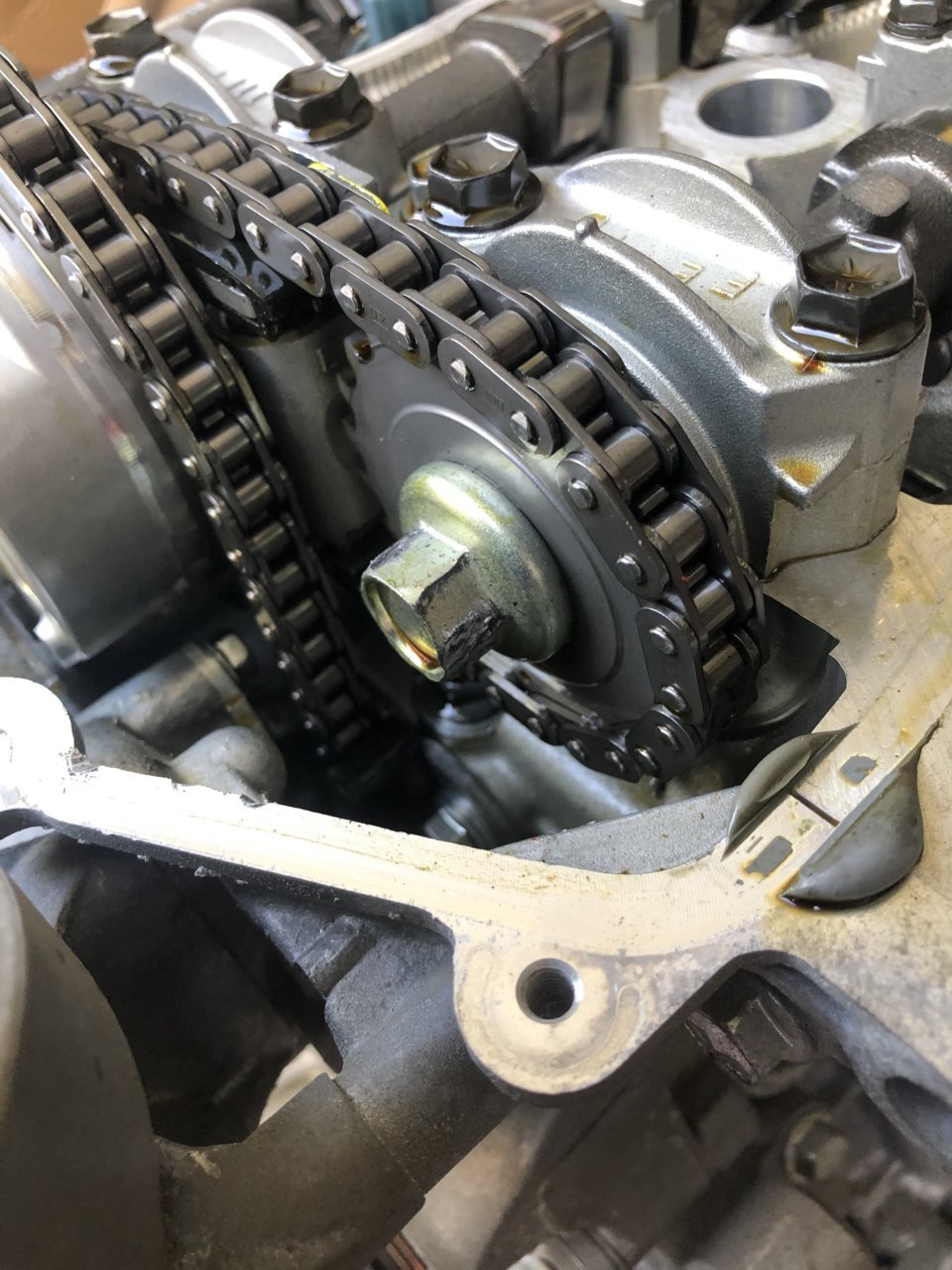

    Coeur d’Alene, Idaho
    How are y’all getting the cam gear bolt loose without Superman strength

    2015 DCSB SC M/T TRD Sport
    Cheater bar/snipe over the wrench (I used a chunk of abs pipe that flexed so much I thought it'd break but it didn't). Or double wrenching if you want to live dangerously. I tried it and I'm experienced with that trick and it still felt dodgy as hell but I was doing the job by myself. If someone is holding the cams steady for you it may go better.
    double wrench, wrench in a high lift handle as a cheater bar.. just chewing the bolt up

    My piece of abs was around 4 feet long. Definitely didn't experience rounding though. Maybe some PB blaster?

    08 4Runner SR5/ AKA The Great White Pig
    I did the double wrench method with my brother in law holding the cam with a 24mm wrench. Easy peasy. Good luck and keep us posted.

    I would recommend a 6 point 17mm at this point. Would suck to round that off more
    Might get the cheapest 17 wrench I can find, grind off the open end since it’s useless anyways, then use the biggest breaker I can

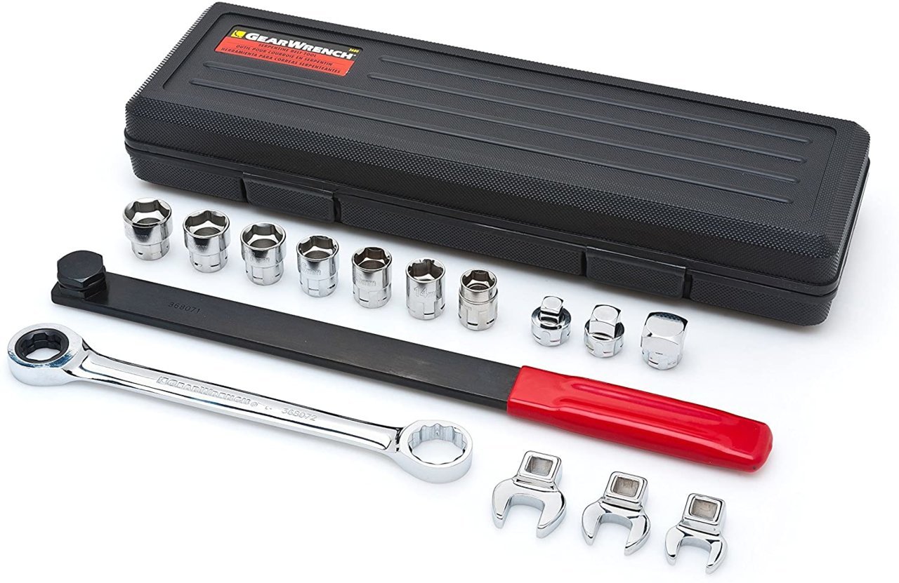

    This did the trick for me....Also works awesomely for supercharger belt tensioners.

    We used double wrenches and then put a hitch with ball mount to use as leverage and scary when it pops but because it’s heavy it absorbed the “pop” pretty good.
    Did you get it off?

    Nope nearest place to buy a different wrench is an hour and 30 minutes away so I’m just leaving it alone for a while
