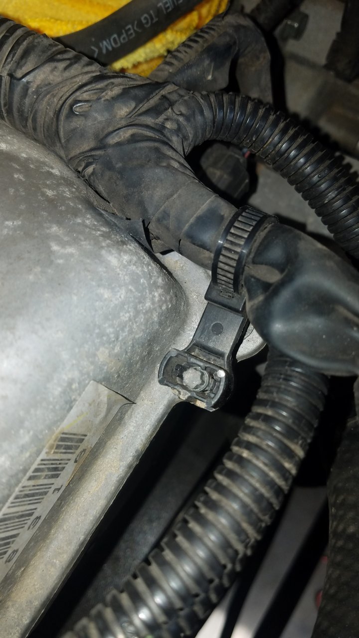

    I just pried them up with a screwdriver. Once they have been off the stud a few times they get much easier :)
