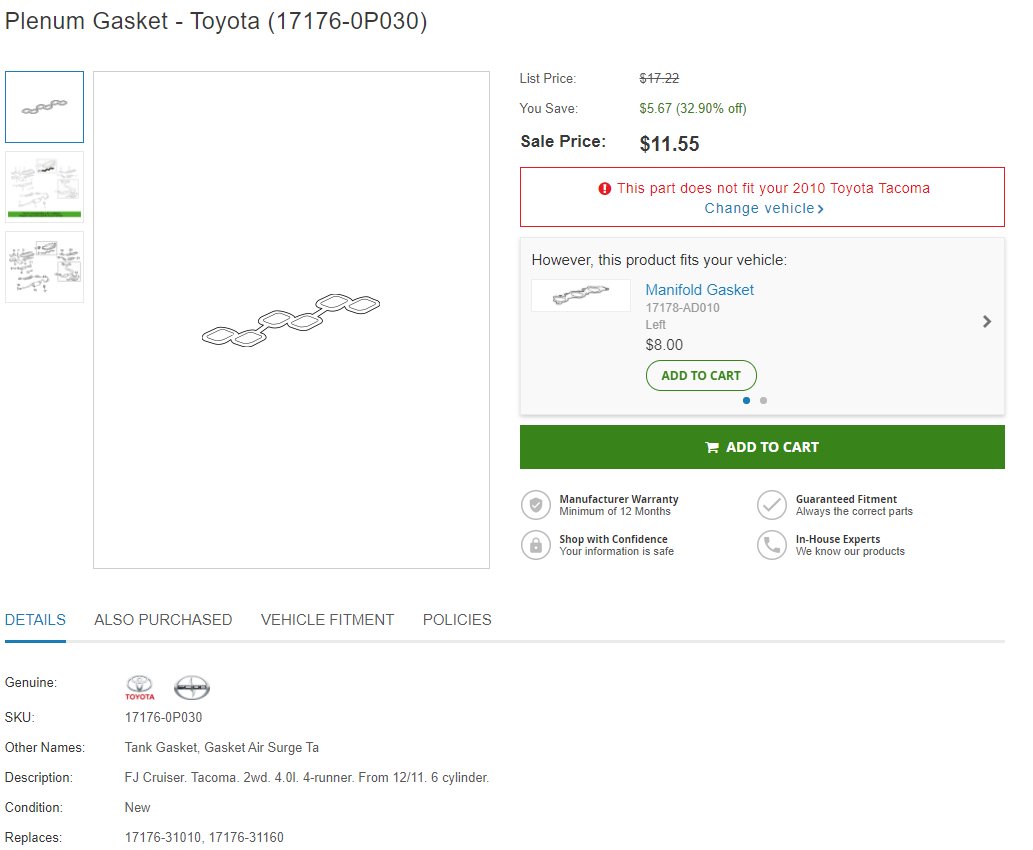

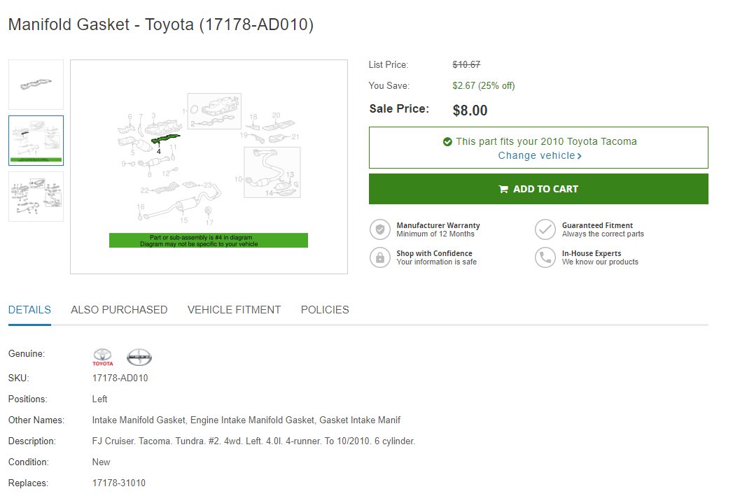

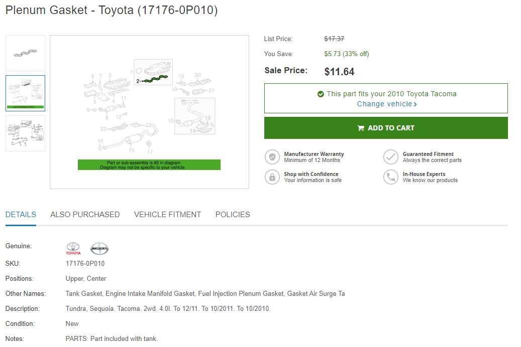

  11. Oct 1, 2020 at 10:48 PM
    #811
    fatfurious2
    Jun 28, 2014
    #132884
    48,604
    David
    Ashburn, VA
    2010 TRD OR Access Cab
    hey, just wanted to make a note here.. The part number above is showing for the 12+ Tacoma.
    I was adding up some parts, and for the v6, Mcgeorge Toyota Online is showing the below part number (for my 2010) 17176-0P010:
    Maybe because I dont have the secondary air injection?

    Added to page one. I'm 99% sure they are the same thing/part but added to avoid any confusion.
    ARoman83 and fatfurious2[QUOTED] like this.
