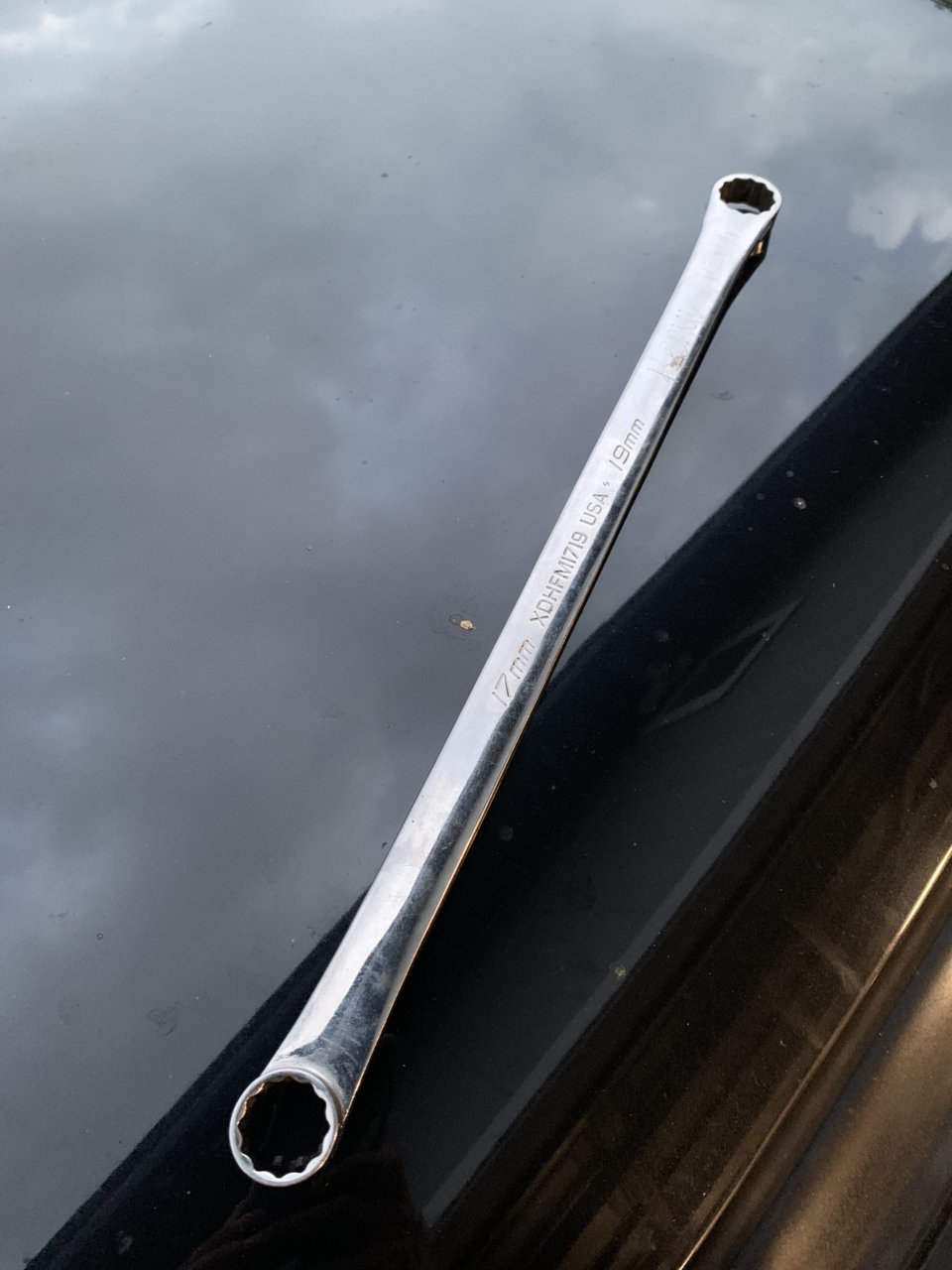

    Only thing you can put on that bolt is an open or box end wrench or a crows foot.

    TireFire

    Wouldn’t recommend trying to break it loose with a crowfoot. Solid chance that’ll break and take a deep dive into your motor

    Good call, I used the Mercedes Benz engine mount tool, worked perfect on my big torque wrench.

    Snap on extra long box end wrench works good for this if u need to add a pipe on for more leverage since no open end to cut off to fit a pipe on it. Hate double linking wrenches

    Yup, a crows foot will start flexing and slip and I'd give it a 95% chance of rounding off that bolt. lol

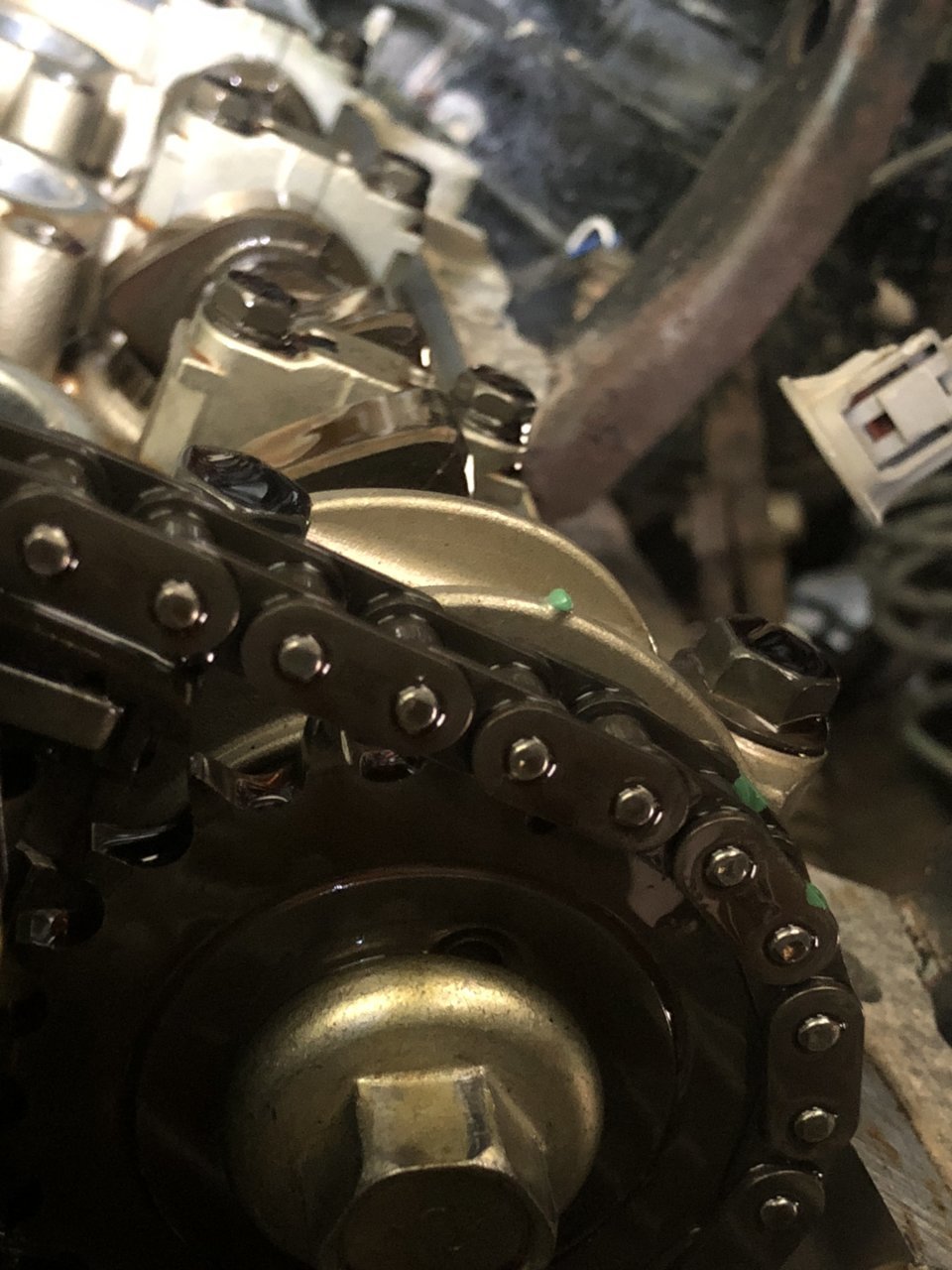

    Got it now how do I turn the motor? Can I just turn the cams? So I can get timing lined up?

    You have to use I think it's a 22mm socket to turn the crank clockwise, leverage is key, cheater bar.

    So are the marks on the chain important? Or so I need it to be at zero on the crankshaft and the dots lined up with the timing marks?

    So I have my timing mark at zero and both dots line up with the time mark I’m worried about the paint on the chain should I be?

    Never mind I think I got it I have to stop now anyways, but I have it a zero both dots lined up and pint on cam chain lined up too so I believe I am good but I will wait to hear cant start back until tomorrow anyways. I keep forgetting everyone is at work and I took the rest of the week off

    Sounds like you have it right. Crank at 0, timing marks lined up at the cams and the painted links should line up also. Takes a few rotations sometimes to get them all lined up.
