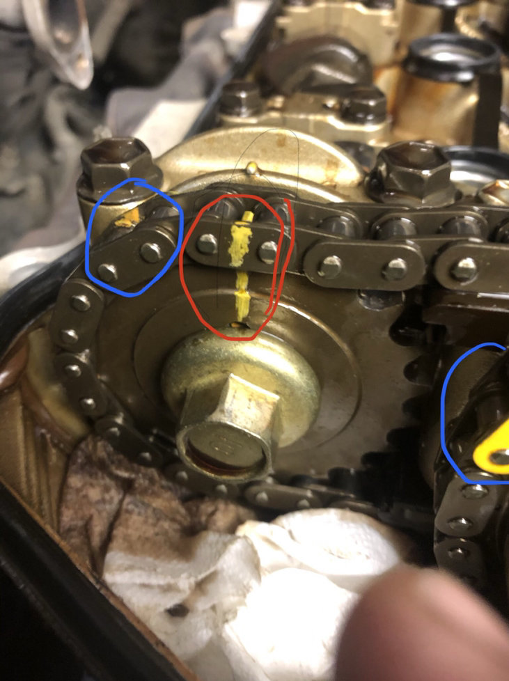

    E2855B82-EEC9-4BE3-AC24-B719F9F39522.jpg Don’t over think it. Line the slot and tooth up with the mark. You can see my OEM paint marks don’t line up to shit. I marked the chain where the tooth goes when the stock gear was lined up so I knew where it came from if anything moved. You would spend all day rolling the engine over trying to line all 3 up. Your not trying to time the engine and get everything lined up like you pulled it completely apart. It’s already timed. Your just pulling off the gear and putting a different one back on.

    Just to clarify. Once you line up #1 at TDC you do both banks correct? Not drivers side then have to rotate engine and line up passenger side?

    Line it up, do both banks.

    Ahhhh thank you for this sir! That’s what I was confused about and yeah I rolled her over and over and over and got the paint mined up on both sides now at 0. But I kept reading the URD instructions too and I felt like it needed TDC only so I was right but still got the marks lined up. This is exactly what was holding me up today. Tomorrow I guess I’ll use the ratchet strap method from a previous post to hold the wrench on the cam. How hard would you say it was to pop that cam bolt lose? I have a breaker to go over wrench.

    I
    used a 3’ chunk 2” tubing. First try I pulled steady until I couldn’t pull any harder. Second go around I wound up and took a half step back and about yarded my truck sideways across the shop. When it popped it sounded like a gun shot but it was finger tight. I actually thought I may have spun the wrench... to give you an idea of how tight.

    Wow holy ish you weren’t lying :rofl:when they popped I liked to crap my pants I can’t remember anything on my truck needing that kind of breaker phew but they’re popped hallelujah

    Crazy how tight they are isn't it? I think the engine running- tightens them down more over time. Hence I don't feel this particular nut needs to be torqued.

    Thanks everyone who helped me out gears in in shes back together and it started up no issues. Took it for a quick spin definitely feels different in mid range for sure.
