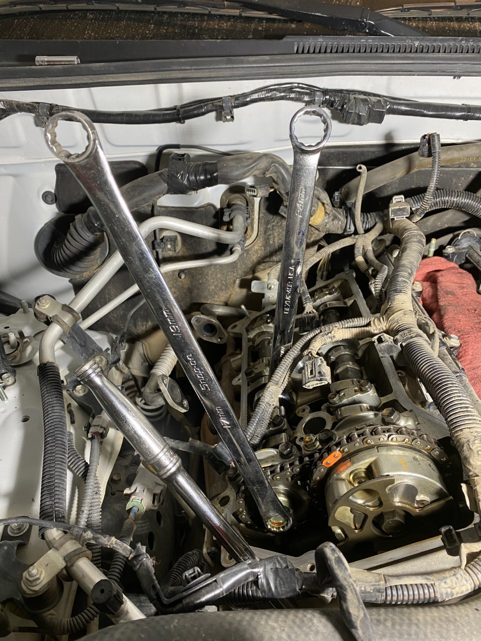

    Got down to the cam gears in about 2hrs. Broke the bolt loose pretty easily, but it got late. I’ll wrap it up tomorrow!

    Torspd Custom Turbo kit [] Borg Warner 9180EFR Turbo [] Haltech Elite 2500 [] TiAL Q BOV [] TiAL V44 Wastegate @ 15psi [] CP Pistons [] CP Carrillo Rods [] ARP Head studs [] ARP Main Studs [] ARP Header - Head Studs [] Ported Heads w/ 1mm oversized valves intake/exhaust [] Brian Crower Forged Stroker Crank [] Darton M.I.D. Sleeved Block [] Kelford Camshafts [] Torspd 160* T-stat mod [] APR Large Fuel Rail [] Walbro 460 LPH E85 Fuel Pump [] FueLab FPR [] APR T56 Conversion Kit [] KP RACING Built T56 [] McLeod Racing Custom Twin Disk Clutch [] One Piece Aluminum Driveshaft [] MGW Shifter [] Custom lowering kit [] Ohlins Front Coilovers [] QA1rear shocks [] Custom Ron Davis Radiator [] Dual SPAL Electric Fans []
    Same Snap-On wrench that I use as well. :thumbsup:

    I bought the 24mm open end wrench just for this job :cool:

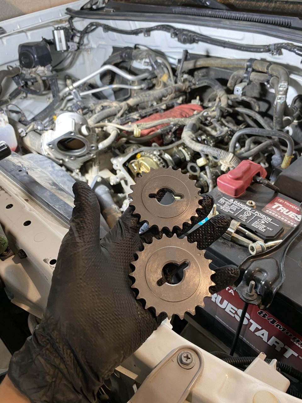

    Got mine in the mail yesterday, hope to find some time to install these this weekend.

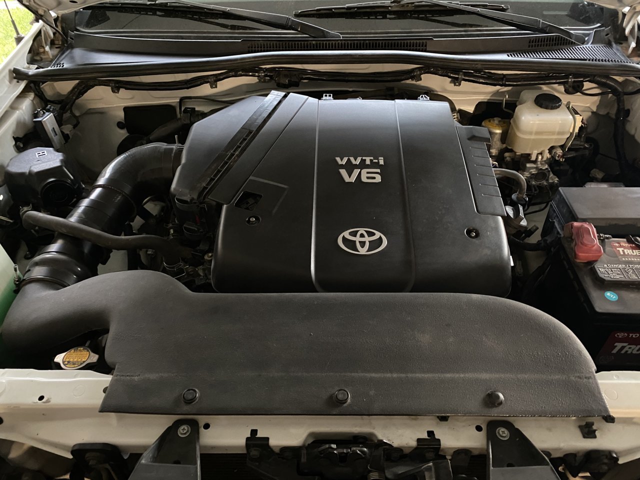

    All back together and running smooth. Air filter, maf, and throttle body cleaned; new spark plugs, valve cover gaskets, sai pump gaskets, and ecu cleared. Runs a lot better at idle and felt good on the test drive around the block. I’ll have a better feel on it Monday when I go to work.

    You’ve modded up the same air intake that I did a bunch of years ago. :thumbsup:

    I came across the design idea on TW for sure haha. My fenders are trimmed and I don’t like snorkels, so this was the next best option :cool:

    so a boxed 17mm is better than the MB offset wrench?
