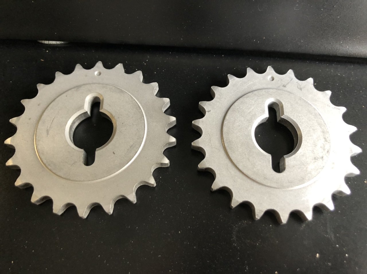

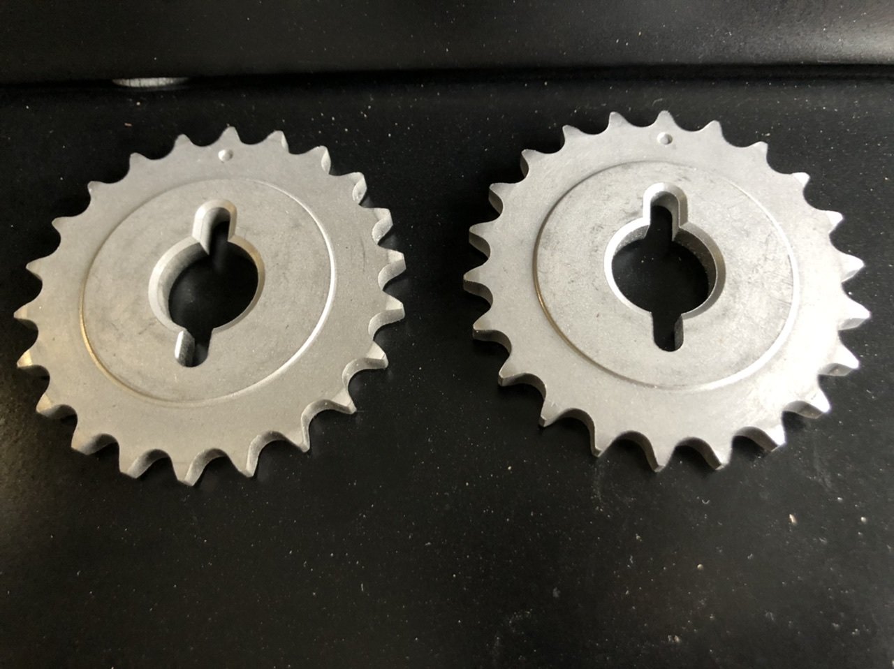

    Ok, I got the new gaskets in the mail today. I went to put the gears in the box so everything is together and for the life of me can’t tell the difference between sides. What’s the front and why? They look identical. 8FA38C93-CC16-417E-B252-A27927C536B2.jpg 725A00B3-75E0-46B1-926F-F1D8739C4671.jpg

    Your looking at them upside down

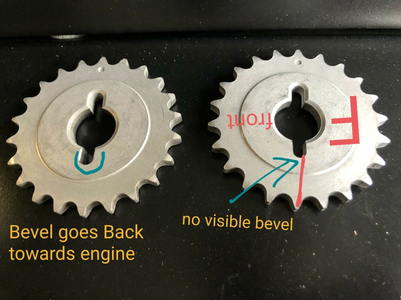

    Yours have the bevel on the keyway I machine.
    You will NOT be using the keyway with the dot on it. The bevel (slight angle on my machined keyway) goes towards the engine to aid with install

    I'm an idiot. I see now. THank you!! (I marked them before I forget again)
