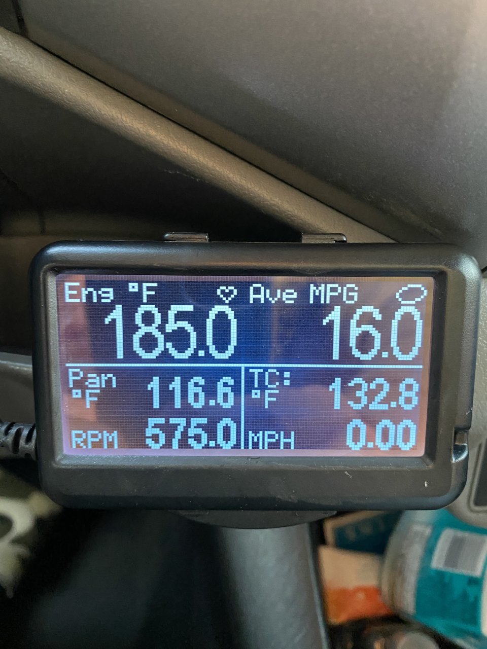

    1.8mpg increase is no joke! Glad to hear it man. Thanks for posting your results

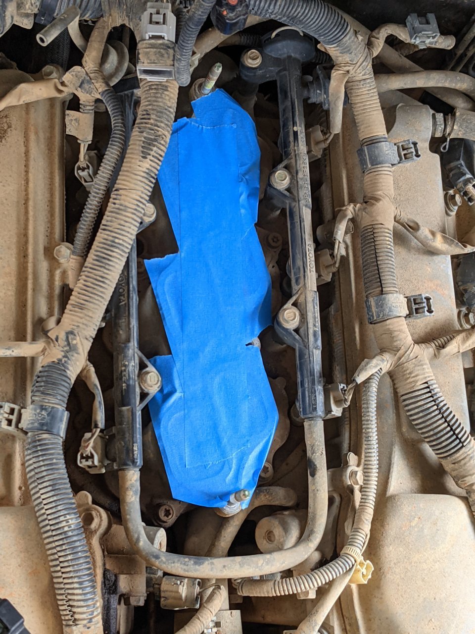

    I used tape and marked all my harnesses and lines. It was over kill, but I felt the same way initially. I did it solo, used some cargo straps to help hold some of the wrenches

    the worst part of this entire job is getting the hoses off the back of the intake bracket. Other than that it’s just staying organized.

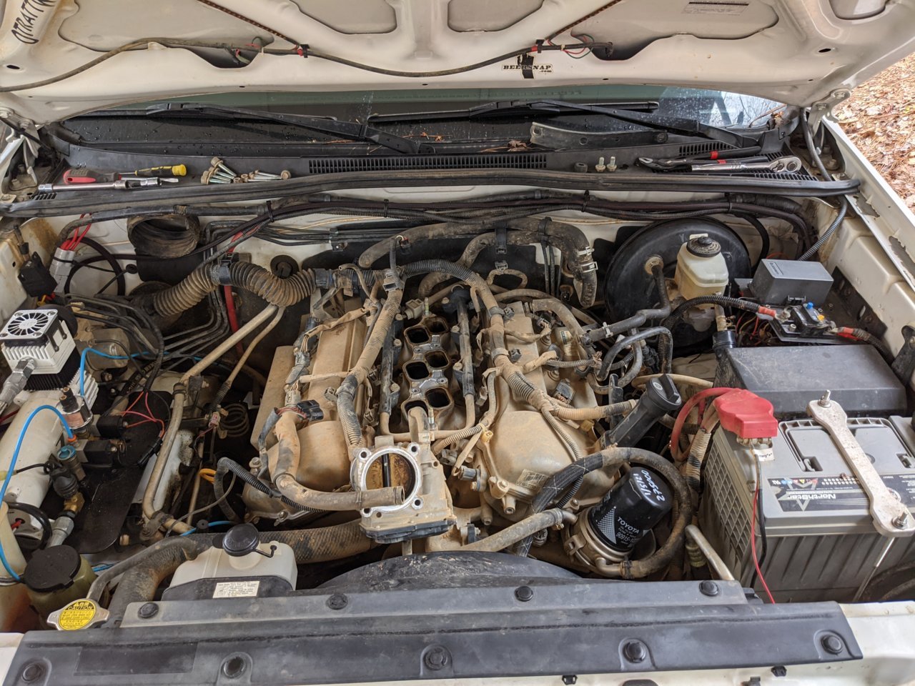

    Just scheduled a day with @greenEFSI for an install for these gears, I can’t wait!
    Question for the N/A crowd. Are most of you running with the stock intake box or have you upgraded to a different solution? I’m trying to see if I can help this engine breath once the gears are in.

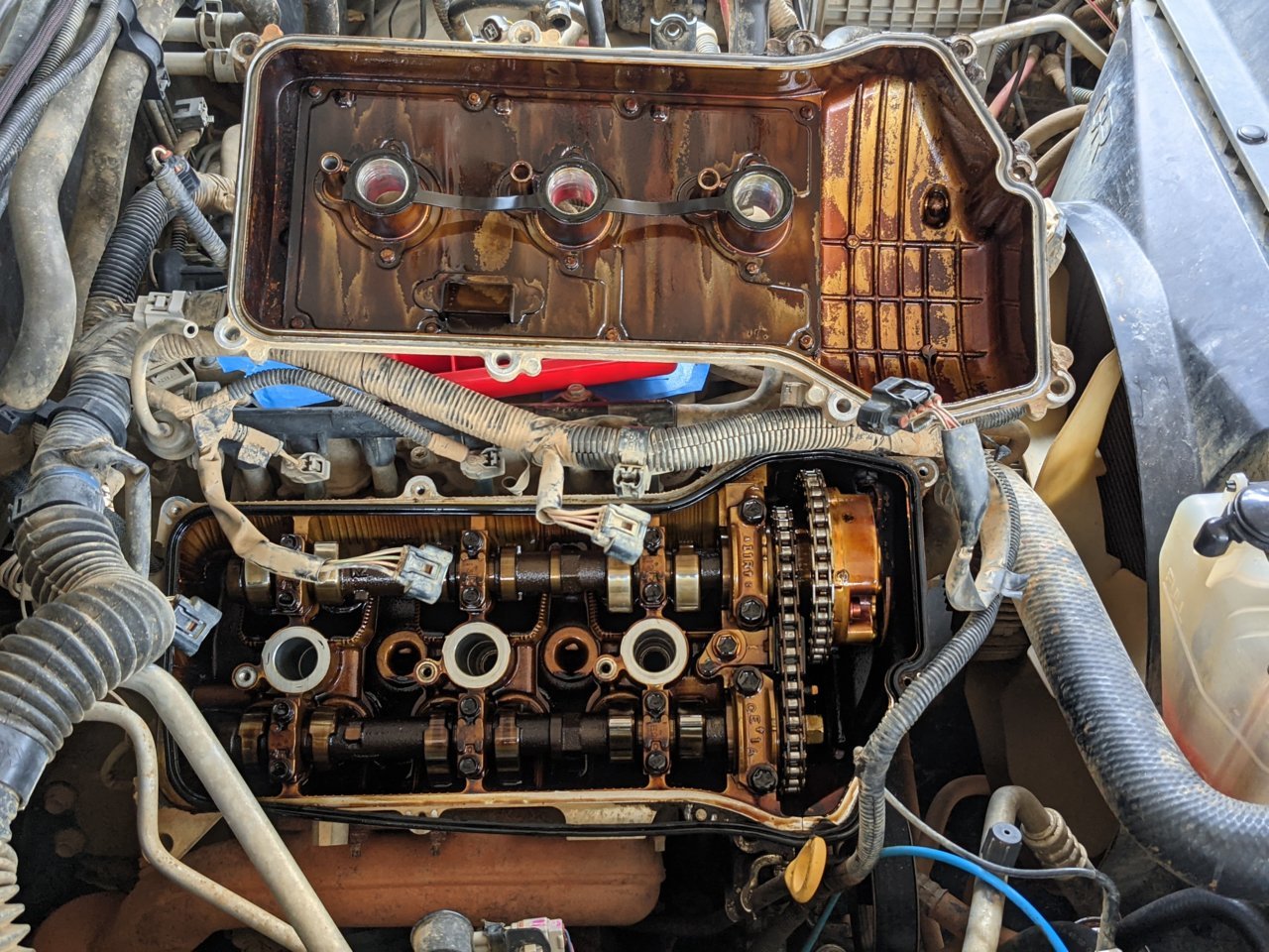

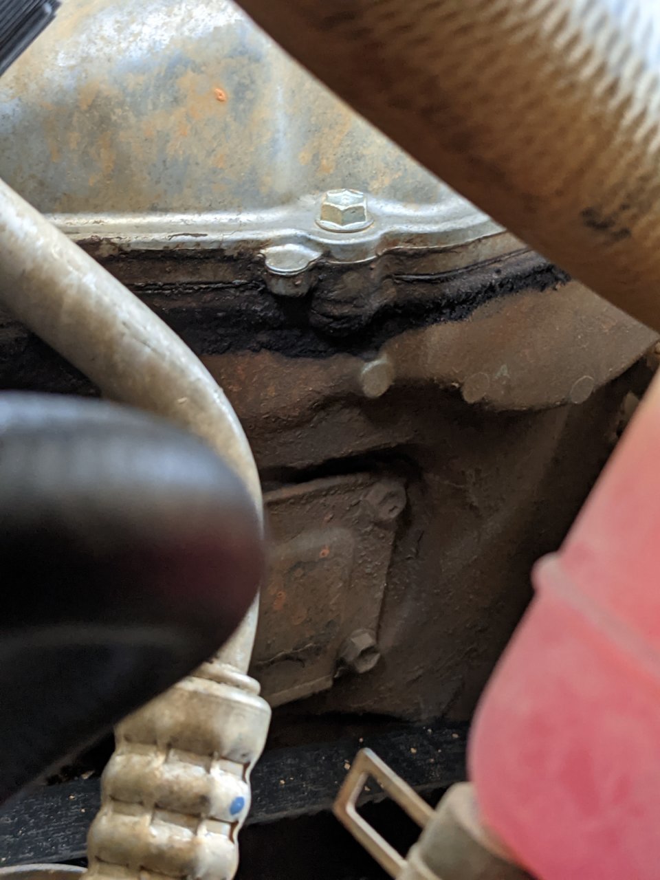

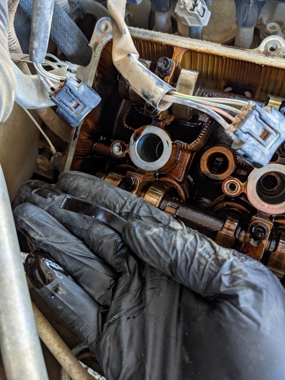

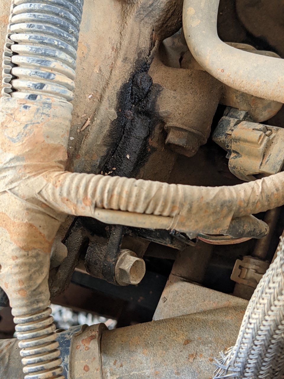

    Curious how the Gaskets had failed? My truck has 277,xxx miles and my valve cover gaskets are rock hard.
    I had originally thought my timing chain seep was coming from the valve cover/timing cover behind the power steering pump but after taking off the air chamber I see it's coming from the top side of the valve cover and running around the front of the timing cover.
    This job isn't that bad at all for anyone else nervous. The driverside has a lot more wires in the way.

    Haha Yea it's a mess. I've slacked on my air filter too and it was full of pine straw. I've never seen it that full. Plan to clean the MAF sensor too. My truck is gonna run like new once I do all this stuff :rofl:

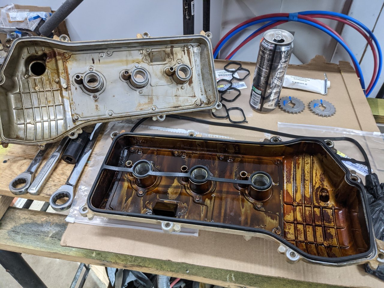

    Notice:
    If your gaskets are hard and break easy remember to find and account for all the pieces. I'm sitting inside warming up cleaning the valve covers and realized the first one I took off was missing the piece connecting to the sparkplug holes.

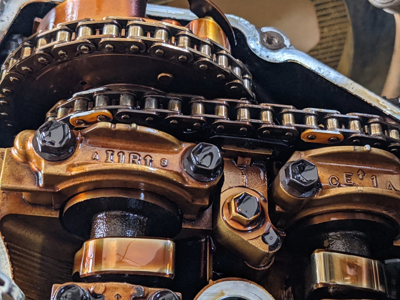

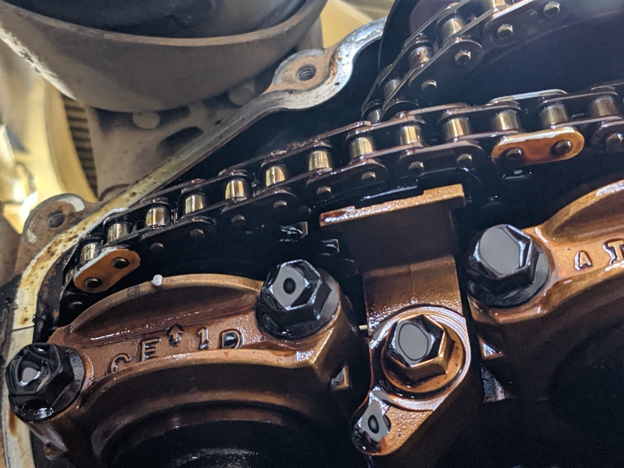

    I think I understand this, but I'm missing something or haven't turned the engine enough(maybe 20 revolutions or more).. Also which orange link on the back of the chain? I haven't gotten either to line up with the factory dot and the timing nub.
    ARoman83 likes this.

    '06 SR5 Off Road
    Yep, I understand the marks I'm looking for and have them marked with white paint marker. The Dot on the gear, the Nub on the cylinder, and the orange link on the back of the chain(there's 2 on each side). The URD instructions don't seem to mention the orange chain link.
    Another question, do both sides have to line up at the same time?

    Again, coming from someone who hasn't done this yet...
    Seems like the colored links take many engine turnovers to all line up correctly. Seems like the dots and cylinder marks are the most important.
    From what I've read, both sides should line up at the same time.
    Some people mentioned incorrect timing from the factory can happen too.
    I hope someone with more knowledge can jump in. Thought I'd try to help since I saw your post and it looks like you're in the thick of it.
    You might message @mightytacoman directly. Seems like he is very helpful.
