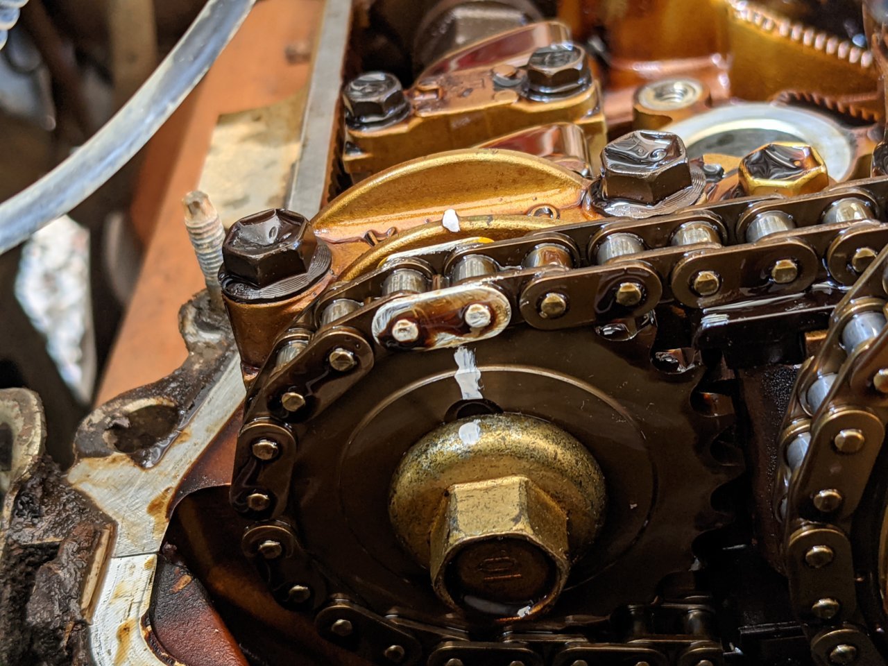

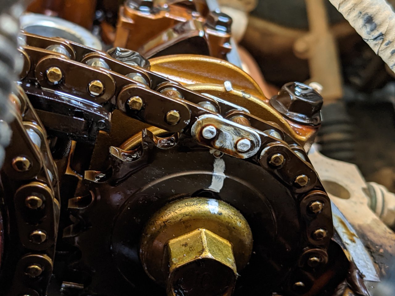

    Both sides should line up at the same time.
    Check out the video I posted on page 1. Don't worry about lining up the primary chain, just the two smaller secondary chains.

    I only lined up the two links with the gears!

    I'm 90% sure the crank pulley needs to rotate twice for the cam gear to rotate once. That means at 20 crank rotations- you might not quite be there to get your chains to line up @Sandman614
    remember they don't have to be lined up to do this- it just helps.

    Yep your 100% right. Watched the video and that's exactly what I was looking for. I'd bet tomorrow I need like 4 more crank rotations :annoyed:. It was just getting too cold to want to keep messing with it.
    I was wondering if we could just put both dots lined up with the cylinder marks and then install the gears. Not fully understanding the reason for lining the links up too I was just gonna do it. Didn't seem like it'd be that much more work and seemed like a better safe than sorry deal.

    Dont be silly and mark the chain, that moves independently. Keep it simple

    This is completely pointless. If your motor isn’t in the right position after a max of 2 crank revolutions then it wasn’t timed right to begin with and no matter how many times you turn it over will remedy that. The orange links are irrelevant for the cam gear installation

    Not completely irrelevant. They help those without a paint marker on hand for instance and it does give piece of mind to those diving into an engine for the 1st time that they reassembled correctly. You, myself and most gearheads don't need the marks but sometimes I'm helping guys over the phone with these who I wonder if they know how to change their oil.

    :notsure: I turned it and the the dots lined up with the cylinder nubs and the crank pulley is on zero, just no links. And now the links line up. So I don't see how it's not timed right...
    I was just trying to follow directions.
